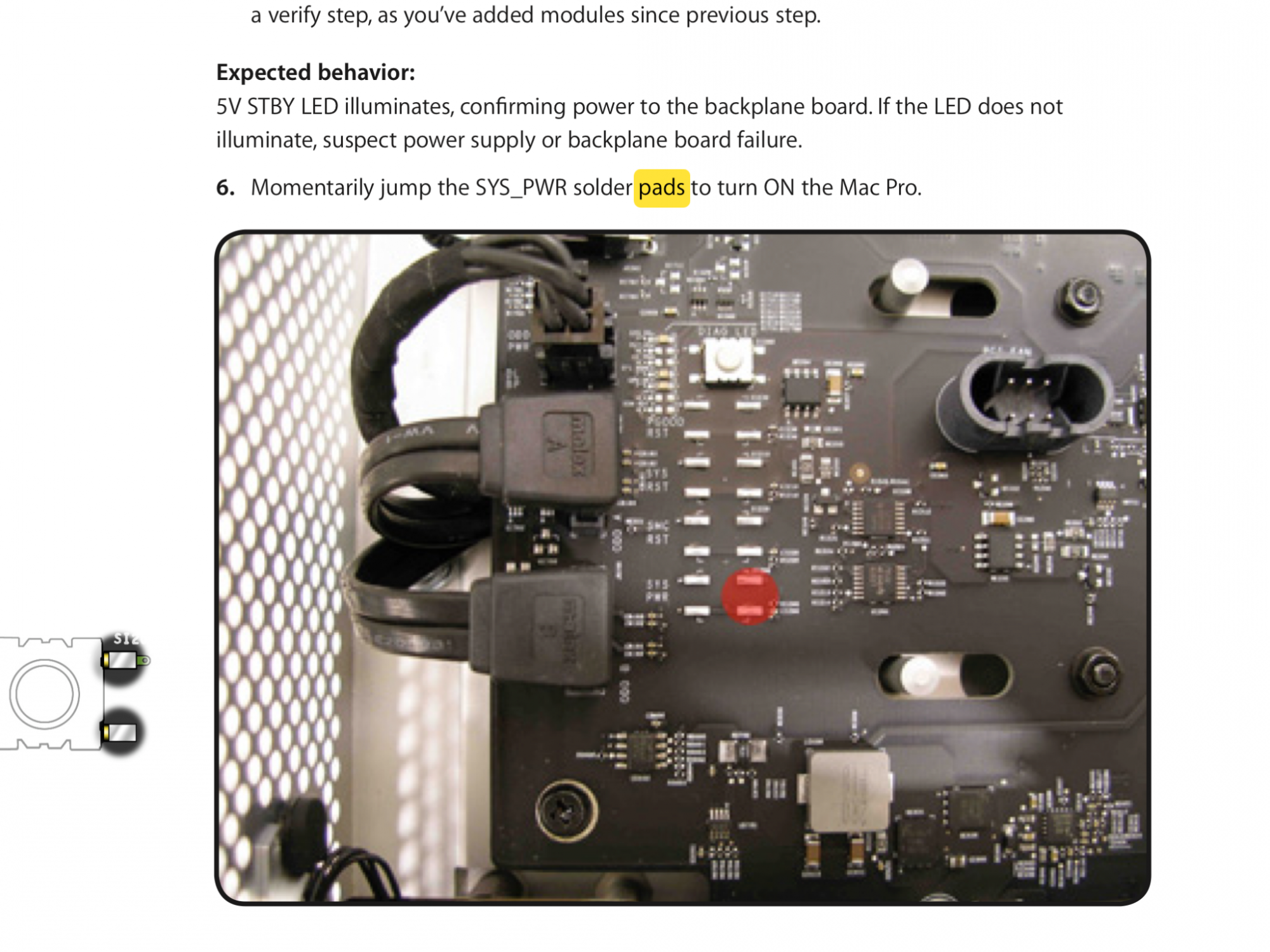

Z zcream macrumors member Original poster Sep 8, 2008 52 7 Nov 11, 2019 #26 How would I test a logic board by powering on outside the enclosure? The test button only gives a standby signal without the on switch. Is there another way to simulate the on switch?

Macschrauber macrumors 68040 Dec 27, 2015 3,114 1,570 Germany Nov 11, 2019 #27 There are 2 pads pon near the plug for the front board [automerge]1573504029[/automerge]
Z zcream macrumors member Original poster Sep 8, 2008 52 7 Nov 11, 2019 #29 Actually the red mark is incorrect. Its to the left of the red marker, where the sys_pwr label lies.
Macschrauber macrumors 68040 Dec 27, 2015 3,114 1,570 Germany Nov 16, 2019 #30 Its from Apple's technician guide. But resolution is not good enough to zoom in and check. It works, I jump started a few times. But cant remember the exact position, I just looked with strong glasses and good light.
