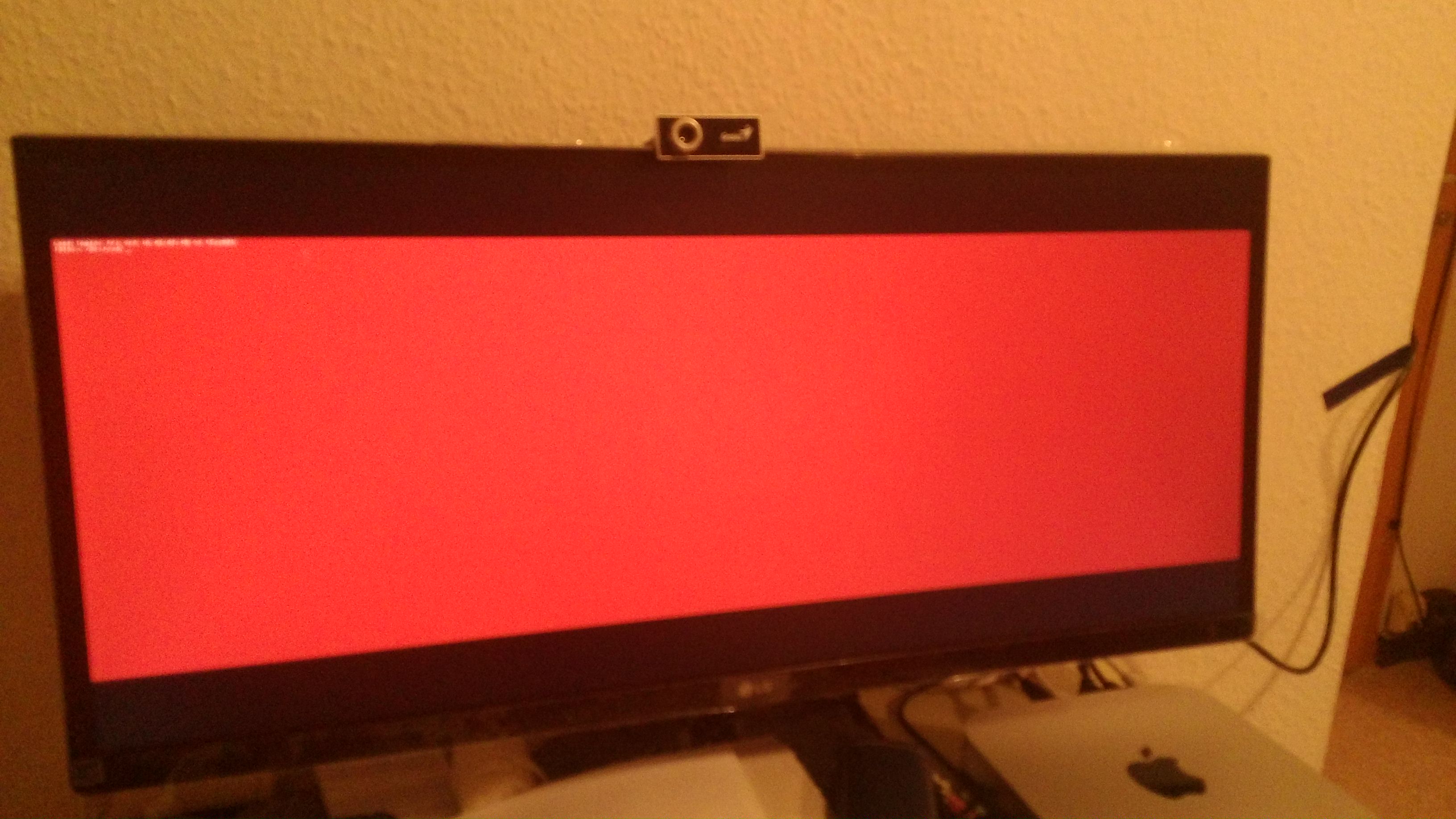

If my answer is not late:
I bought LG 29UM57 also
I used MDP > HDMI cable:
http://www.amazon.de/gp/product/B00Z9QE7OU?psc=1&redirect=true&ref_=oh_aui_detailpage_o02_s00
with custom resolution. How to set custom resolution you can see here:
And I got required resolution 2560x1080
But I have another problem: back lines in bottom and top in wide mode of ratio and black lines in all sides in original mode of ratio:
