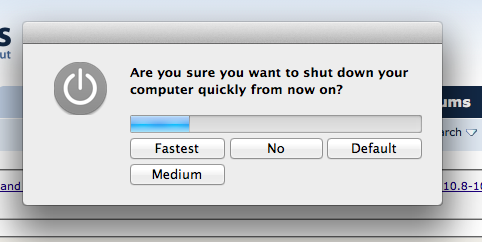

Mavericks Update
Hey Kyle,
I used your fix with mountain lion an my mba 2013 13" it was awesome and worked absolutely fine for me. thanks a lot for your great work
yesterday i updated officially to mavericks and the fast shutdown times are gone 🙁
the spinning wheel is back again.
i installed and de-installed your fix several times but it seems not to work.
can you please help me?
thank you very much,
Christoph
...i tried the new version but i hangs up although i wait real long 🙁

If you need to run it after you already did once, you need to first reset to defaults with the "default" button, then run it again. Same goes for if you want to select the medium option after already using an older version or the fast option visa versa, you do the same thing.
thanks kyle. i tried and it worked with the installation. but i don't get always fast shutdowns. with ml and your fix i got ALWAYS fast shutdowns. I don't no why?!
