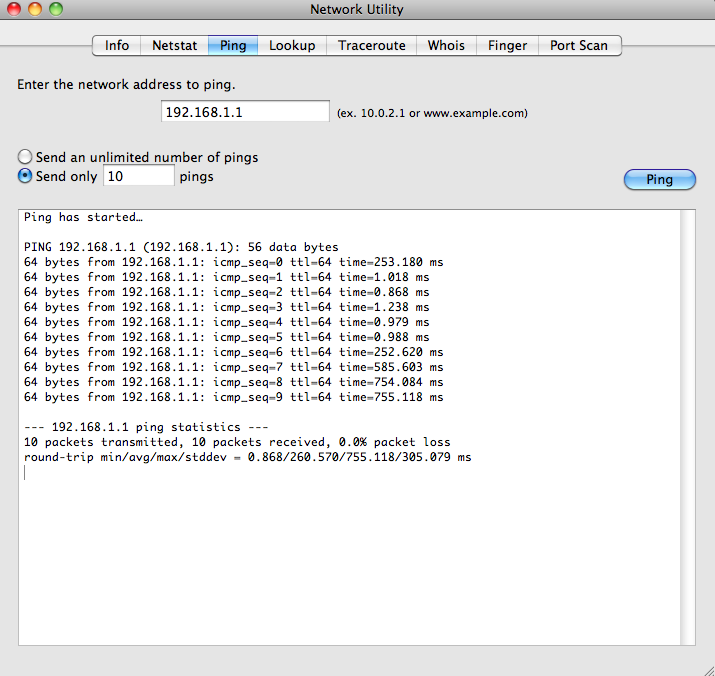

After upgrading to Snow Leopard (SR MBP), I've experienced unusually high and unpredictable latency from the airport connection. The Ethernet connection works fine (consistent and short ping times to the wireless router), but the airport connection's ping times vary wildly.
A different MBP (unibody) on Leopard does not have this problem with the same router (so it seems unlikely that the router is at fault), and I did not have this problem before my upgrading.
Programs such as Skype that require a steady stream of information are now unusable.

Problem does not appear through an ethernet connection, however, it persists in different users, including the guest user, when using the wireless. My computer is less than a meter from the router, so distance is unlikely to be a problem. The same command on a different mac across the room generates consistent 2-4 ms response times on the wireless network. Thanks for the suggestions, but so far, no luck.

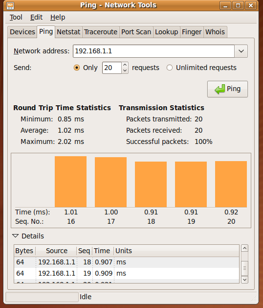

Interesting news: using a live cd of ubuntu (9.04), all is well in the network latency department using the built-in airport wireless:
Nothing more than about 2 ms delay with the same hardware setup and the same router when using Linux. Still ranging between .8 and 2000 ms in 10.6: something strange seems to be occurring.

So, I reinstalled SL in place, without any success. Oddly, after connecting to the wireless from the installation DVD, network utility was able to successfully ping the router without delay. After installing, however, the issue remained the same. Since I don't seem to be able to move backwards with my existing time machine (having upgraded), what options to I have? Would a full wipe be significantly different than the archive and install that I just did, considering that the issues appear on all user profiles, including a Guest user? I just don't see it making a significant difference, unless my understanding of the archive/install process is wrong.
