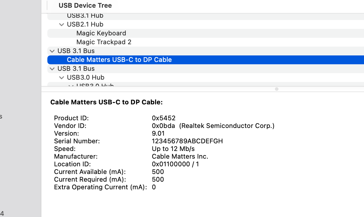

I use a BenQ DP2700U monitor using its DP input with the following:
