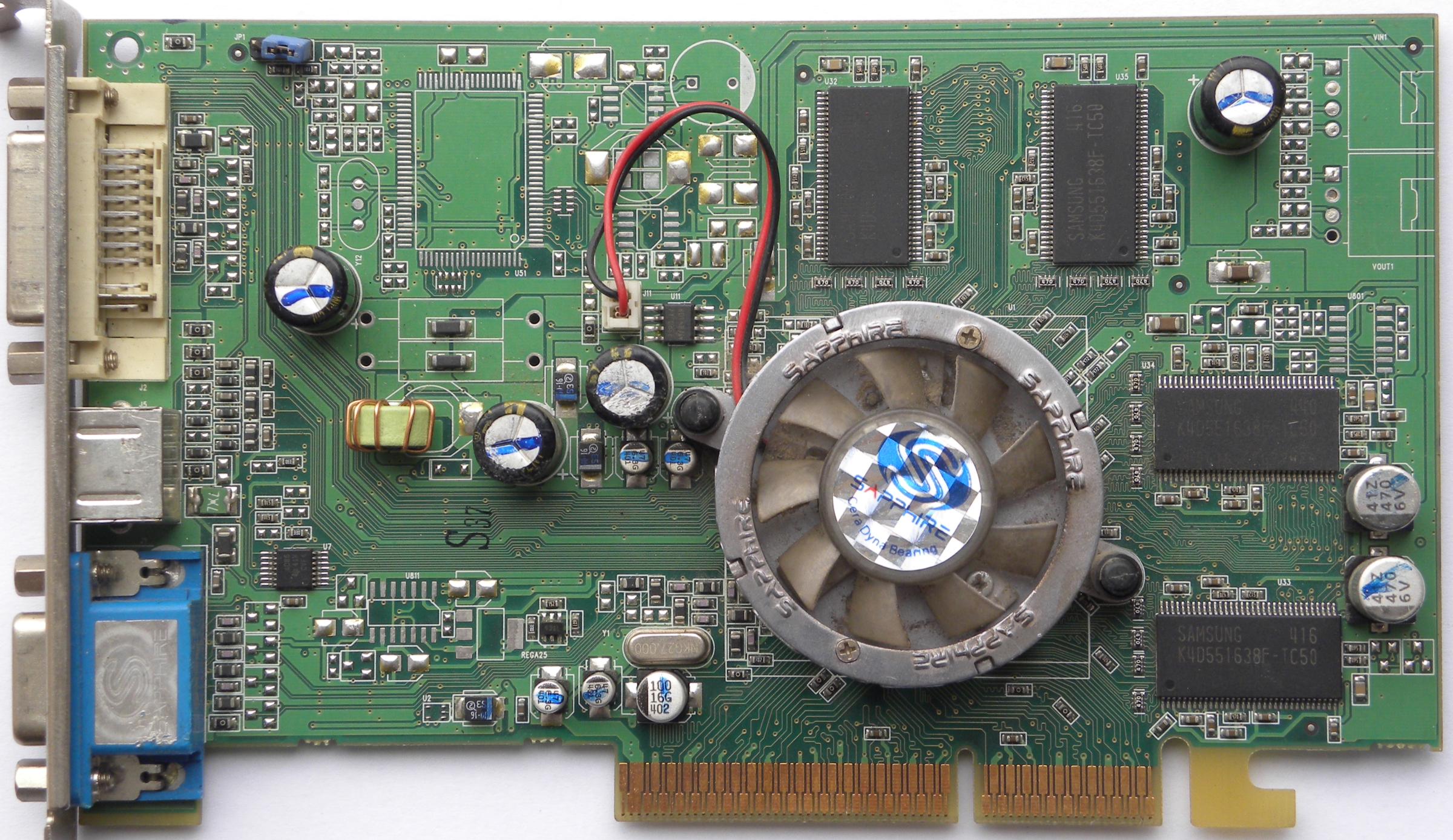

I pulled one of these from the carcass of a dead PC.
Could this be flashed to work with a QuickSilver? I've read elsewhere that someone had success using this card without flashing. If tried to test this for myself, would there be any risk of damage to the G4?
Ok, this was a really bad idea. It refused to boot with the 9550 installed and now that I've replaced the original card, there is no signal via VGA. I've pressed the PMU button on the logic board twice and held down CMD, Option, P and R but no joy.
Has my QS been wrecked? Help please. 🙁
Edit: I managed to resolve it and restore the computer to working order.
There's an extra edge connector beside the AGP port which the 9550 card lacks and there's no details within that page or the associated links that contain any info about getting it to work on a G4.

That's the ADC power slot, I believe. All not having it means is that the card won't be able to drive an ADC display. Of course, being a PC card, not having the actual ADC port helps too.

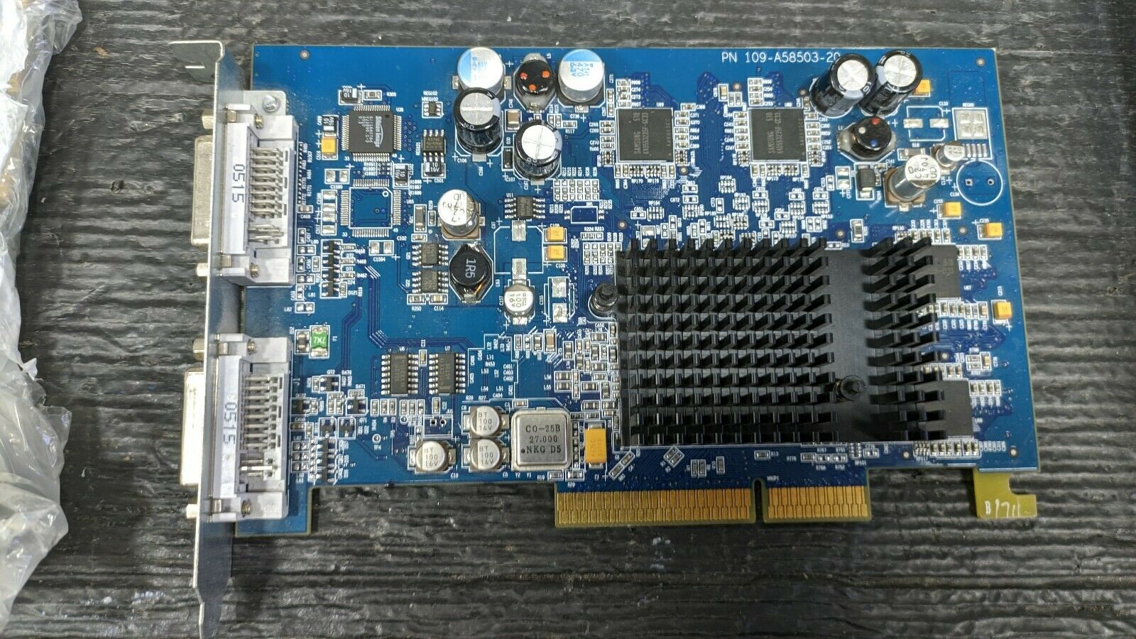

The Radeon 9600 is also a good option. They’re cheaper than 9800s. And the G5 variants can be made to fit in a G4. They needed the pins taped off, and the little latch on the end of the card needs cut off. After that, it fits and performs well. It’s a massive upgrade over a Radeon 9000 Pro IMO. Core Image support makes a big difference in Leopard.
The stock 9600 from the first gen G5s didn't need anything other than its pins taped to work in my MDD. No cutting required.
I've found what appears to be a 9600 for the early G5s. If I buy this, I only need to tape pins 3 and 11 for it to work in the QS?
To my experience, yes. The QS should not be very different from the MDD as far as graphics systems extend.
I believe this same card ran in my Power Mac GE with pins masked, so it should work in a QS.
All the flashing/getting it to work information IS indeed in the links. Here's the direct route:
I was able to successfully run a flashed ATI9800 All-In Wonder in my G4 after using the procedures from MacElite, my last (and probably the most powerful anyway) AGP card.

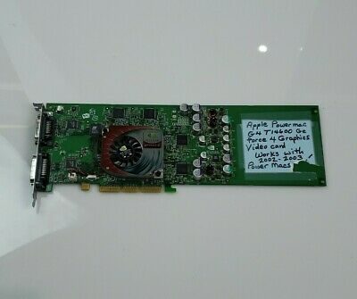

IIRC the very best OS9 card is the GeForce 4 titanium 4600.
Man, what a surfboard! 😛
That PCB is a lot longer than it "needs" to be. That's cheating. 😛
Between the shipping to the UK and the import taxes this will be a tidy sum but I've seen the PC version of that card being sold for even more so I'll have to shut my eyes and hand over the money if it means I'll get an improvement over the MX. If this will give me good results in 9.2.2 and OS X then I'll buy it today. The MX is just too horrible. 😧
