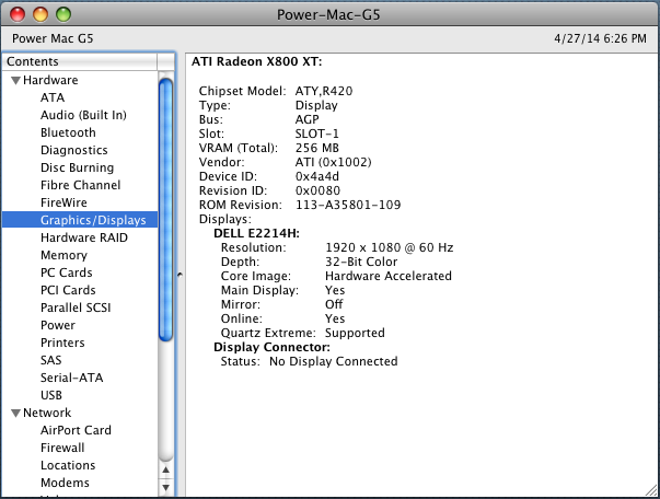

Try with this BIOS. Compare Device IDs, edit if necessary and flash.
This is BIOS dumped form my flashed ATI FireGL X3 256MB, at the moment in G5 from signature as ATI X800XT.

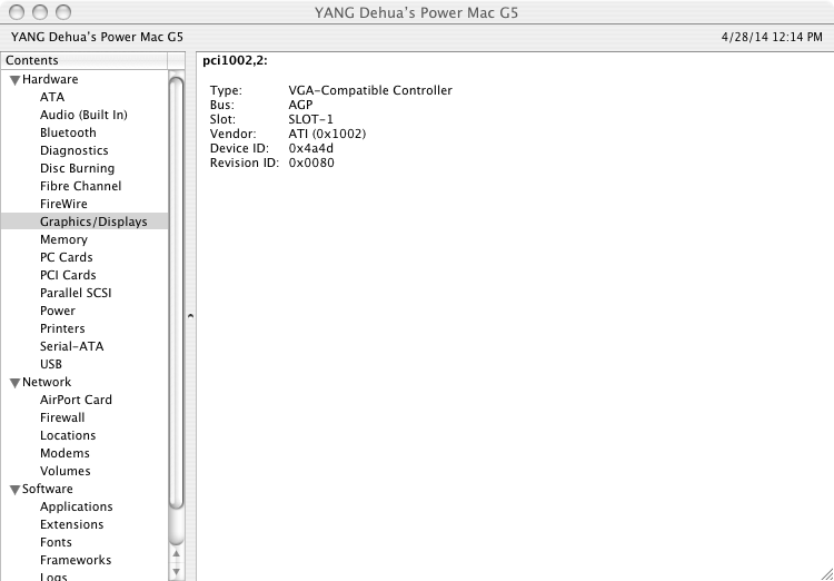

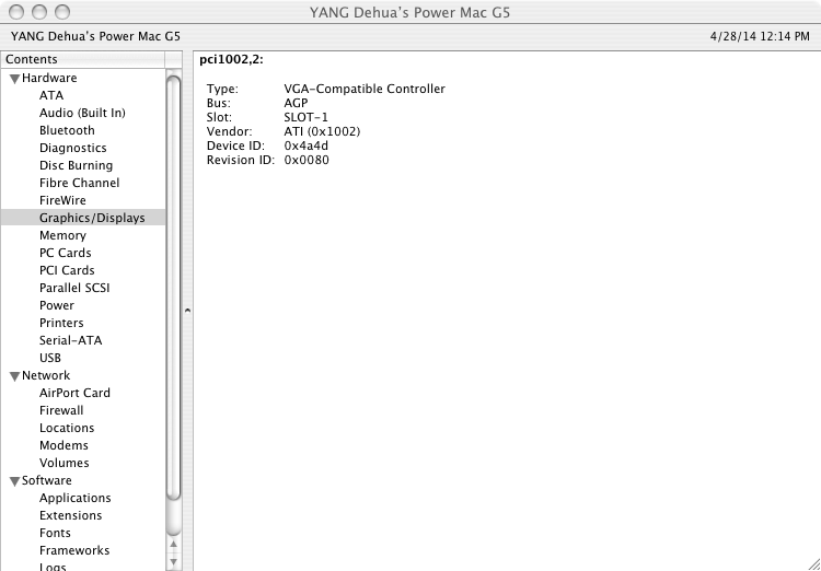

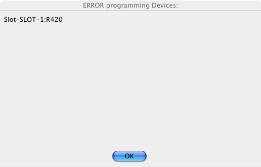

Thank you very much for four help. I just tried but couldn't make it. I use my G5 running Tiger 10.4.11 and follow the procedures:
1). Plugin the FireGL X3 256 card in APG slot, connect power supply and monitor. Switch on the G5.
2). Use VNC viewer from a PC to connect the OSX remote desktop. The card recognized as VGA compatible card.(see attach.)

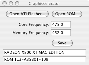

3). Open Graphiccelerator, select ATI multi flasher and your rom downloaded above, and save. It said "OK".

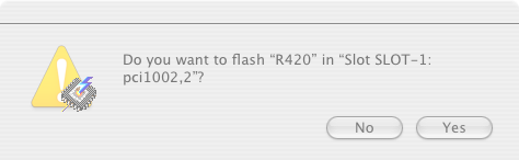

4). Go to ATI tools folder, run "run me first", then launch ATI multi flasher. A confirmation window appeared, and I pressed "Yes".(see attach.)
5). A window prompted and disappeared so quickly that I couldn't catch what message on it, then another window appeared showing "Error Programming Devices".(see attch.)
I tried also in safe boot, using SSH to start Tiger's VNC server for VNC viewer. The same results as before.
What's wrong with my doings?

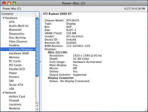

Success!
Finally I succeeded in the flashing! My processes are somewhat weird: flashing in a PC or in A Mac didn't work for me. I tried in a PC running PCDOS 7.10 many time using various versions of ATI flashers and roms, but all my effort was in vein and went nowhere. Some flashers(more recent ones) did report flashing success but the card simply won't work on Mac. I also found the 64K rom file couldn't be written into the card fully because the dumped file was only 32K after successful flashing! So I tried the followings using both PC and Mac, that did the trick:
1). Flash the card in a PC with bax2003's rom above in the thread.
2). Plug in the Mac G5(it won't work of course)
3). Power on the Mac and use VNC to access it.
4). Use Graphiccelerator to load the flasher and rom. When the card holds PC rom it can not be flashed as my previous posts. It holds broken Mac rom this time.
5). Run the ATI multi flasher, a confirmation window prompts up showing some differences in SSID and PINS between card and intended rom.
6). Press "Yes", a progress bar appears and finishes successfully.
7). Restart the G5. The Apple logo screen shows up and it boots to black-white screen image with some artifacts.
8). Install necessary ATI drivers and tools. It works like a charm.(oh, wait, temp is not sensed)
The procedures above work for me at least, may be they are also viable for others.
