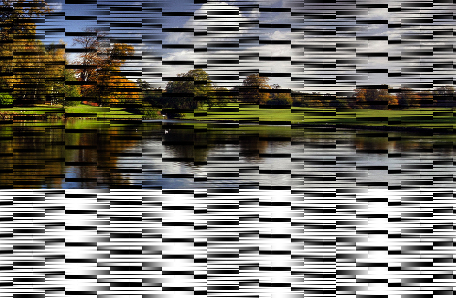

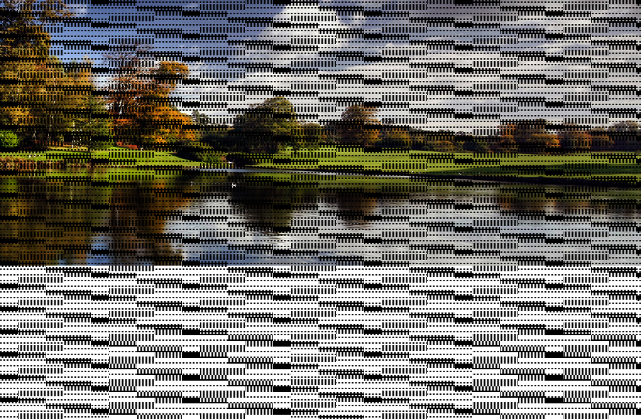

Once in a while i turn on my computer and the screen is sort of scrambled (see picture attached).
Does anyone know why this happens? It only started happening with the ATI card and it only happens a couple of times a week. I usually have to restart or, if that doesn't work, physically remove the card and put it back. It does this WITH and WITHOUT overclocking through ATIccelerator.
Thanks.

Probably what happened to my 9800 Pro. Needs more/better thermal paste for a better contact with the heat sink. But it looks like it's probably from over heating. Better hope it's not permanent.
Hmmm... you think? It doesn't happen when it's been working for a long time...both times it happened right after i turned it on.
I already installed the zalman fan with heat sinks on the memory chips (on one side because the other has a metal panel covering them).
I used most of the thermal paste that came with the zalman fan. Either i get a bigger amount of it or i install another fan close to the graphics card.
Maybe i used too much thermal paste... i found this on wikipedia:
"It is always important not to apply too much metal thermal paste to the CPU/GPU as excessive amount of applied thermal grease can act as a thermal isolator, and thereby lowering the capacities of cooling power."
Too much paste isn't a good thing either. It just creates better contact between the processor and heat sink so it can transfer the heat away from the processor more efficiently.
Thermal Paste is just designed to make the surface flat, filling in any tiny scratches etc, not a paste.
Artifacts started showing up so I decided to re-apply the thermal paste since I read in the Zalman website that about half of the tube they supply with the fan is enough. When I first installed the fan I hadn't read this and had used about 80% of the supplied thermal paste. I suspected this is why artifcats were showing up on screen so I took the fan apart from the card, cleaned the thermal paste and re-applied what little thermal paste I still had left.
I also installed 4 heat sinks i had left over on the bottom side of the card. I hadn't installed these the first time because there is a copper plate covering the bottom side of the memory chips on my card so i assumed it wasn't necessary. This time I applied them anyway, glued onto the copper plate.
Hopefully the thiner layer of thermal paste and a total of 8 heat sinks (my card only has 4 memory chips so I know have these on both sides) would make the cooling easier.
No artifacts have been showing up since this so I assume the card was acting funny because it had too much thermal paste and perhaps too few heatsinks.

I was able to re-flash the card using "voiceover" which makes the computer read aloud what is showing up on screen, so i wasn't tottaly "blind" while doing it. It has been working since then but sometimes i get many artifacts on screen and have to re-boot or physically remove the card and re-install it. Other than this problem it works fine.
I didn't tape any pins on the card but i have a G5. I did read in several places online that to have the card work properly on a G4 you do need to tape some pins.
Sounds like a heat issue. Does the video card still have the factory heatsink/fan? They tend to crap out over time. Try removing it and cleaning off the older thermal paste. Apply new paste and go through a few hot/cold cycles. See if the artifacts go away then.
