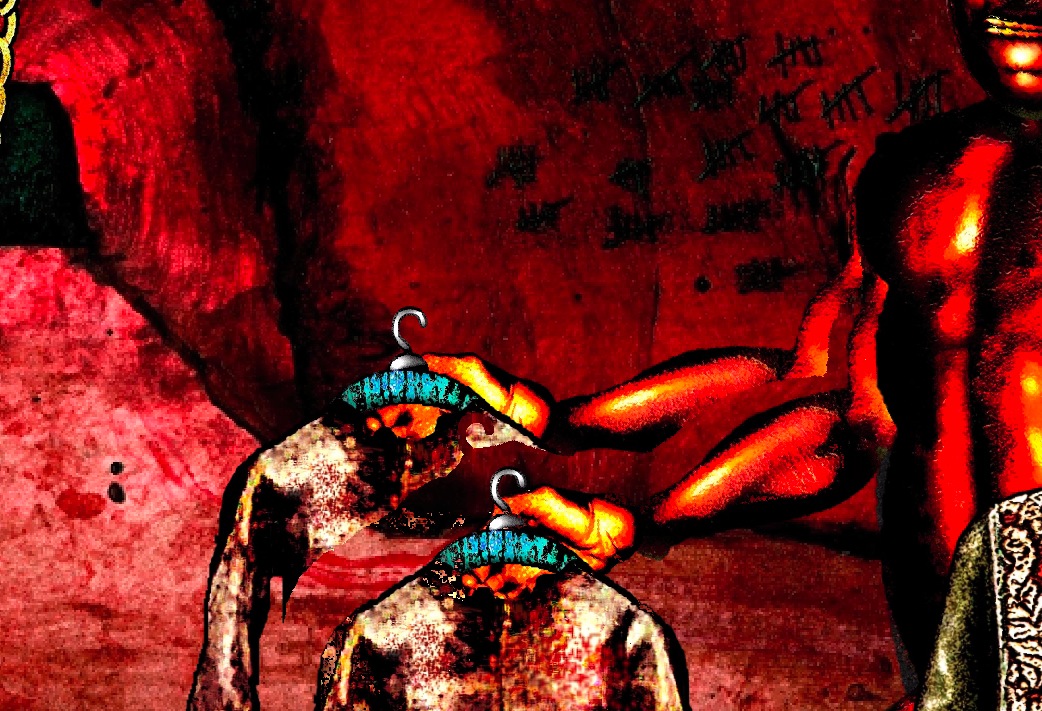

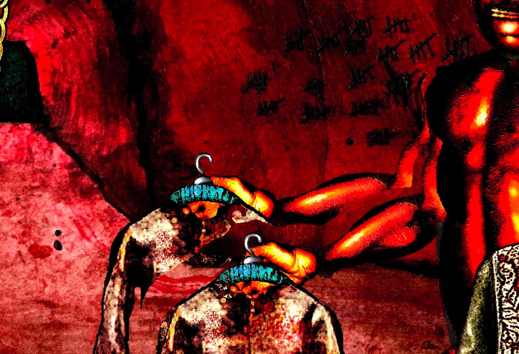

Any help on this much appreciated. I've attached a picture of the type of stuttered effect I'm getting.
