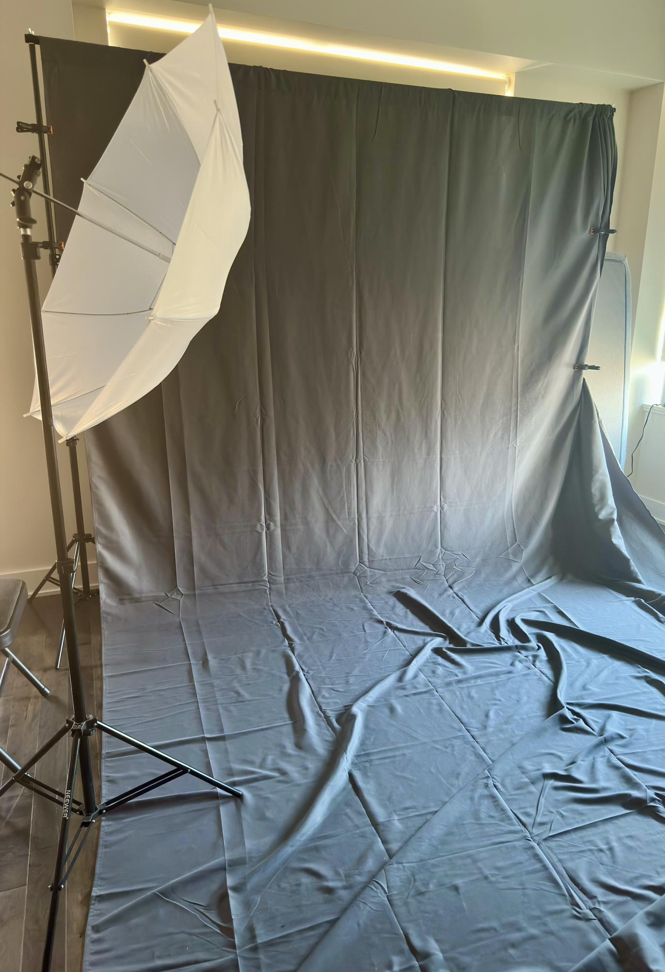

My partner is pregnant and I wanted to do some nice full body portraits etc. I have a tripod with an umbrella (see pic) and the flash I used was Nikon SB700. My camera is D750 and lens is 85mm 1.8 (nightmare in this tiny room but manageable).
I have remote shutters so the Flash is in front of the umbrella and I've tried various positions but I didn't manage to take a decent picture. I've also noticed that high speed sync (shutter above 1/200 doesn't work with these remote triggers and only works when its hot shoed on the camera). We were doing it in the evening so no light from the window. To add salt to the injury, later my partner took some photos with my iPhone 14 Pro and those were 100x better than what I managed to pull off.

So I think you can most likely get your umbrella to work for a full body portrait, but it's going to depend on what style of image you want to end up with. Also, buying a $35 large reflector would be helpful and cost effective for full body portraits.

You mean away from the model? Should I use the silver umbrella then as its more reflective? (yeah, I will iron it too, this was just to test things ) 🙂
Yes. I would try the silver umbrella as well but it will give you much harsher light.
