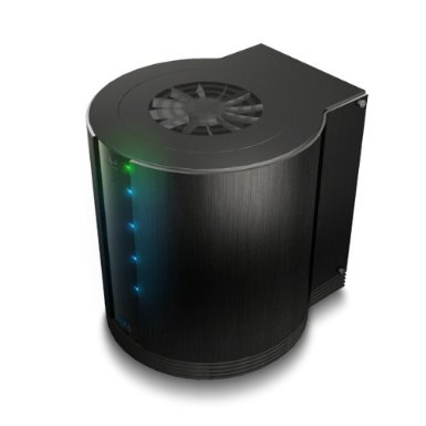

I think the basic intention of the internal flash drive is for booting, installing apps, and maybe storing music and some iPhoto libraries but not for editing or capturing video. Assuming HD 1080P formats I think the ideal way to use the MP6,1 is to designate the internal SSD as a VM scratch (besides boot and apps) and then connect a USB3 enclosure with three or four 5.25 bays. In one of the bays place the DVD or BRD burner and in the rest set up a RAID0 using something like Seagate's 3TB or 4TB drives. USB3 will support the full speed of a 2-drive RAID0 using any rotational drives currently on the market (380 to 420MB/s sustained).
If you intend to edit 10bit 4:4:4 HD 1080p you will need a faster solution tho. In that case I would probably build my own enclosure using two of the USB3 ports with three 1TB Seagates or similar drives on each adaptor. But a DIY case like that is a bit of a project. Alternatively you could get three of these at $60 ea. for about 1 to 1.1GB/s or two of these:
and realistically expect to get the 850 to 900MB/s using the same 1TB drives at like $65 ea - three in each 4-bay enclosure. If you used the two 4-bay dudes (with 3drives in each) that would be like $550 and if you went with the three 2-bay guys that would also be about the same - tho faster and using up an extra USB3 port (leaving only one USB3 port left open).
To get the same basic thing (6-drives) with the same speed (1.1GB/s max sustained) via thunderbolt you would have to spend about $1,500 - if you shopped around for the very best deals.
You need about 800MB/s (minimum) in order to smoothly edit or composite 10bit 4:4:4 uncompressed HD 1080p. If you intend to edit 2K or 4K video I think you need to use SSDs. I guess you would need three in a RAID0 array. The SSDs near to 1TB in size start at around $800 and the TB enclosure to connect 3 of them is about $600 to start. So for 2K or 4K editing you're looking at using one TB2 connection and spending about $3,000 Or go with three 512GB SSDs and spend about $2,000 in total. 😛

Ya, just search for the cheapest thing. You don't need or care if it has RAID internally so that will help you sort to the cheaper units. OS X software RAID is fine - even somewhat better IMO.
Myself, I would probably get an old PC case for $15 or $20 and buzz-saw the back half off, place the PSU under the drive cage and then bondo just the back-plate back on. From there I would search around for some splitter backplanes USB3 --> SATA bla bla, and like that - you get the idea. I guess after everything it'd probably cost me around $80 to $100 and give me two 5.25 ODD bays plus four to six 3.5 HDD bays. I would hope to run two USB3 cables from the Mac into the custom enclosure.
But again you can find these already made for between $120 and $200 fairly easily. The main advantage of the DIY project would be a high grade 250 to 400W PSU - hopefully included with the case (off ebay for you and from the storage pile in my garage for me) and the active cooling slash ventilation.
