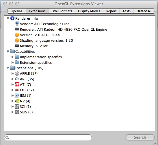

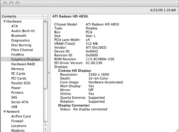

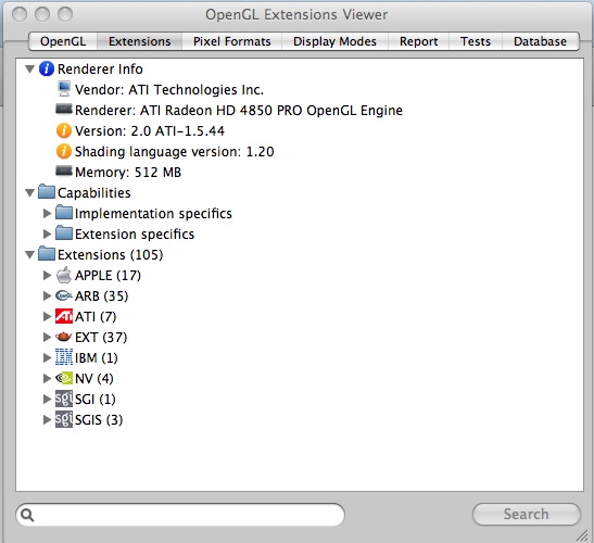

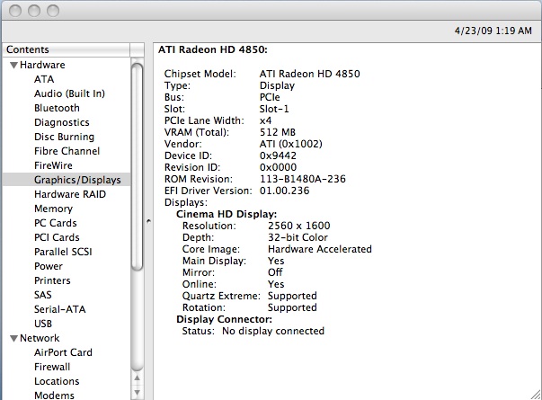

Partial Success !!!
With an EFI ROM from Pipolomo42's method, and Netkas' new Natit & ATI fix...I finally have a working 4850 !!!
Sadly, it still needs the DVI to VGA adapter...but now CI and QE are working.
And it's OpenGL viewer scores tell the tale of a powerful card.
(Beats the 4870x2 with current state of affairs)
Getting closer.
(There is an odd Mouse stutter too)
