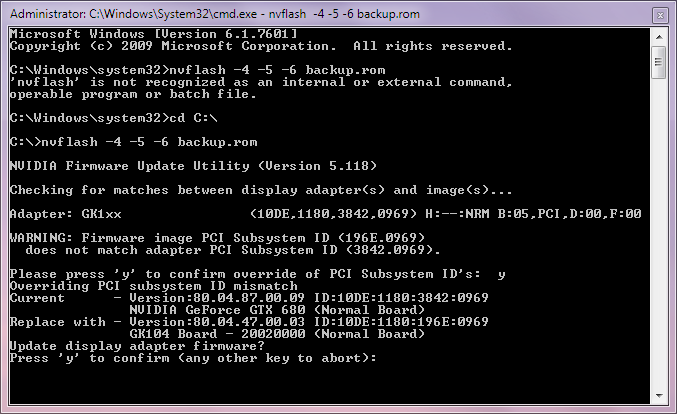

OK - I've done the firmware flash - the only difference I had was that I had to press Y a couple of times to confirm that I wanted to overwrite - but I now have boot screens and a PCI Cards tab that displays 5.0GT/s.

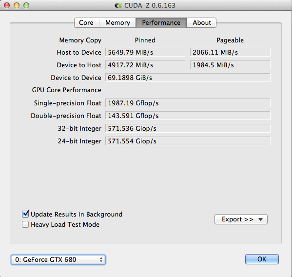

I noticed that you were running CUDA-Z v0.6 and I had d/l v0.7 - I grabbed the same v0.6 as yourself and got it running - however I notice that my memory section appear to show a much lower set of memory copy numbers that your screen shot (I'm running a Mac Pro 3,1 if that makes any odds). Any ideas why this may be?

Sorry, nothing concrete about the memory copy data.
However, my Mac Pro is a 4,1/5,1 Hybrid. The memory controller is supposed to be significantly improved over the earlier variants. Maybe that's what you're seeing?

When you flashed to the evga rom did you get any messages asking you to press Y to confirm as there were board differences (i think that was the message)?
I don't remember, sorry. It wouldn't have surprised me had such a message appeared, though.

Quick update:
I just did a dry run with nvflash and can confirm that there are 2 dialogs that require a "y" response.

Quick update:
Thanks for the confirmation, Cal6n.

Just need to find out about the memory copy differences between your set-up and mine now 🙂
