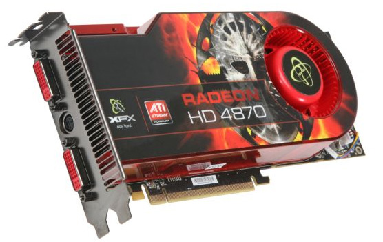

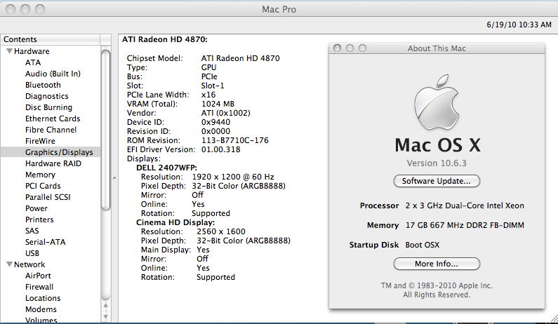

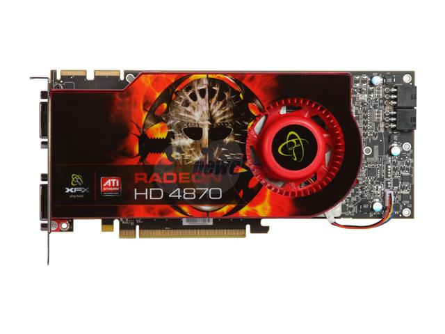

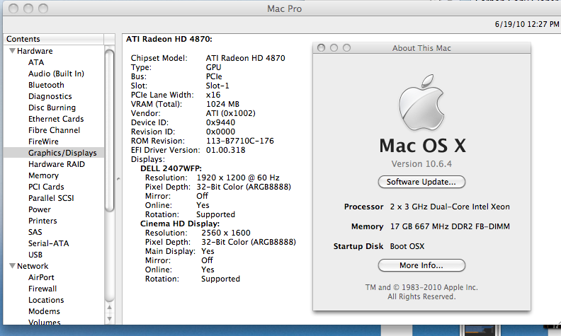

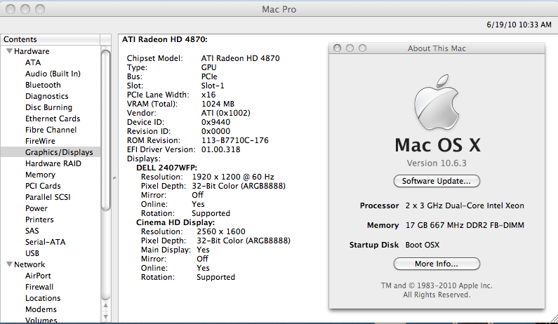

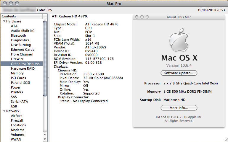

I would like to create this thread to showcase the flashed GPUs which have been updated to 10.6.3 and 10.6.4 with NO ADDITIONAL HACKING OR PATCHING needed. I am starting with the card I have long advocated, the XFX 4870 1 Gig cards that came BEFORE the ZWxx series. There were at least 4 different cards, but all either used the EXACT reference fan of 4870, or a slightly slimmed down version. I just tested it in 10.6.3 and both single and Dual Display DVI work without a hitch. I am downloading the 10.6.4 Combo update and will edit this post to report results but I expect it to still be A-OK.
Who has a flashed 4870 512 Meg using reference fan? I am willing to wager $10 that those are all A-OK as well.
To be clear, I am hopeful that people running flashed GPUs of any sort that have updated to 10.6.3/4 WITHOUT any scripts or patches that still work exactly as before will report here. Please include pix of card and System Profiler. Please report whether you tested with Dual DVI or if you have just 1 display.

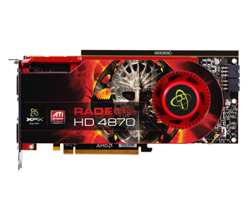

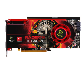

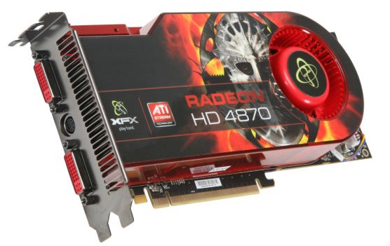

I have included pix of both styles of XFX 4870 1 Gig cards that have been A-OK since 10.5.7. These were only 1 Gig cards that had Dual DVI pre-SL and have remained hassle free since.

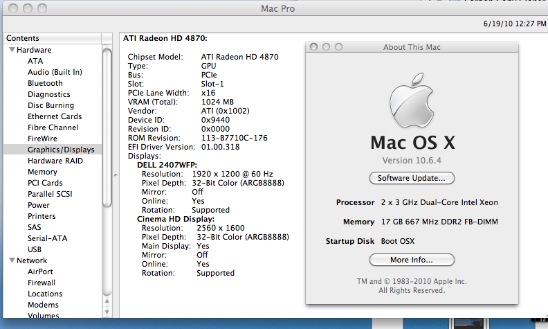

UPDATE : I have tried with 10.6.4, the XFX is still a champ. Single or Dual DVI, no issues at all.

Hi,
Here's my GPU details:
XFX HD 4870 ZDFC
Don't have a second monitor to test dual monitor support unfortunately, but no problems since the last update so keeping my fingers crossed.
I know there's no definite answer, but given that this is a reference 4870 card, all things being equal is it safe to presume that it should be OK for future updates as well?
Thanks.

ANY flashed card running NON MODIFIED ROM will be update immune. Otherwise, all "Apple branded" cards would be affected as well.

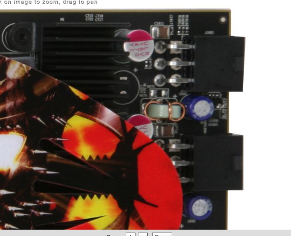

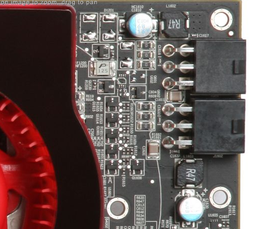

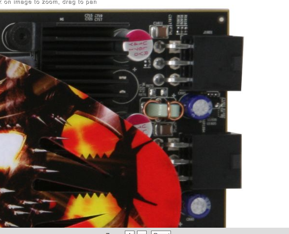

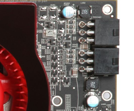

There is a 3rd thing that is actually more of an annoyance, though perhaps may be feeding in to the mix. That is the "power Not Connected" warning. If the Mac actually thinks power isn't connected it doesn't allow QE/CI or a 2nd display, so it is possible that 10.6.4 has intensified this Power message and made it part of problem. BTW...I have a theory on Power warning, but it is based on a small sample so is flawed. Would be great to get feedback. Basically, I noticed that the XFX cards worked GREAT until the ZWFx series came out. When tried in Leopard, these had same single DVI issue other brands did. They also were the first XFX cards to give that lovely power warning. It makes sense that in race to make cards ever cheaper, the power regulation circuits changed enough that Apple drivers thought Power not connected. I noticed that the XFX boards had the power connectors physically apart on the ZW cards with the warning. On the ZH and ZF cards that were warning free, the power connectors are snugly together, as on reference boards. I am curious if the spacing of Power connectors is a way to predict Power warning? If someone has a flashed 4870 with plugs touching and HAS the Power warning please speak up. And if there is somebody who has a flashed 4870 with approx 1cm between the plugs and DOESN'T get the "Power Cable warning", also please report.
The ZW "pwer warning" board is on right, the ZH card with no warning is on left/ Note the "Easy Bake" cheapy caps on the ZW. It was never meant to last as long as the earlier cards.

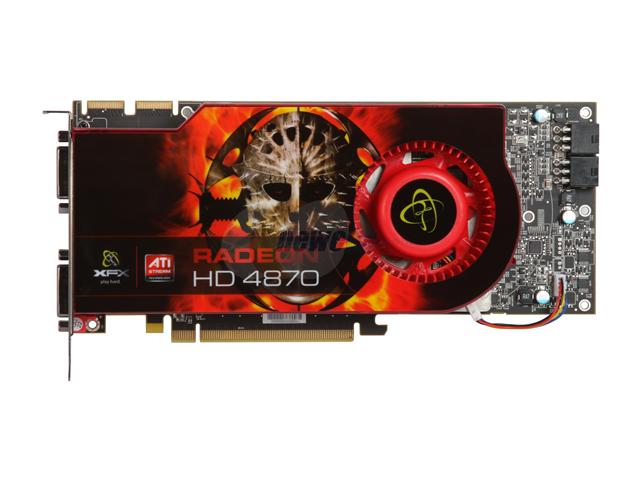

My Sapphire 100259-1GL 1GB 4870 works pretty much flawlessly. Like those earlier XFX cards, I think it's closer to the reference design.
It didn't have dual DVI before 10.6, but it gained it with Snow Leopard and hasn't failed on me yet. Runs like a champ.
Here's the now-defunct NewEgg link to it. Like the other such cards, they stopped making it a long time ago.
http://www.newegg.com/Product/Product.aspx?Item=N82E16814102801

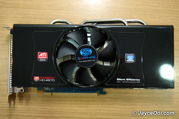

Sapphire HD 4870 512mb & 1gb works with 10.6.4 no hacks
I too would like to share my success with two flashed video cards I have.
They are both Sapphire HD4870's, One with 512mb & one with 1GB.
Both appear to be the same ati original reference with a new silent cooling option.
Both work perfectly in 10.6.4 without any hacking what so ever. Dual display as well.
Both look like this one

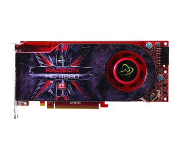

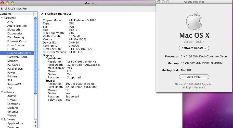

Flashed XFX HD 4890 1GB Part No.: HD-489A-ZDF7 Successfully updated to 10.6.4 with No hacks. Just ran Netkas' 10.6.4 package. Dual monitor fully supported as well.

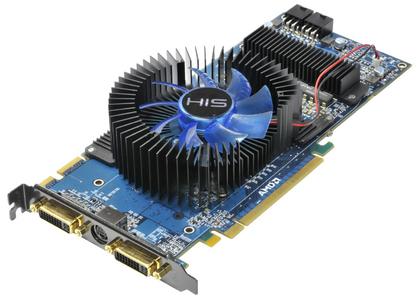

Flashed HIS Radeon HD4870 H487FN512P 512MB. Works without any problems under Leopard up to 10.5.8 and Snow Leopard up to 10.6.4 !
No hacks needed !
