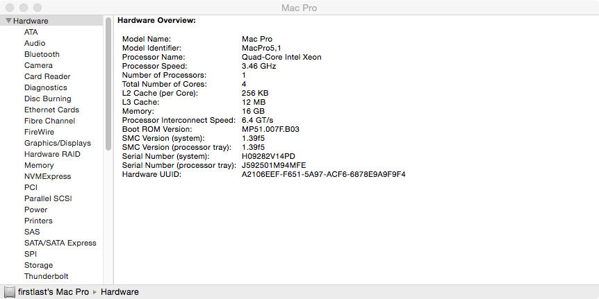

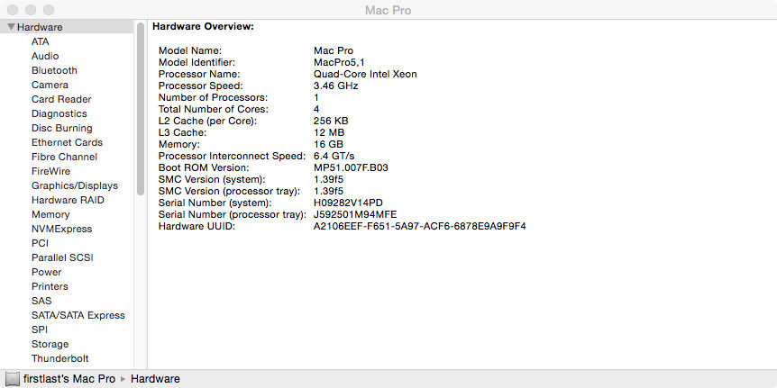

Do you know there is an upgrade in the Processor Interconnect Speed of the factory Quad Nehalem Mac Pro (4.8 GT/s), when the processor is upgraded to a X5677 (6.4 GT/s) ? The performance gain at the System level is not just arithmetic between the two processor frequencies . It's greater . We don't exactly use buses with the Nehalem Mac Pros - we use interconnects .

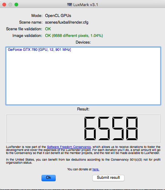

I am trying to use Luxmark, but as I am new with this, I am unsure what mode/scene to run. Recommendations so I can get this posted here?

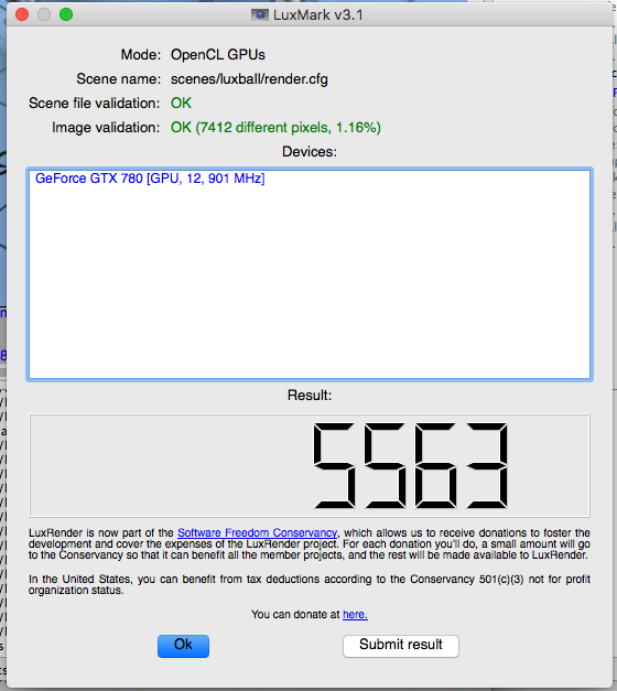

Use Luxmark 3, no need to choose anything, just open it and it will automatically run a 2min GPU benchmark with the default setting. Then you will see something like this.
You can simply capture the screen and post the result at here.

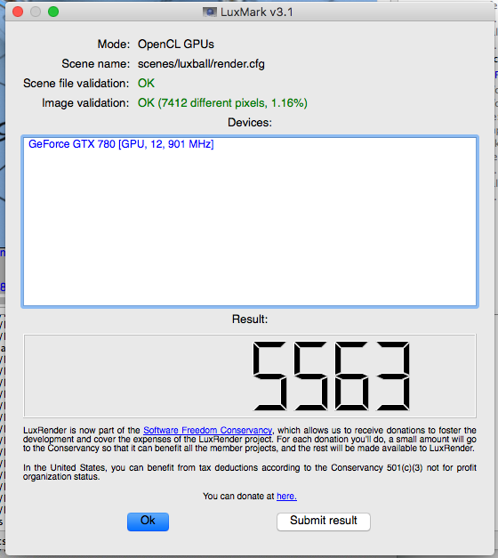

Thank you! Here is my benchmark;

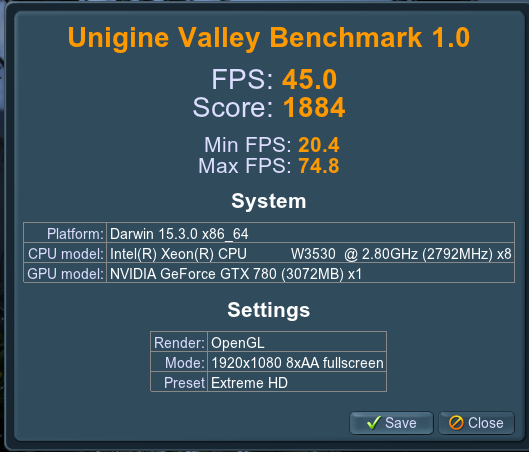

So now the others can help.

I am downloading that now, thanks, here is a new benchmark ran without anything in the background. Didn't realize I had some games and such open, looks like it did better.

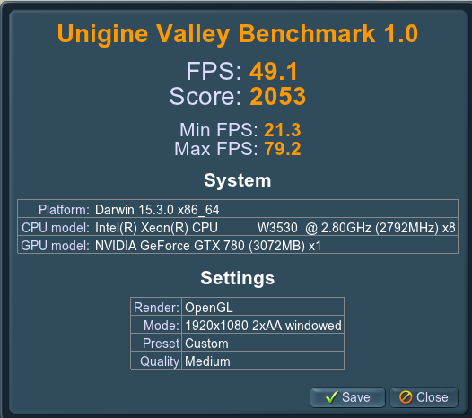

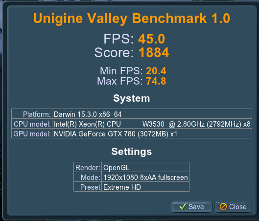

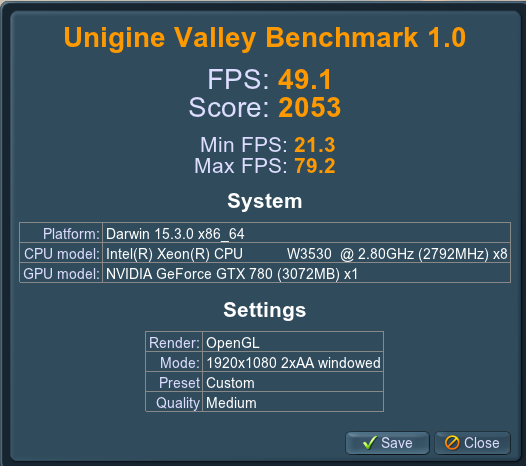

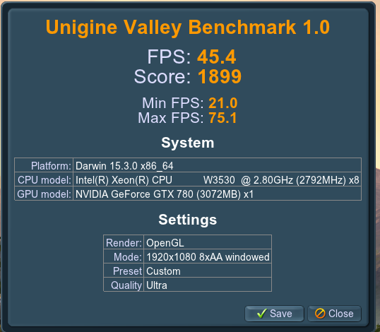

Here are 2 benchmarks, one on medium, one on ultra
[doublepost=1457900069][/doublepost]
Oh yes, I want to say Extreme HD preset, not extreme preset.

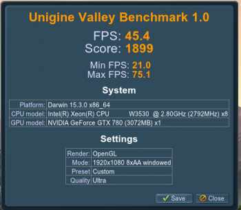

Here is the Extreme HD Benchmark!

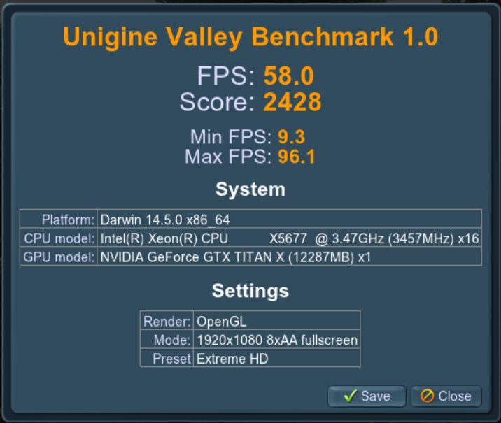

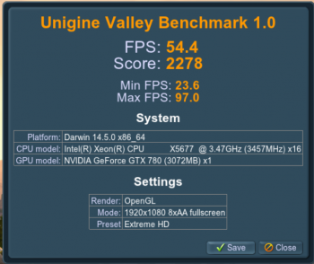

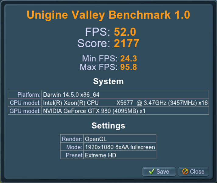

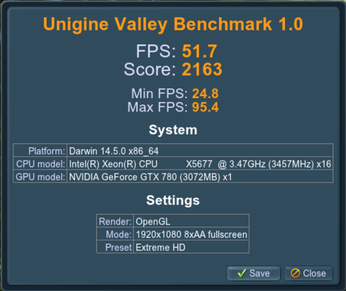

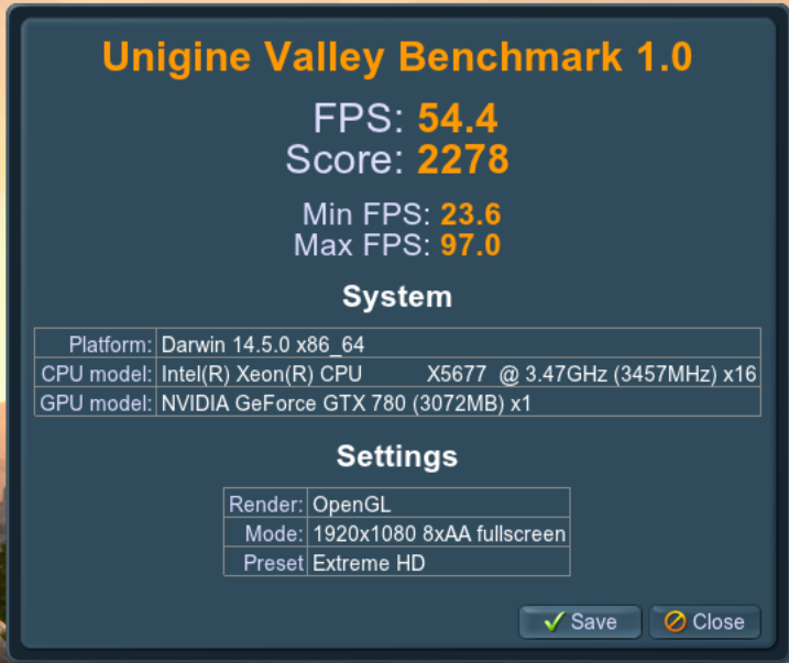

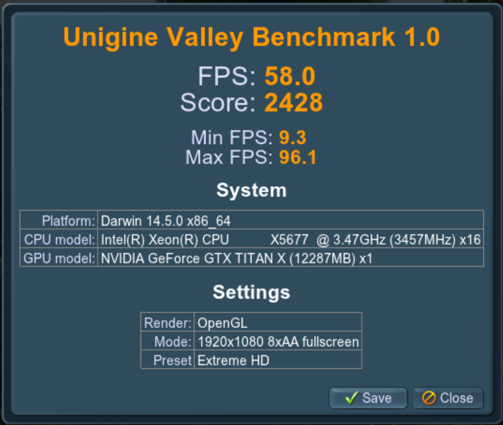

That might be about right. Here are results from my system using a flashed GTX 780 classified and unflashed GTX 980 and Titan X. It's a dual processor 4,1 upgraded with x5677s, 24 GB 1333. In OS X the NVIDIA drivers haven't matured since Kepler, which is why a 980 scores worse than my upclocked 780. I included a generic 780 score for reference as well.
