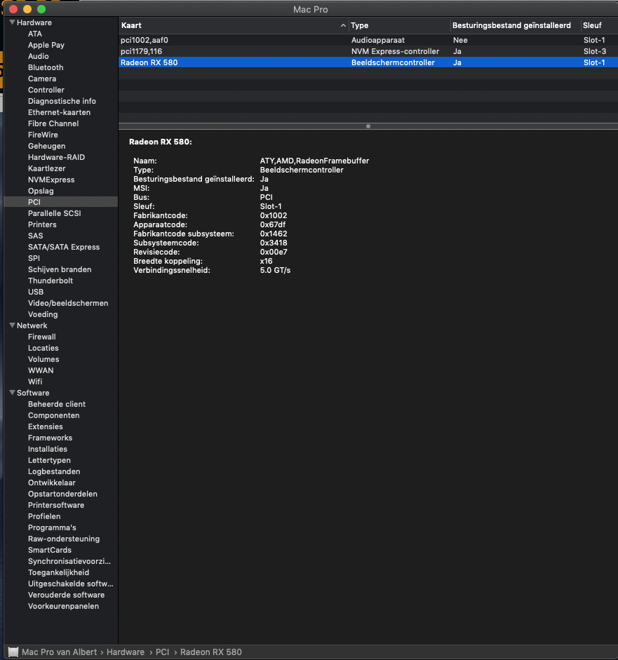

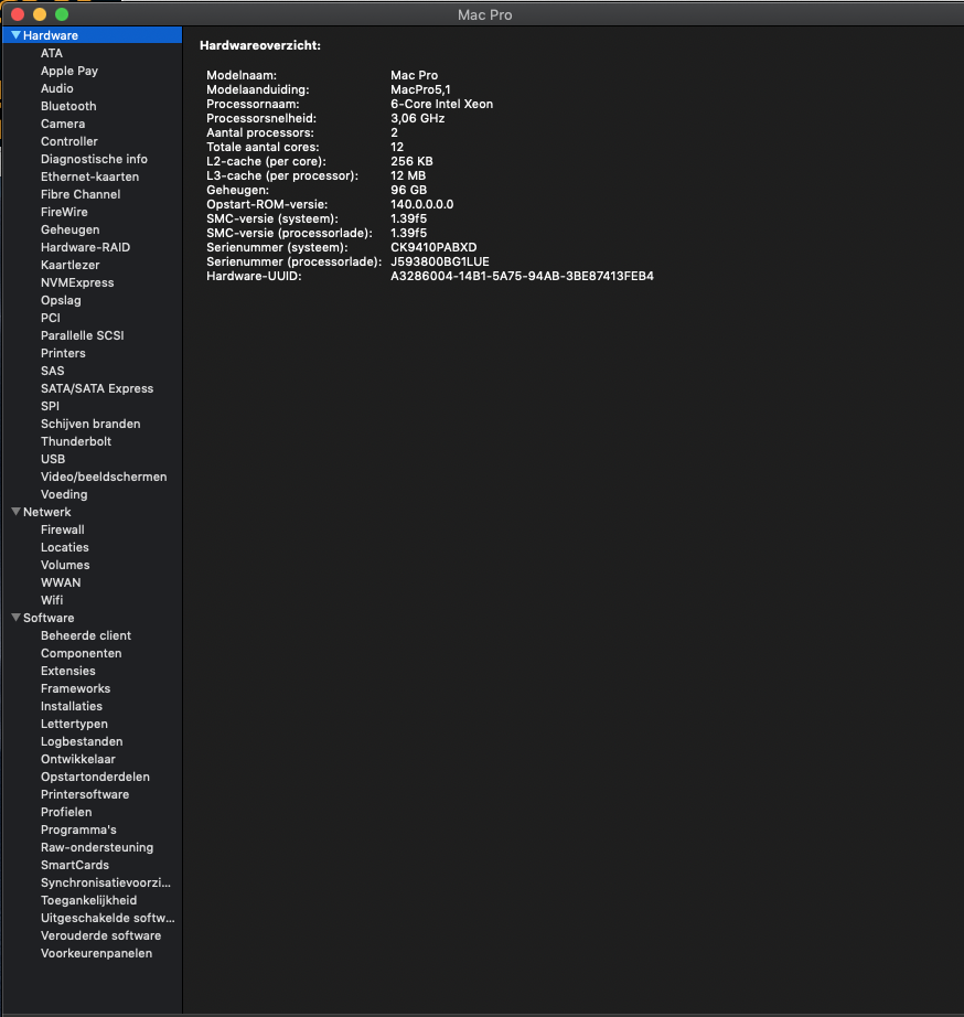

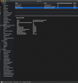

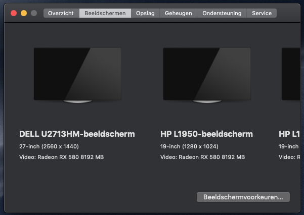

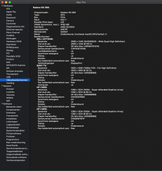

Thanks for the info again! ;-) I think it's ok right now, the MSI works great en when I must do a clean install then I put my old Readeon 7950 in place. And this MSI card do what he must do, all outputs are working (got 3 monitors + 1 Sony widescreen tv), render times are perfect (use it for 4K video), and he is ferry quit, can't hear de fans.
I place a view pics of my setup en Mac for info. ;-)
