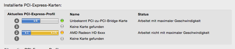

Hello Florian,
i used a ROM from you to flash a Juniper 5770 2DVI/HDMI/DP in Bootcamp (Windows7-64Bit) with WIN ATIFLASH; unfortunately now all screens remain black, i cannot see screen neither in osx nor in windows.
it was the 5770MOD2.efi.rom
guess i was a bit too early eager with the flashing, or did i make a mistake? tried to boot in Freedos previously, but could not get access to USB Stick, so i resorted to WINATIFLASH.
Hope there is a way out ; i currently don't have access to a PC with second FullLaneGraphics slot, so i used my MacPro1.1.
The 5770 is in slot 1 and is no more recognized in Bootcamp nor in OSX. In Slot 2 i have a 6450 HD
PS. i forgot to add: i did use a MP1.1/2.1, so maybe this is bricked now because the ROM is 64BIT EFI ONLY?
found this @netkas
It only works on 2008+ macpros, because efi is 64-bit now, not ebc anymore.
http://netkas.org/?p=503
