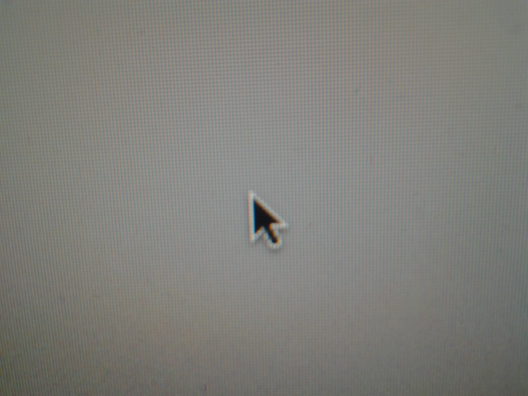

When I press the option I only get the mouse pointer. see attachment.

Safe Mode, or Verbose Mode will only work if the computer can find a valid Operating System. If it won't boot off the DVD that came with it using the method described above, it could have other issues, such as a non working Optical drive or even a Logic Board problem.
Did you try holding the Option key when booting from the DVD?
If it's just a HDD failure, and the Optical Drive doesn't work you'd need a second, similar year (2006-2008 I think) mac to install the OS onto an external drive.

I had used the optical drive recently when the computer was working. It ejects and spins up that I can hear. Just when I press the option I get nothing but the screen shot above. No selection of bootable drives with a arrow underneath each one.

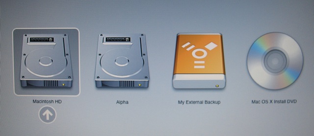

Are you using a wired or wireless keyboard? I have found that the wireless keyboard can sometimes be a problem when trying to use startup options.
That attachment picture is what you're supposed to get when you hold down option at boot. Choose the DVD with the OS on it, or the bootable backup. Use the arrow keys to get to it (select it), or use the wired mouse, then hit Return key (enter).
When holding down the option key at boot, the screen will show you any bootable OS. Your internal is apparently corrupt, so chose the DVD or External Backup.
The DVD will be slow booting, but give it time. The firewire drive will be quicker, but still slower than the internal was.
Booting into Single User Mode or Verbose Mode will only occur once a bootable OS is found by the EFI boot routine.

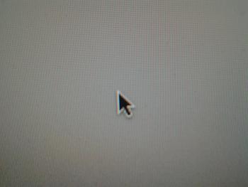

I only have a mouse pointer, nothing else. the second image of the two hard drives, one fire wire and cd I got off the internet to show that I don't see them. I had in the past and a few times when all this started they did showup but don't anymore when I choose the option at startup. Not using wireless keyboard on Mac OS x 5.6

Have you tried disconnecting ALL peripherals, including your mouse and keyboard, and rebooting? Sometimes a problem peripheral can cause these symptoms. If the system boots normally, try reconnecting the keyboard and mouse, and then each peripheral independently. If this doesn't work, remove any non Apple RAM from the iMac and try to boot again. Also be sure all RAM is seated properly.
If that doesn't help, you can try resetting the SMC, or resetting PRAM, although it doesn't sound like a SMC or PRAM issue. Regardless, sometimes resetting them helps.
If none of this works, then a visit to Apple for a diagnosis might be in order. It still sounds like a HDD failure, which can be the source of this problem.
Thanks. I did both of these still nothing.
