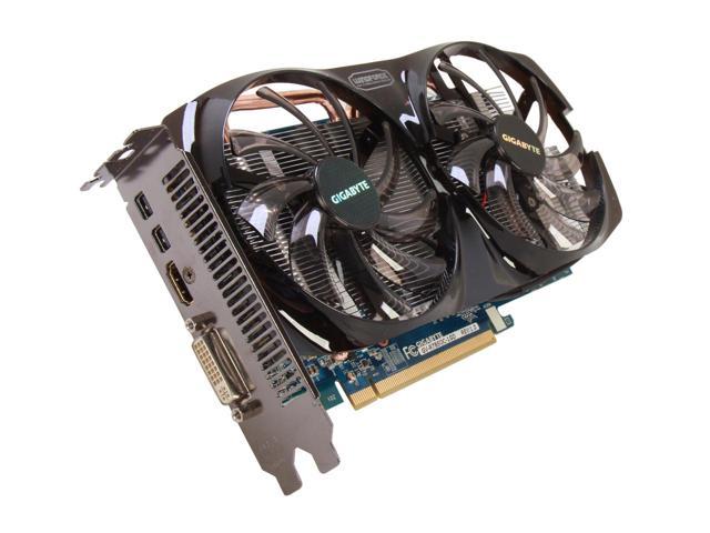

Running two displays from the mDP ports, no issues with boot screen, etc.
Card is a Gigabyte Windforce 2GB like this one:
Thanks for your reply. Yes, I meant like you mentioned; modifying my hd7850 rom using hd7950’s script. My hd7850 is Sapphire’s 2gb model, but could you possibly share with your rom so that I can study which part of rom I need to replace from hamachi to futomaki with. Thanks again.
