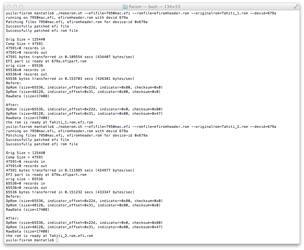

I simply open your ROM in VBE7 and save it to a new file, then everything is fixed. I can't test the file since I don't have this card. But the terminal result looks very good to me.
Anyway, both your normal and OC EFI ROM image file are contained in the Zip file.

Thanks for help - it seems only this 47 (aka G) was added. It works fine !
Tested version nr 1 😉
