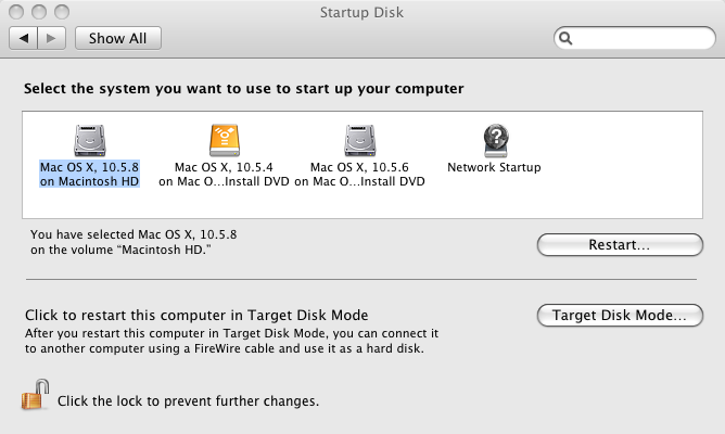

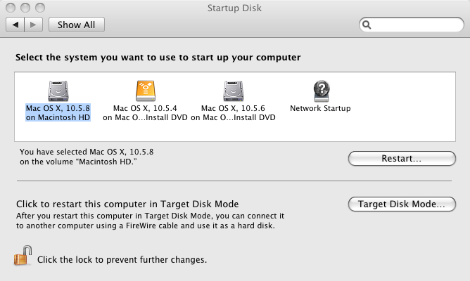

You insert the FireWire cable into each MacBook. You start the good MacBook and hold T until the FireWire logo appears. Then start the problematic one and hold OPT and select the hard drive of the other MacBook. See if it works okay with it over FireWire.
It didnt work. The good Mac just booted normally when I held T and I checked the network settings after I started the other Mac but it wasnt showing up
On the good MacBook, go to :apple: --> System Preferences --> Startup Disk --> Restart in Target Disk Mode.
