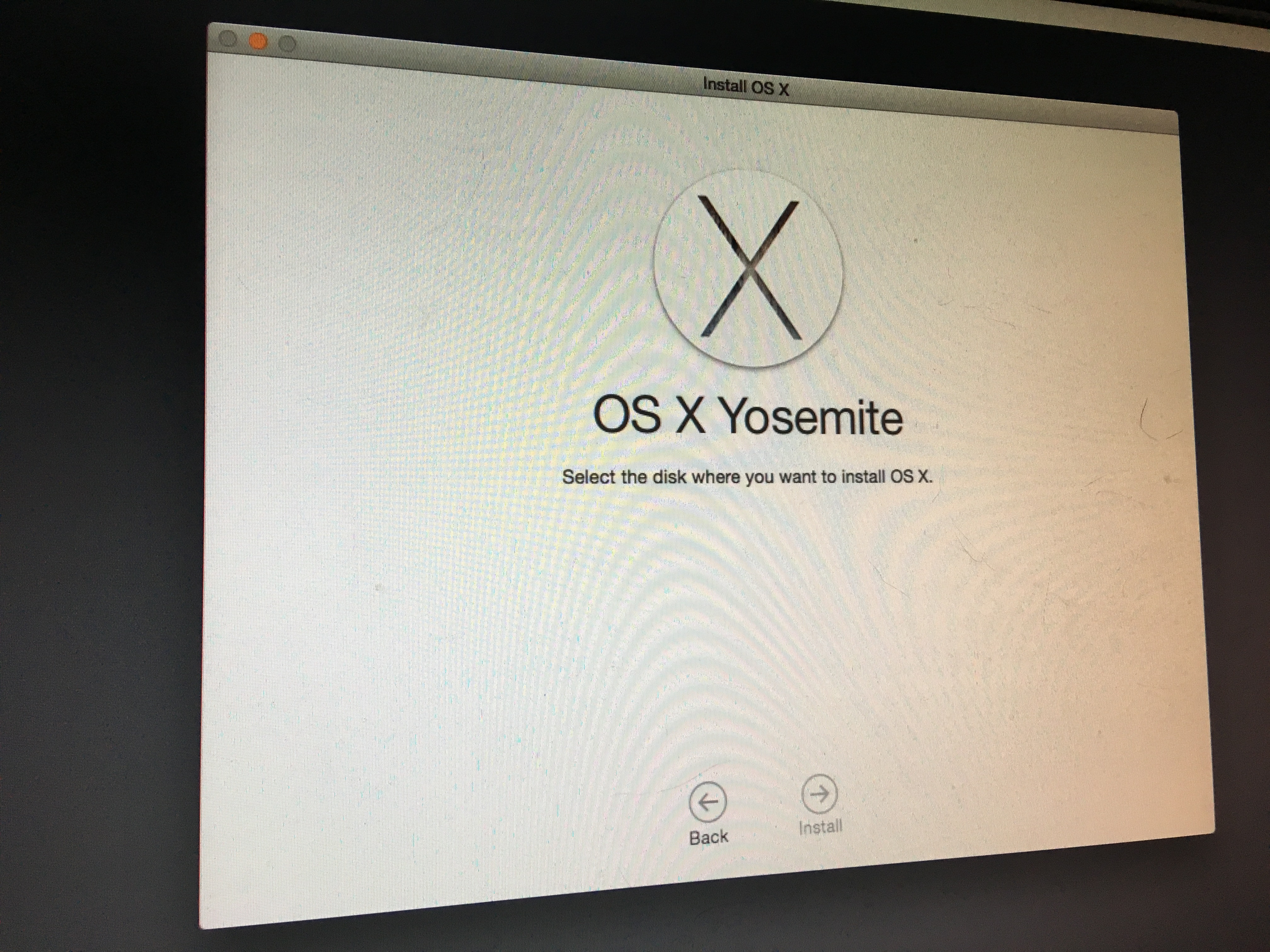

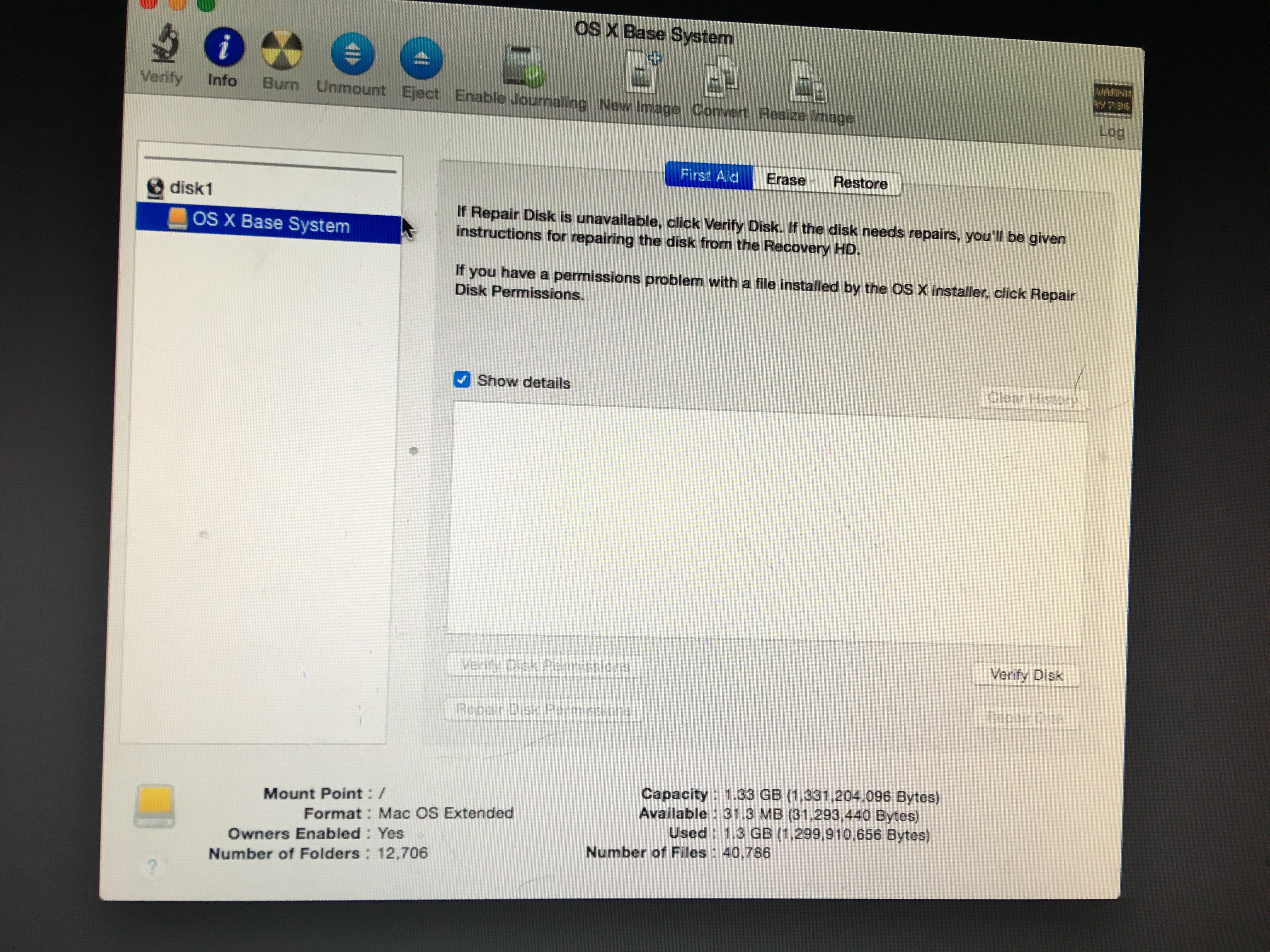

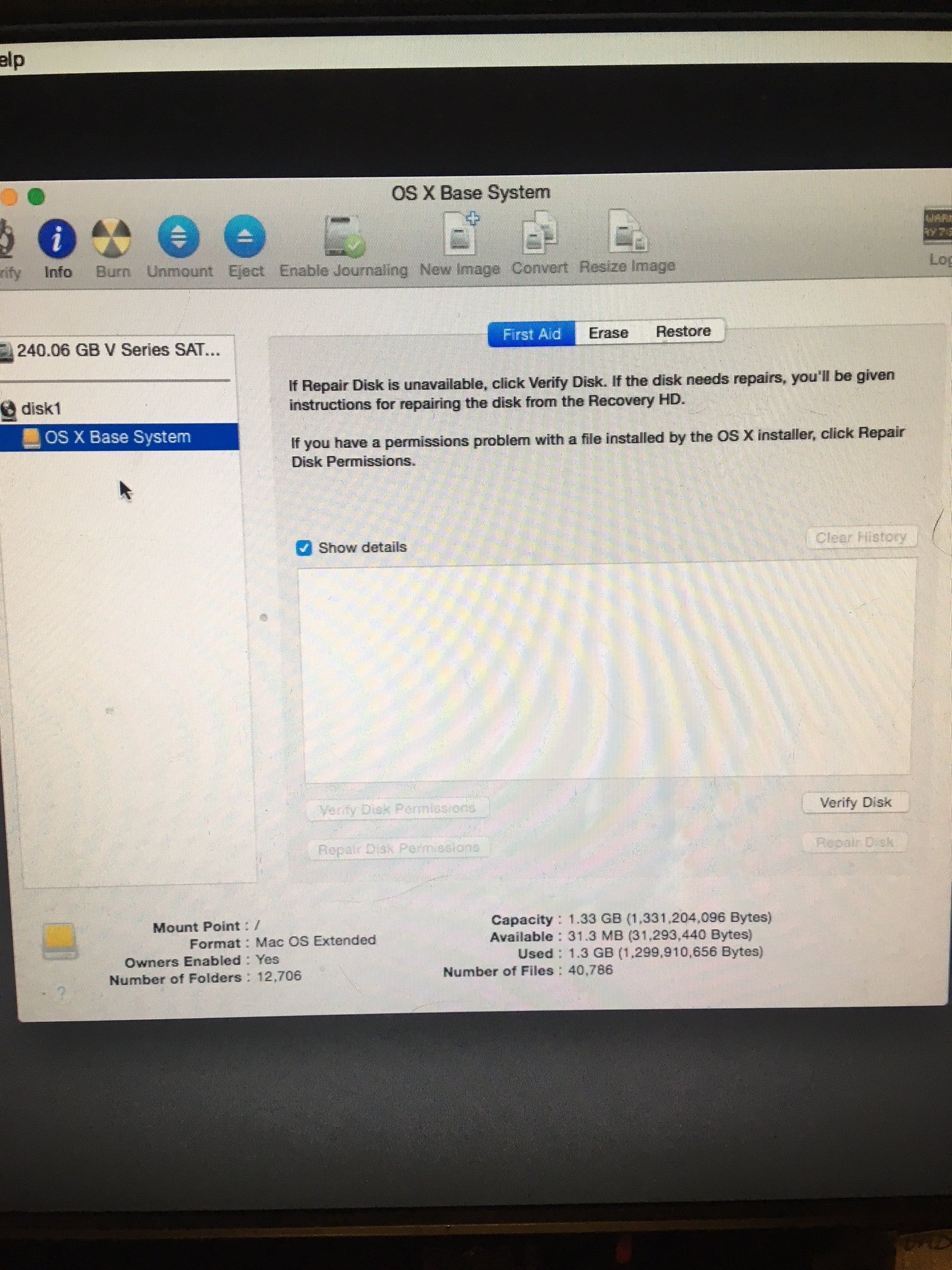

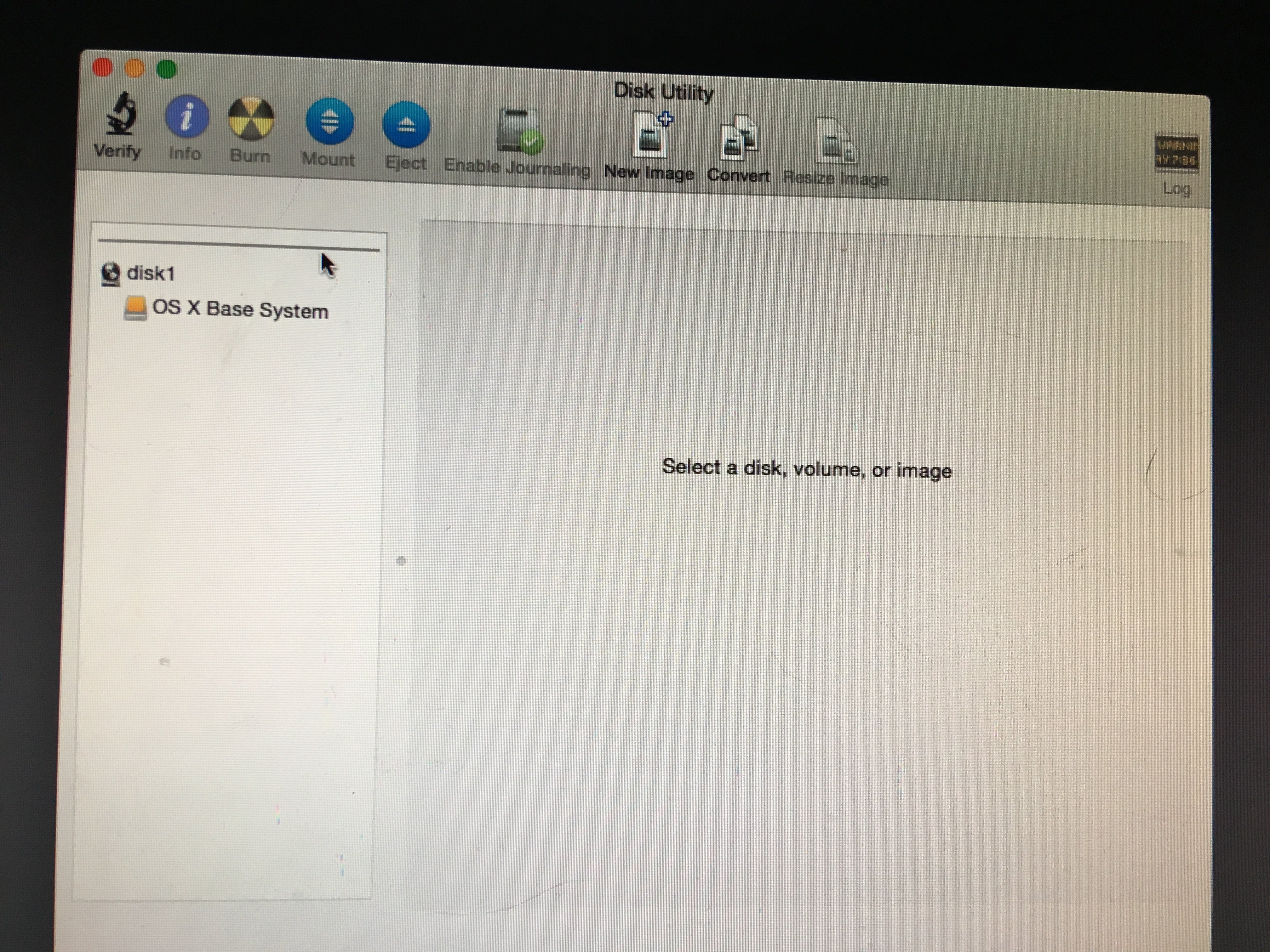

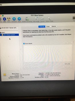

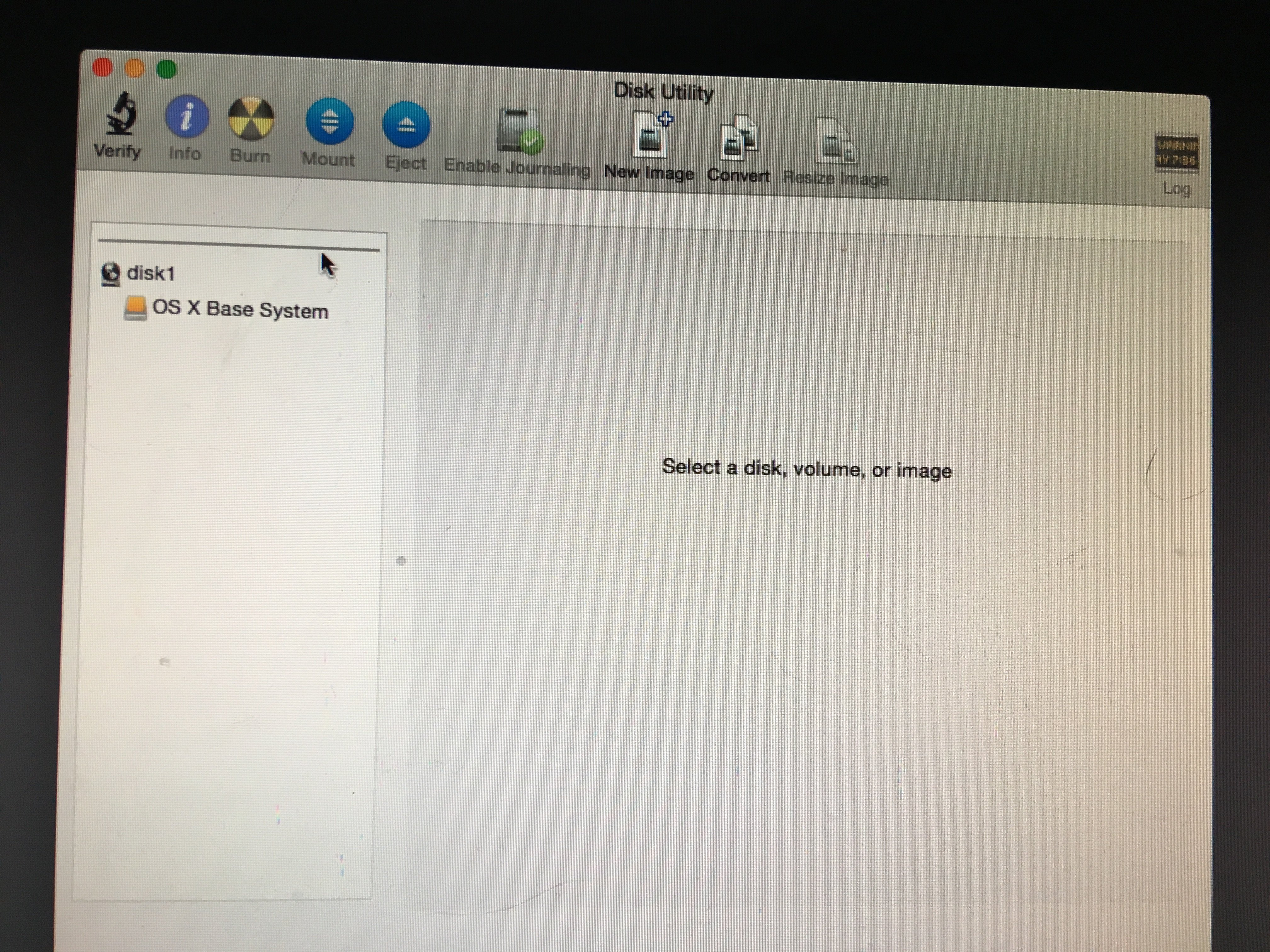

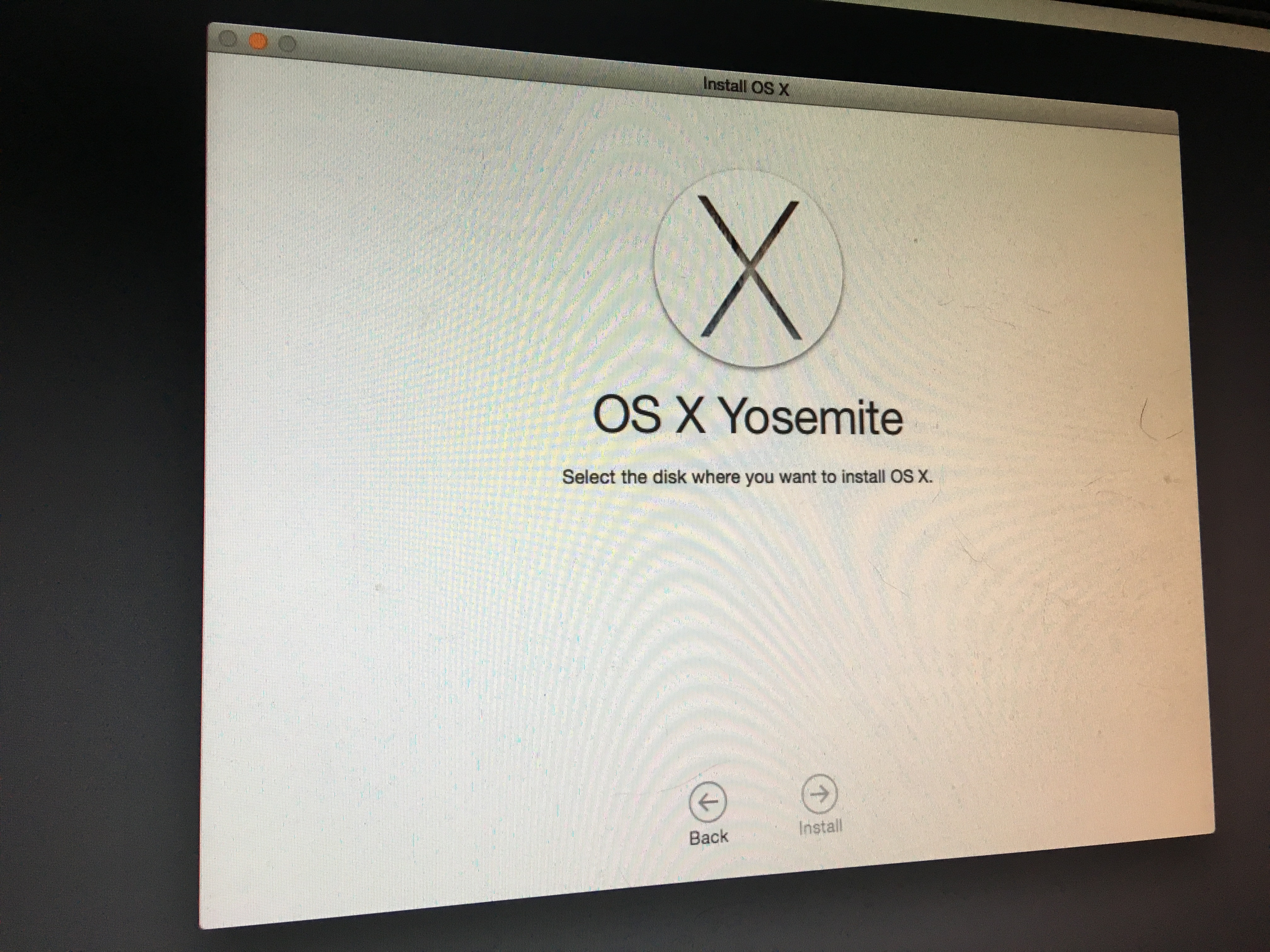

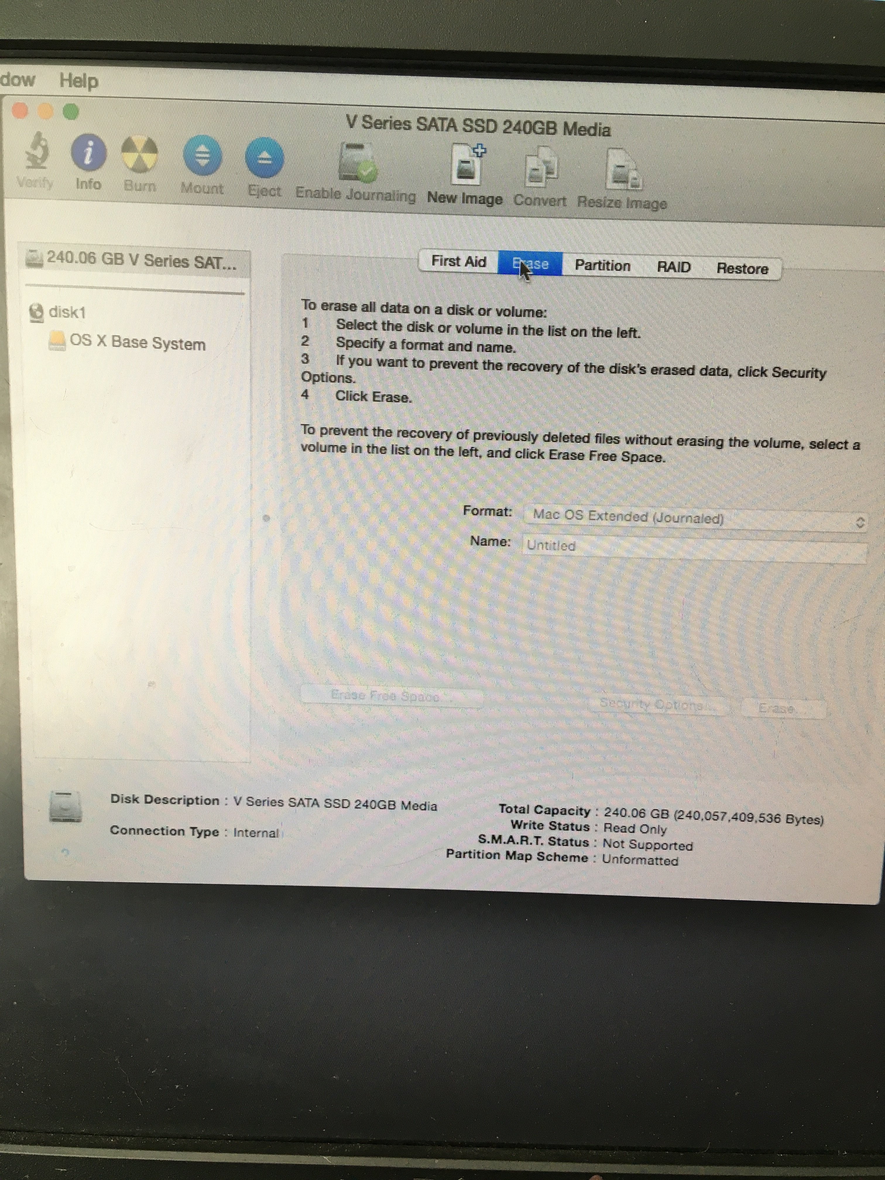

Hi there, apologies if this is in the wrong subsection! I have a problem with my Mac Mini. Upon switching on the computer I get the flashing question mark icon. I have followed instructions online and don't seem to be getting anywhere...I think I might need a new SSD? Any help would be appreciated! Thanks muchly! Below are some relevant screenshots.

2012.

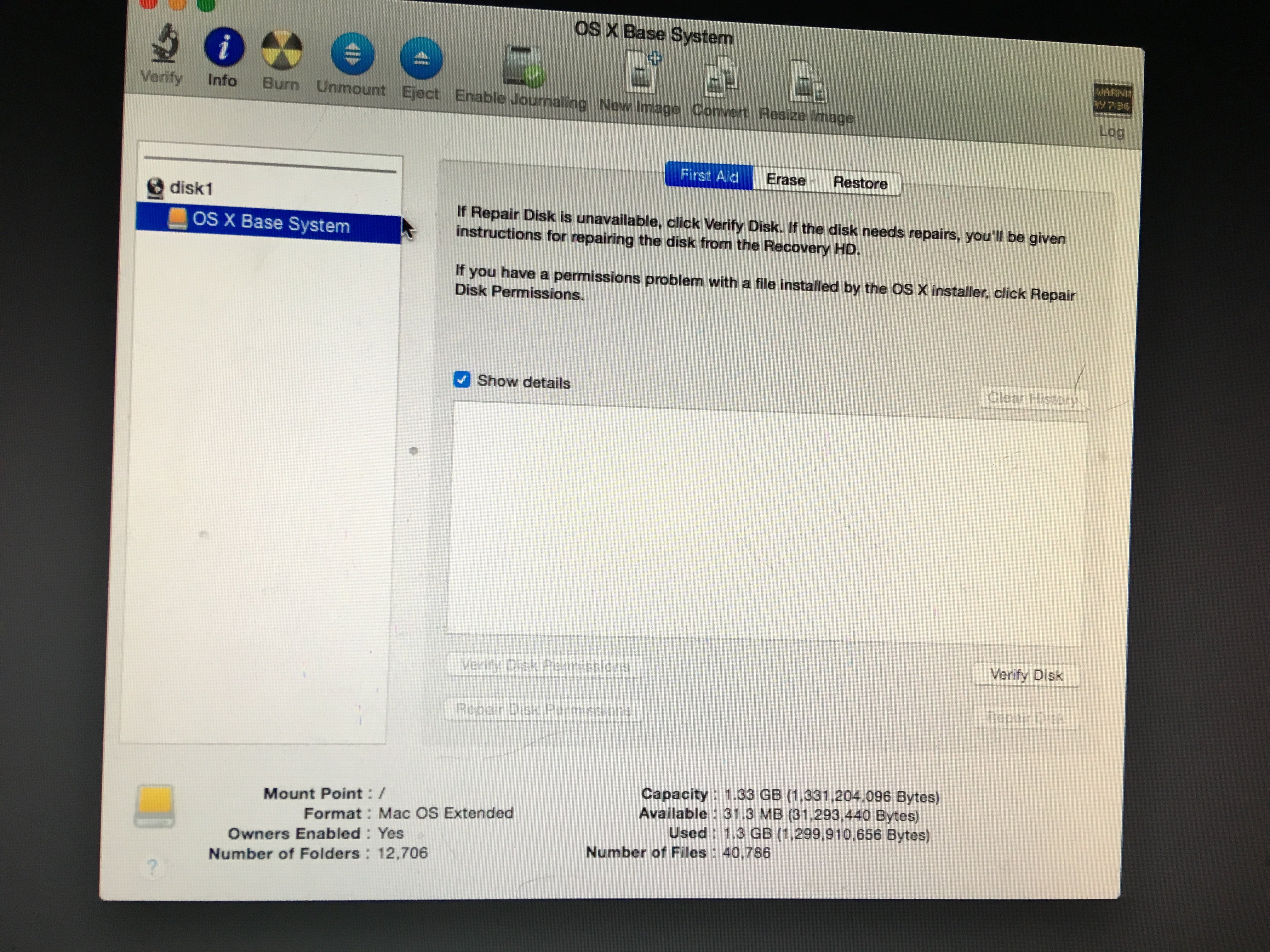

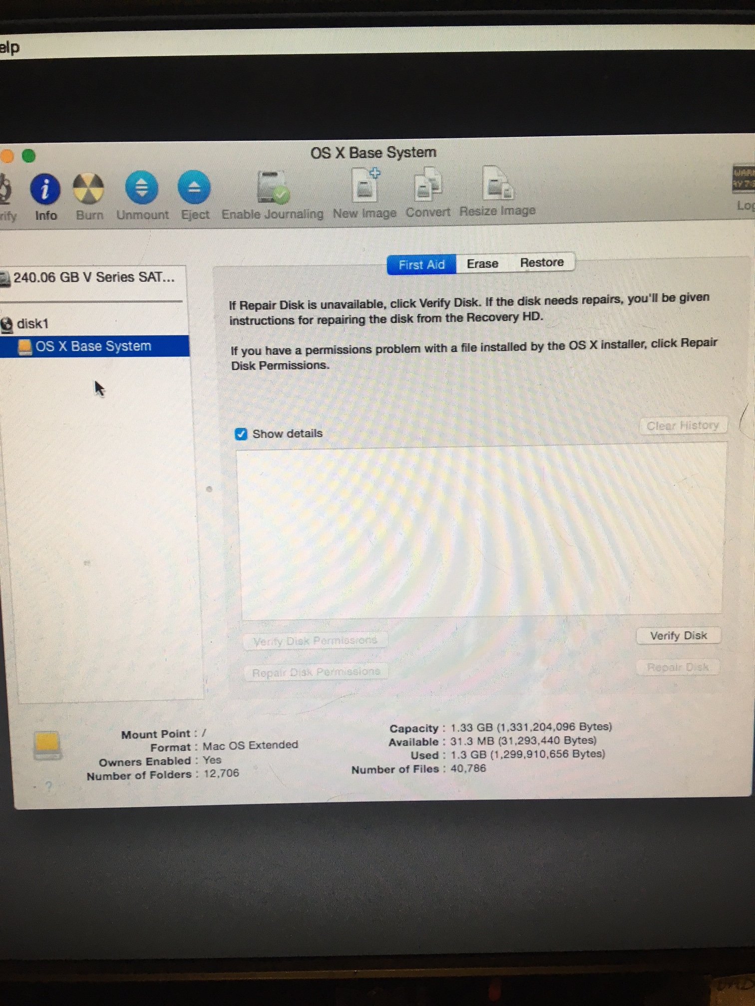

It's seeing 1.33GB of some sort of drive, and it's full.

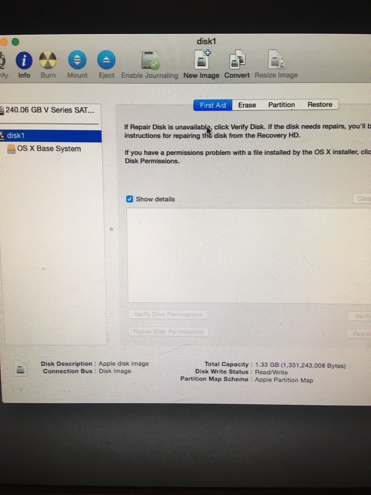

What's it say when you click on "disk1" in Disk utility?
You may have more unformatted space there.

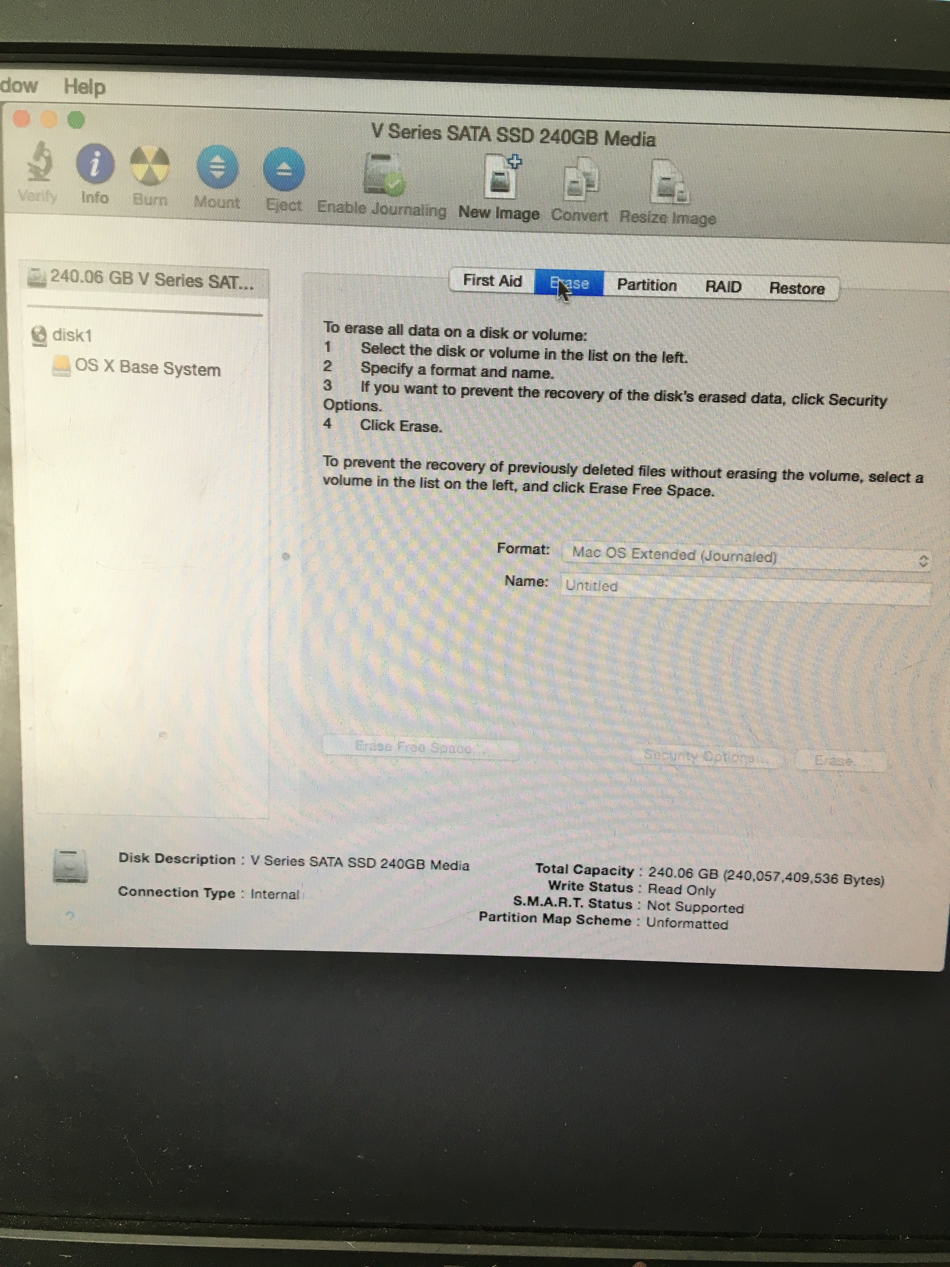

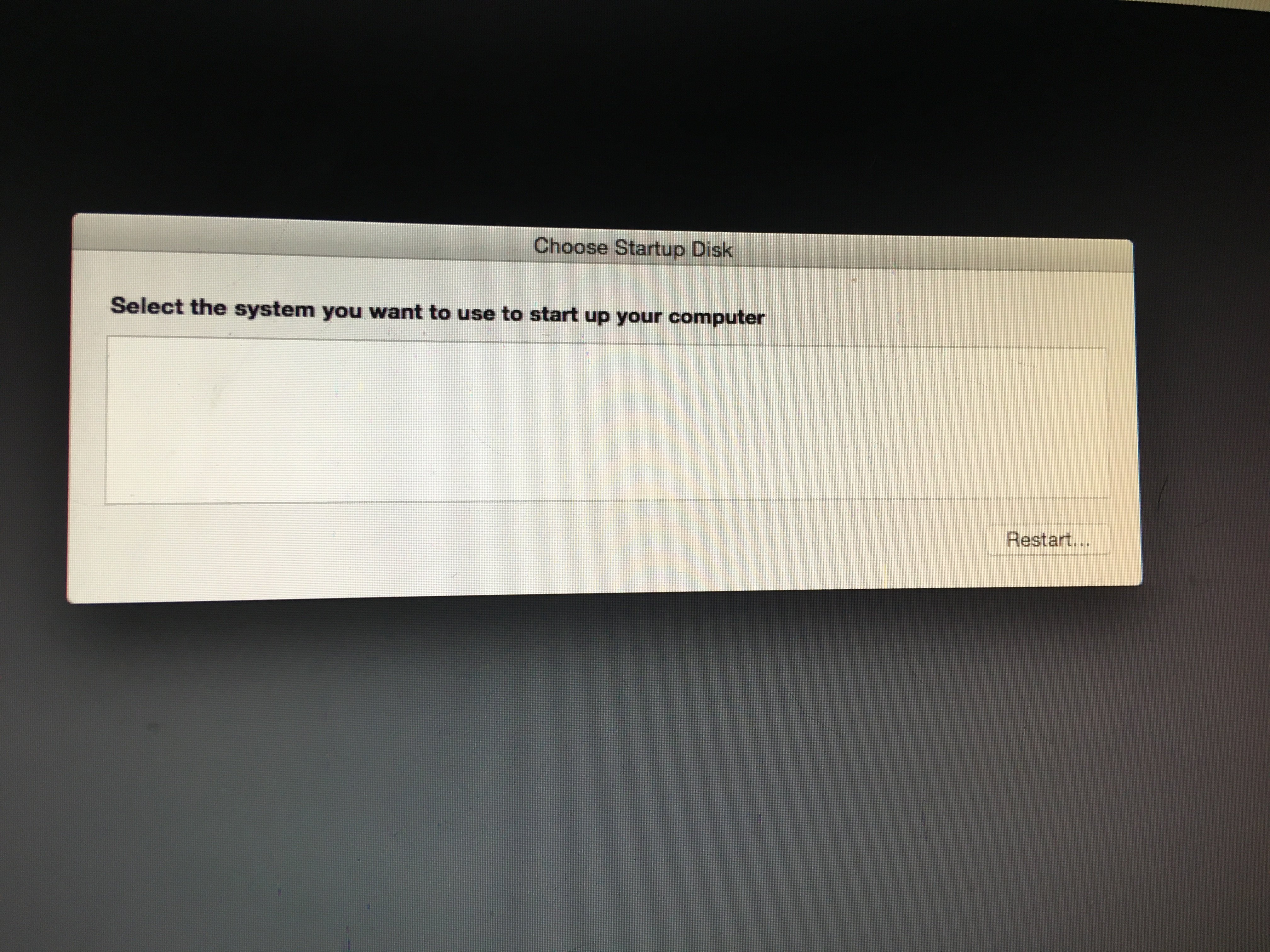

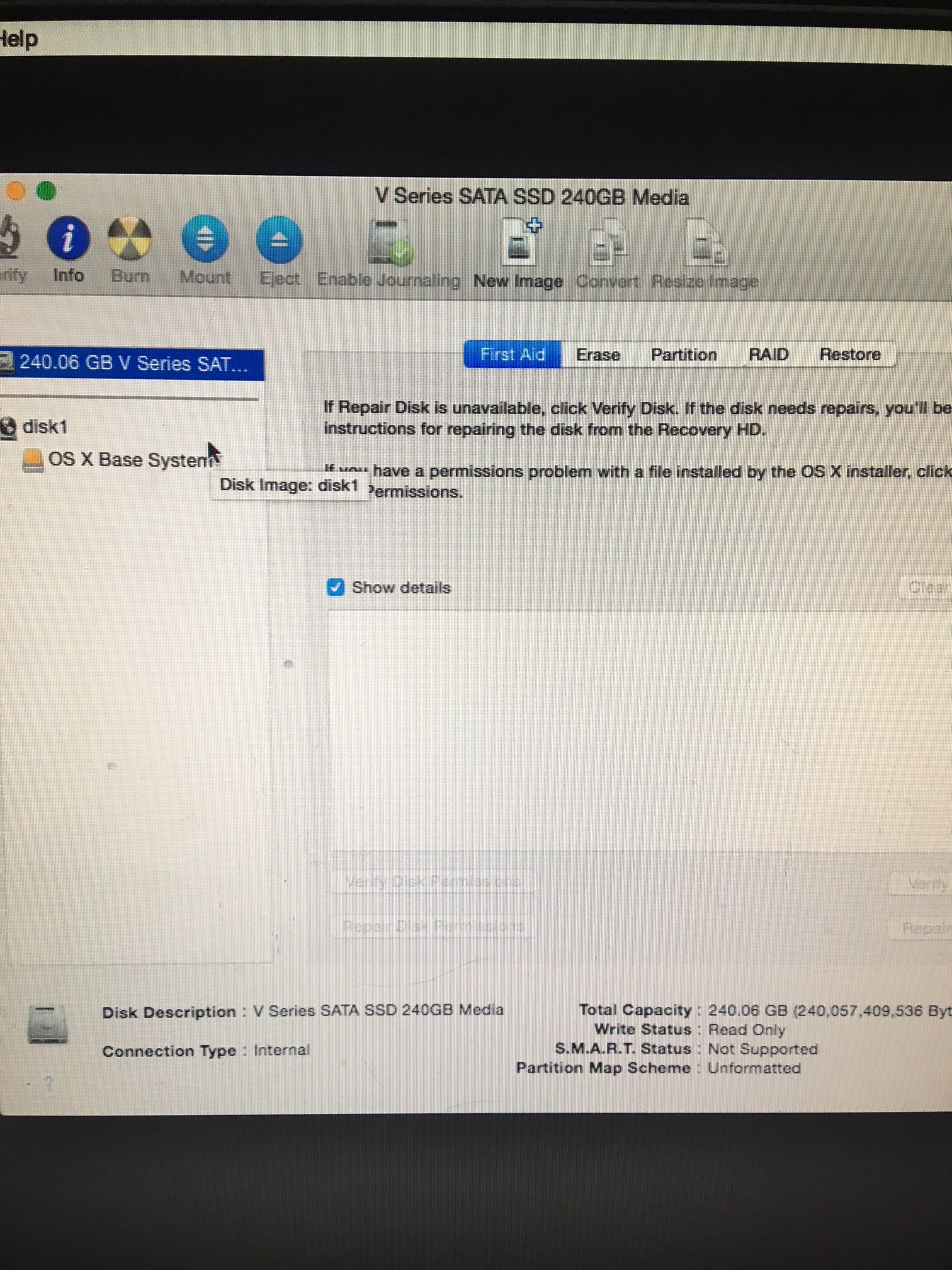

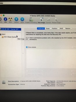

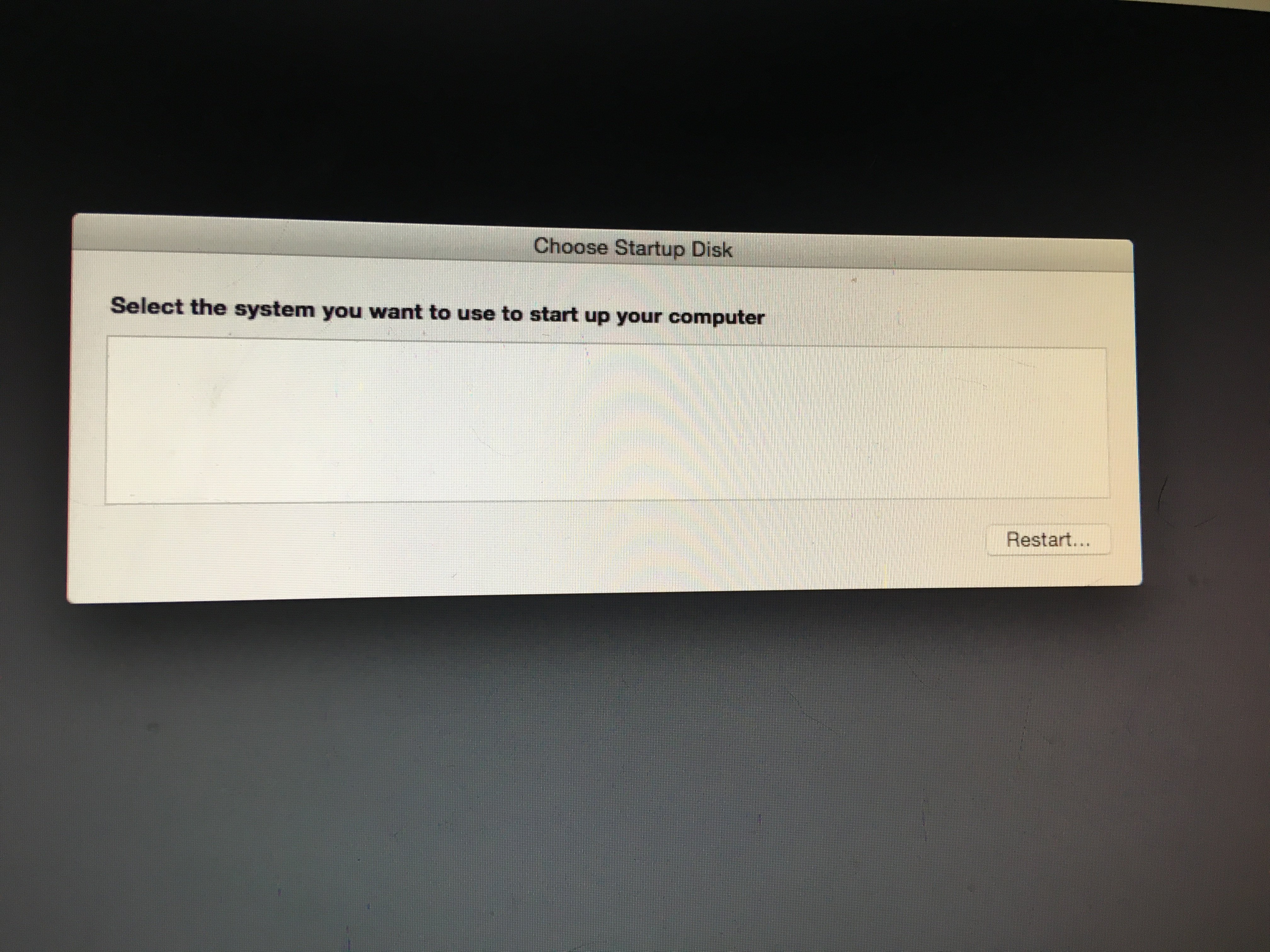

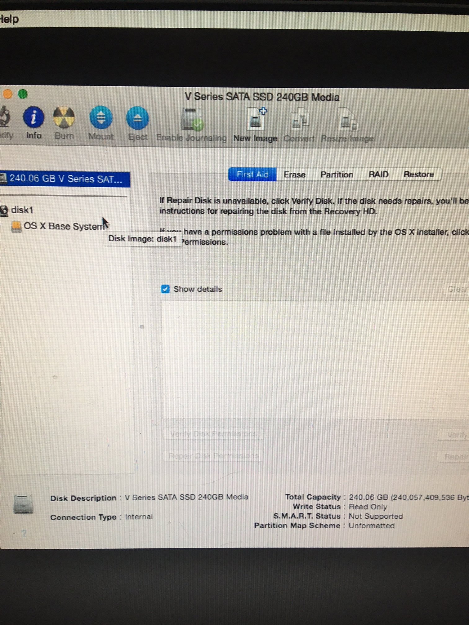

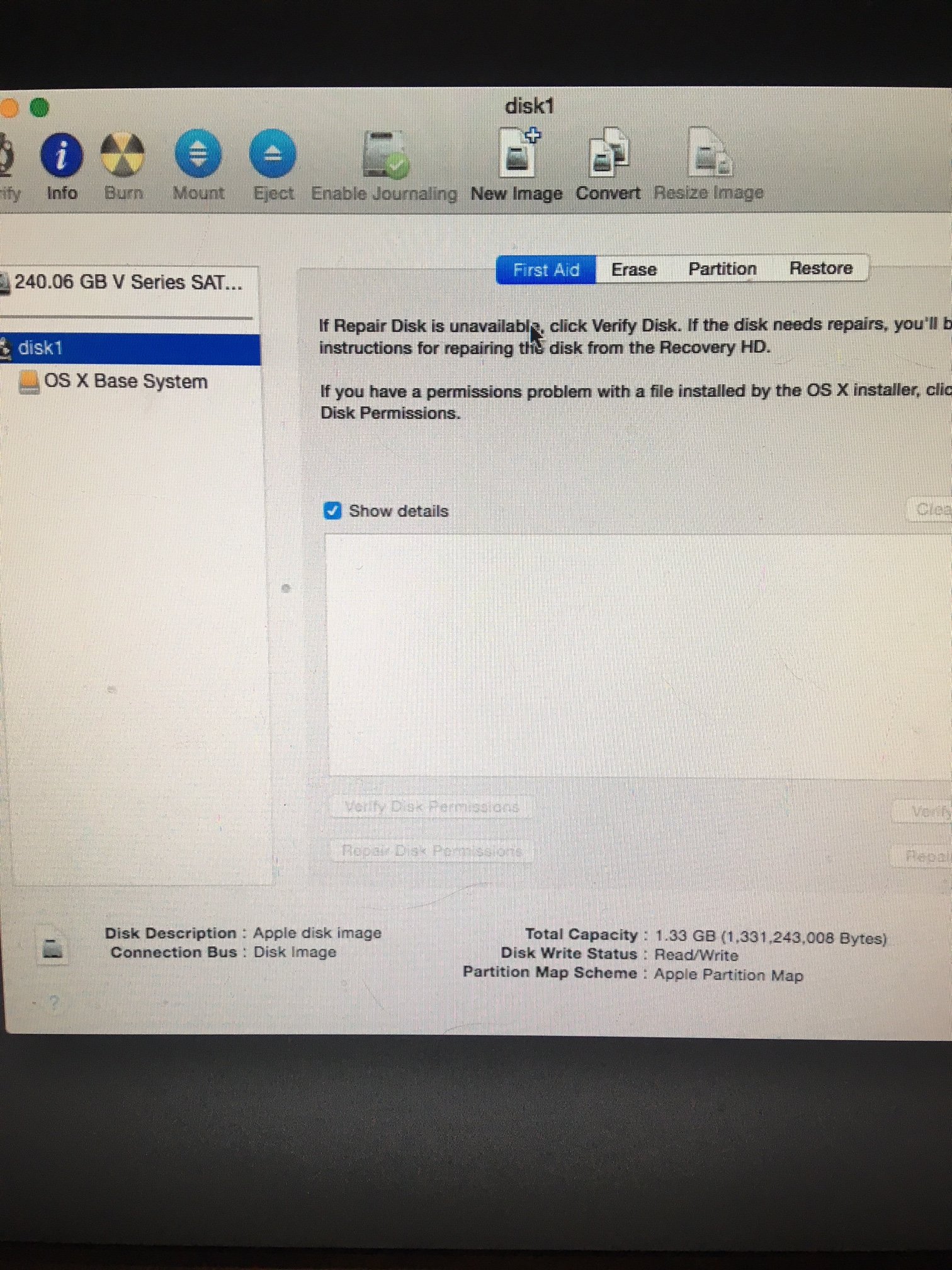

With regards to 'disk1', I include a screenshot below. Its now showing up the SATA drive. Curiously it isnt showing up on startup disk though.

240.06GB. It says unformatted. Looks like you may have tried to install to recovery partition?
I'd erase and format GUID HFS+ etc, and see if that 240GB shows as a partition for your install.

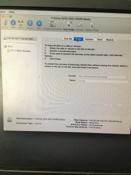

thanks for the reply. However everything is greyed out when I click on the ssd...
This all happened right after the computer froze and had to be rebooted. Not sure how relevant that might be.
