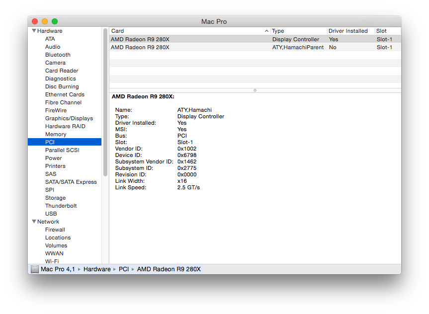

Thanks everyone for the valuable information in this thread and elsewhere. I managed (after some detours) to get my MSI R9 280x flashed and I have bootscreens now, but I do not get audio over HDMI or mDP. Running Yosemite on a MP4,1 flashed with the 5,1 firmware.
Anything that I'm missing or am I just out of luck?
No, the card doesn't show up in the Sound Panel in SysPrefs. An original 5770 does, however. Attached what my PCI information shows, which doesn't show an audio component unlike Mr. Zarniwoop's card shows.
I flashed the card several times, I used the rom he posted, created my own ones, so far no luck. Right now I'm using the latest software I could find posted in the MSI forums and then copied the EFI part from his rom into it. It works fine with bootscreens, but I have not been able to get the audio component yet. 😕

ok, I have the same card. Please post your card.rom, mine is using Elpida memory.
I have attached 351 from your link, please try it. You need to change .zip to .rom
BTW, Audio is here
BTW, Audio is here
Thanks kennyman, I'm already successfully running 351 with EFI support for bootscreens, as mentioned above.
I read the thread about updating 4,1 MPs with the 5,1 firmware and how Apple's cards then supported audio as well, but I didn't realize that for flashed cards a kext was still necessary. Thanks for the link to the thread, installed and all good now! 😀
