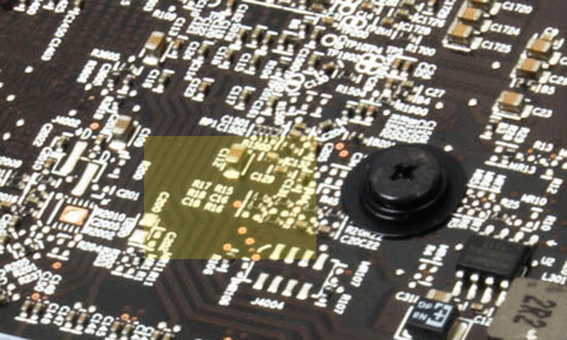

I just ordered the MSI. Where can I find more information about the r17 resistor thing?
Desolder R17. It's located in the yellow highlighted area.

I'm probably unwilling to deal with the R17, will my 280X see any big performance improvement in Final Cut Pro X with the 5.0 GT/s?

has anyone here don't the r17 desolder? i am kind of hesitant about it lol
Many have done it with great success. It doesn't get easier than what were provided in this thread. I'd suggest contacting MacVidCards for help. He charges for his service but it's worth it.

i very much appreciate this thread, it's incredibly informative. but taking a solder iron to a brand new video card... well... lol

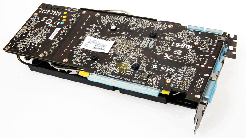

I just installed an R9 280X (MSI "Gaming" 3G OC edition) in a 2008 2.8GHz 8-core. I installed the card with the provided 8-6 pin adapter. It was nice to see it included, and no problems.
It's unflashed, and so far it seems flawless. I may get around to flashing it one day, but the computer is rebooted only every few months anyway. It replaced a genuine Apple 5770. It's definitely snappier, though not overwhelmingly so.
About the resistor: My understanding is that it would rarely make a noticeable difference, and even then it would be so minor that you would have to look for it (i.e., in benchmarks). If you are concerned at all about soldering, then I'd strongly recommend skipping it. I could de-solder it easily, but I don't think I will bother. On the other hand, if you have a nice pair of flush-cutters, you could consider just snipping it cleanly in half. Just be extra sure you've got the right one!

Just picked up an MSI R9 280X Gaming 3G OC card from MicroCenter out of their clearance bin for about $225; the box didn't have the right part, but after I paid for it I looked at the sticker on the card itself and both numbers matched what Zarniwoop mentioned in post #3.
I also seem to have lucked out as all the adapters were still in the box, including a weird Mini-DisplayPort to HDMI adapter and the needed 8 to 6 pin adapter.
I'll double check the ID when I boot into BootCamp and run ATI WinFlash.
I'll keep the BIOS mode set on Legacy as that's what the flashing should replace, right?
Those of you who say it works OOTB, did you switch from Legacy to UEFI mode?
