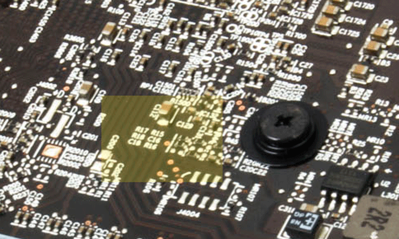

Is there a guide on how to remove the resistor?
And is it always r17? I mean with every manufacture of Radeon 280x?
I already know about the following guide, but I don't know how to take it off.
https://forums.macrumors.com/threads/1547340/

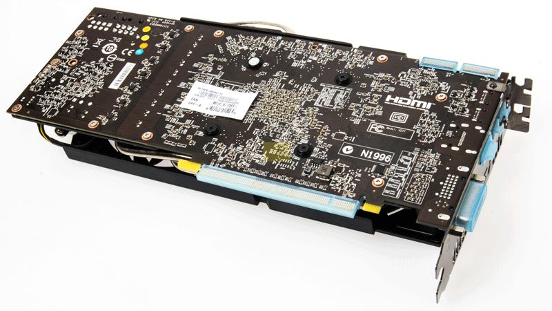

It is the R17 resistor on a Radeon 280x regardless of brand. The proper way to do it is using a solder gun with desoldering wick to remove R17.
If you don't have the equipment and want to wing it, use a nail clipper to snip the resistor off. Take a look at these pictures for reference of R17 location (in the yellow highlighted area).

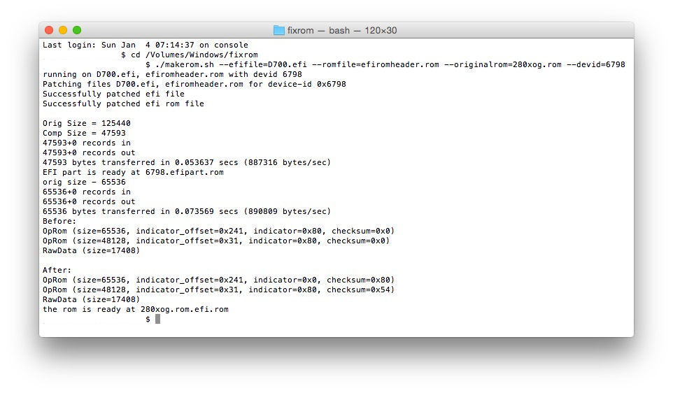

Just try the fixrom script with your ROM and my 7950 efi, no error at all.
I guess one of your folder's name may contain empty space which will cause an error.
Try to put all those file on a USB stick named "untitled" (may be just inside a folder called "fixrom"), that will reduce the chance of having error.
Anyway I can't test the ROM since I don't have a 280X, but here is the ROM file
View attachment 280xog.rom.efi.rom.zip
I am too lazy to hex edit the card's name. It may shows up as D700 in your system profile, but that's just a name, won't cause any issue.
You are the freaking man! Full boot screen, recognized as r9 200 series in Windows 7, and FirePro d700 in Yosemite. Can't thank you enough!
