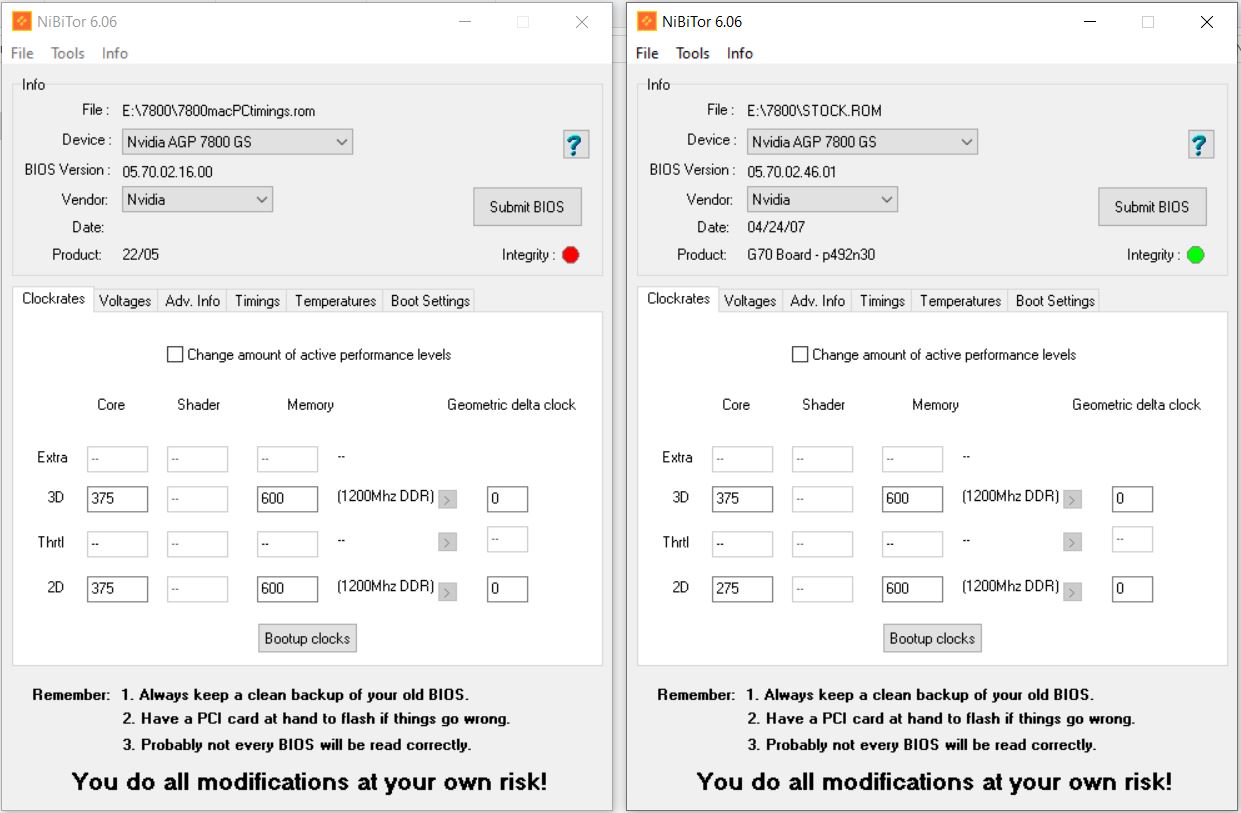

Current project is to compare a BFG ROM from TechPowerUp to my read out Lindbergh ROM to understand what they do different.
Using Nibitor 6.06 I am able to compare both ROMs as shown here (Mac rom to Lind). I am not going to show all of the screenshots because it would consume a ton of screen space in the thread. This is only to show what I am working on.
So far, with all the Lindbergh timings swapped into the mac ROM using Nibit and the softstraps using HxD, I get no display out of the G4MDD the mac ROM by itself gave display but with massive artifacting. A result, even a negative one, is a result. I will spend some time thinking and reviewing the changes to determine the next step. Open to suggestions, I can also share my files if anyone wants to review the data themselves.
