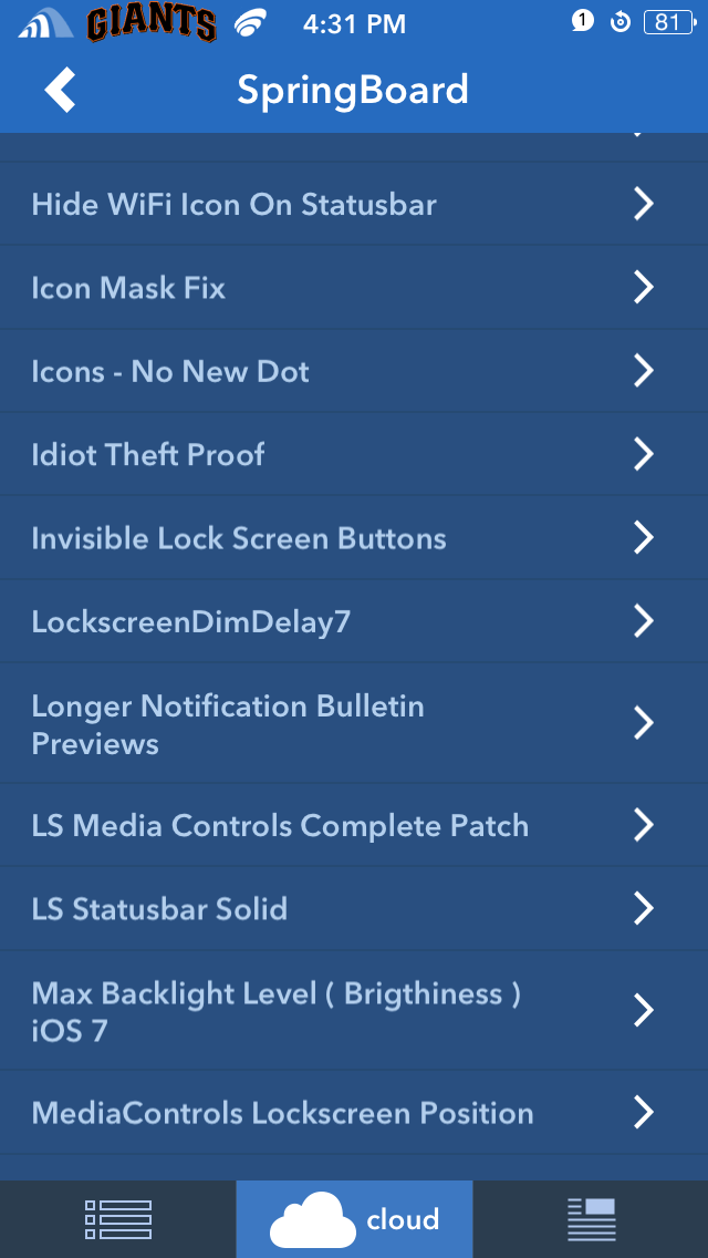

Im trying to find that tweak but I can't find it anywhere in flex 2. What am i doing wrong?
IF the link doesn't work, the patch is called "Iconomatic animation crash fix"
It seems like it hasn't been put into the cloud (yet).

Yeah weird, like the only one not appearing, its right there between 'Icon Mask Fix' and 'Icon - No new dot' for me. You also have a couple I don't have in that screenshot so maybe there is something weird going on with the cloud?

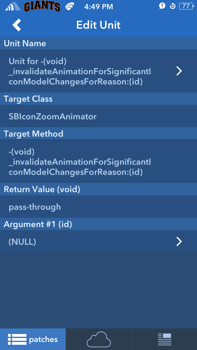

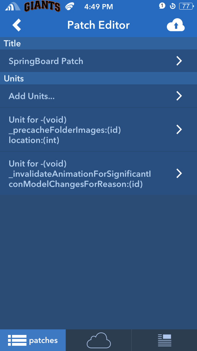

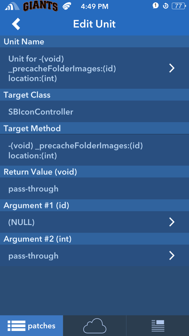

Does this look right
Yes perfect, now hit the grey tickbox on the 'patches' page to apply it - will require a respring.
