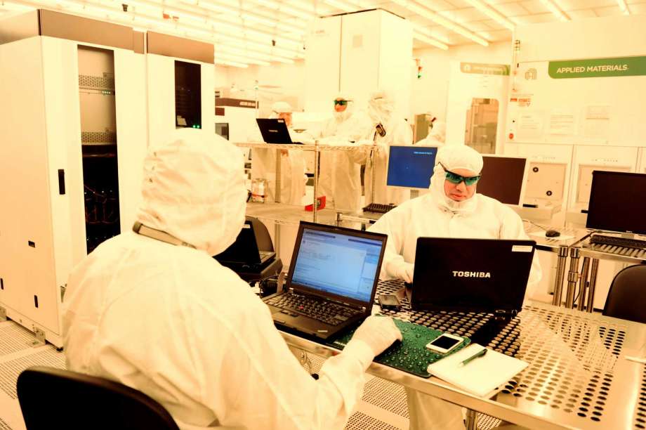

The 1980's super-sterile cooled (read freezing) rooms where computers were housed. Chilled to my bones just recalling those freezers.
