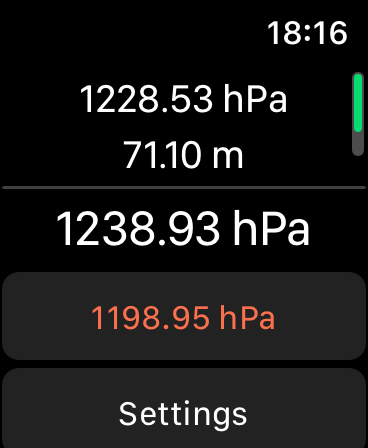

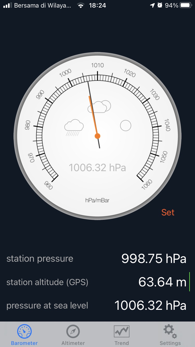

Just started having the same problem as you guys. I love to hike, so I used the barometer app in my AW4. Normally there was no difference in pressure of my AW4 and IP7. It's normally about 1010 hPa (atmospheric pressure). But from this month, my AW4 showed 1200 hPa and my IP7 still is around 1010 hPa, as shown in the attached figures. 200 hPa difference here is like my AW4 is 2 meters underwater! And my average Flights from the Health app showed I climbed 700 floors last week.
The good thing is the altitude (60-70m) indicates about the same as before. Maybe, the AW4 just needs a calibration.
Does anyone here know how to disable the AW4 barometer, or at least make the Health App stop reading Flights data from AW? It's really annoying.

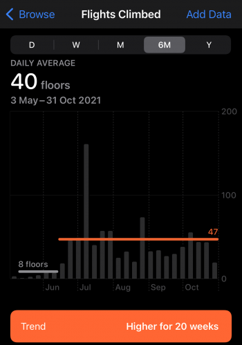

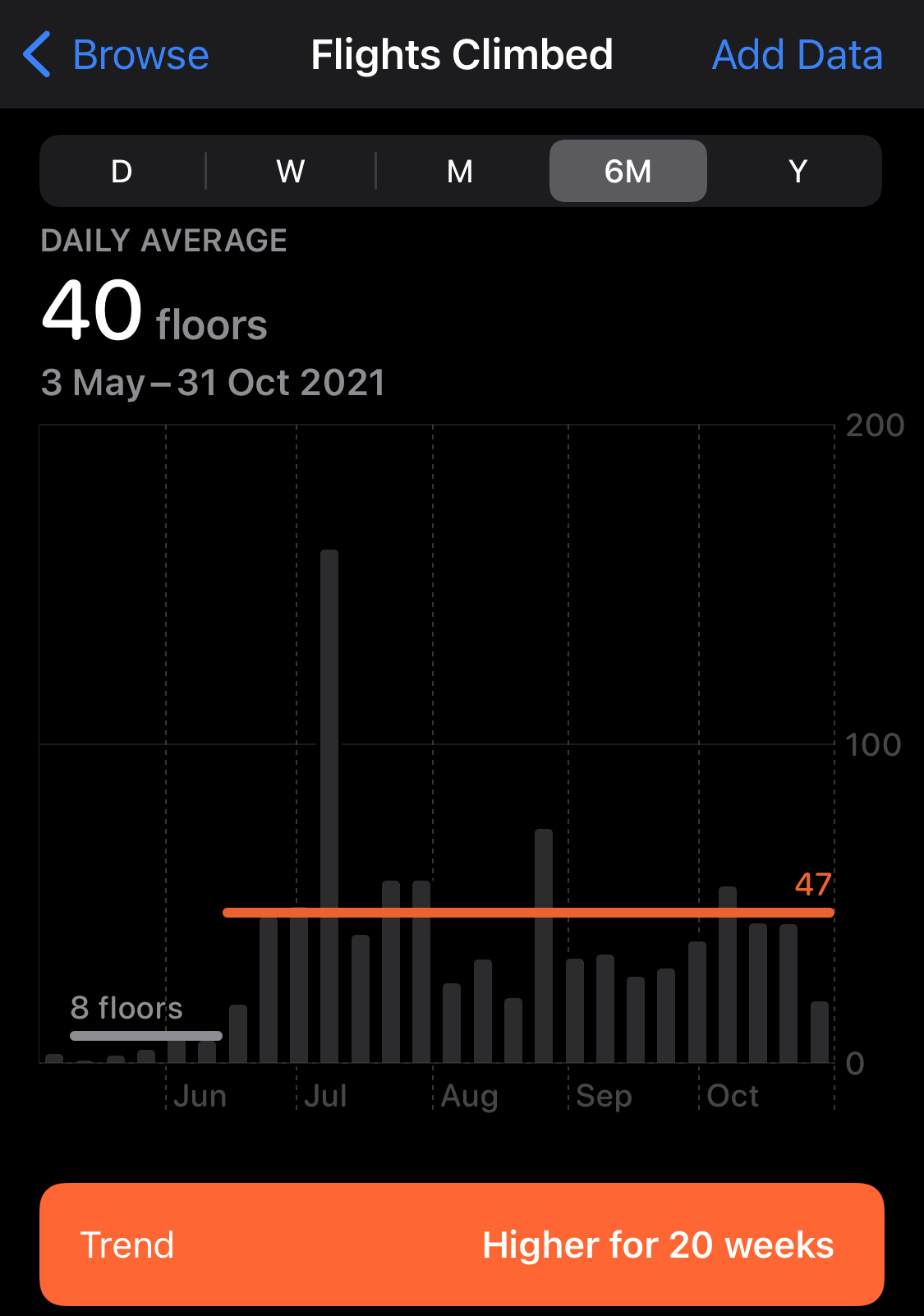

Same issue, starting June/July 2021 (around the time we moved to 7.5 watchOS version) my AW4 started counting way too many flights per day from an average of 8 to a current average of 47 🙂 My AW4 is out of warranty so I will have to live with it until I buy a new version next year. I read that some water trapped in the watch might be the culprit, it is possible the hermetic seal around the AW4 is flawed.
