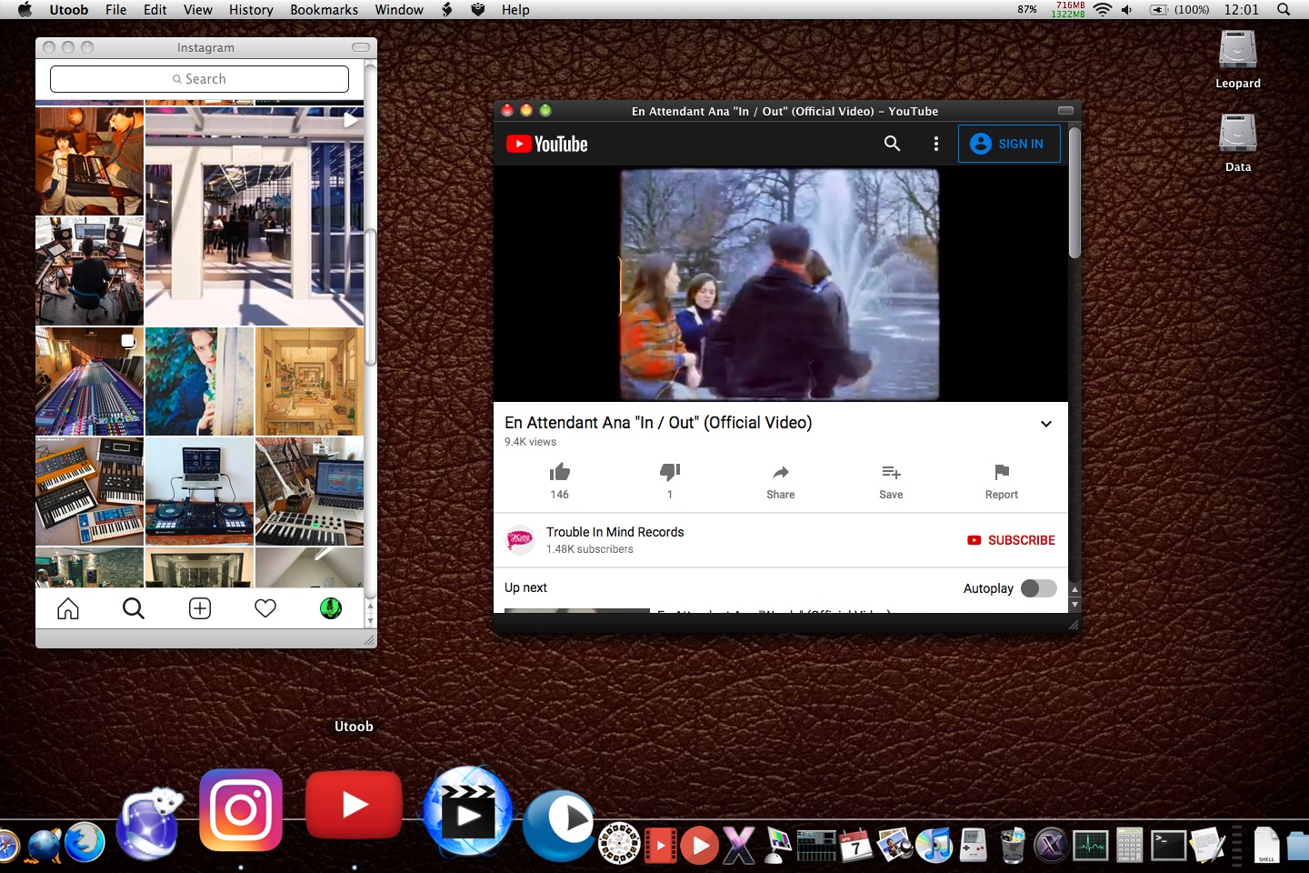

Quick FYI - on my Powerbook TenFiveTube is no longer working for most videos I browse to and although my preferred Youtube app is SMTube, it's always good to have other options. So, Fluid to the rescue again with a Leopard Webkit linked app using an iPhone 7 UA:
Mozilla/5.0 (iPhone; CPU iPhone OS 10_2_1 like Mac OS X) AppleWebKit/602.4.6 (KHTML, like Gecko) Version/10.0 Mobile/14D27 Safari/602.1
This plays 360P with ease but can also be dialled back to 240P too.
And another win for Fluid - on my Intel Macs there is no way to fully reach Instagram ie retain video playback but with Fluid on Leopard and again, an iPhone 7 UA it works fine...
I've tried a few that TFT wouldn't play and they work fine. There is some weirdness going on with Youtube at moment - I've even had Safari on Tiger being able to play some videos!

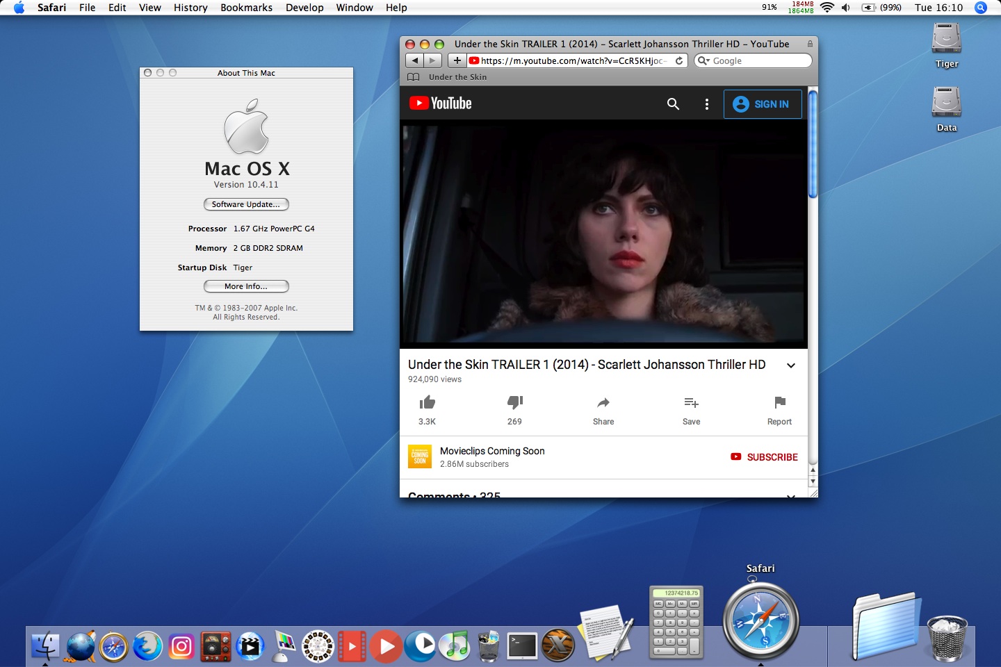

I don't think that's the reason. This only works with one specific UA and furthermore if you bookmark a video that plays, it won't play from the bookmark, only from searching for it again. I've checked against youtube-dl and the videos that do play are presented in the same formats as those that don't..to further mix it up the age of the video isn't relevant either!

Just to be clear, my reply you quoted was about Safari on Tiger, not the Fluid app.
On Tiger, this is the UA that produces sporadic results:
com.google.android.youtube/5.3.32 (Linux; U; Android 4.0.3; ro_RO; GOCLEVER NETBOOK R103 Build/IML74K) gzip
Like so...

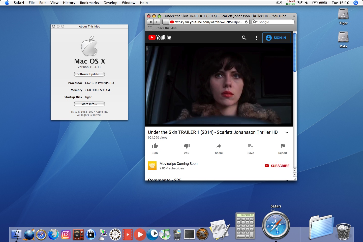

Like so...
