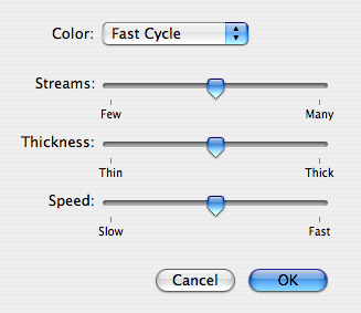

Do you see these lines constantly? Or only every now-and-then?
