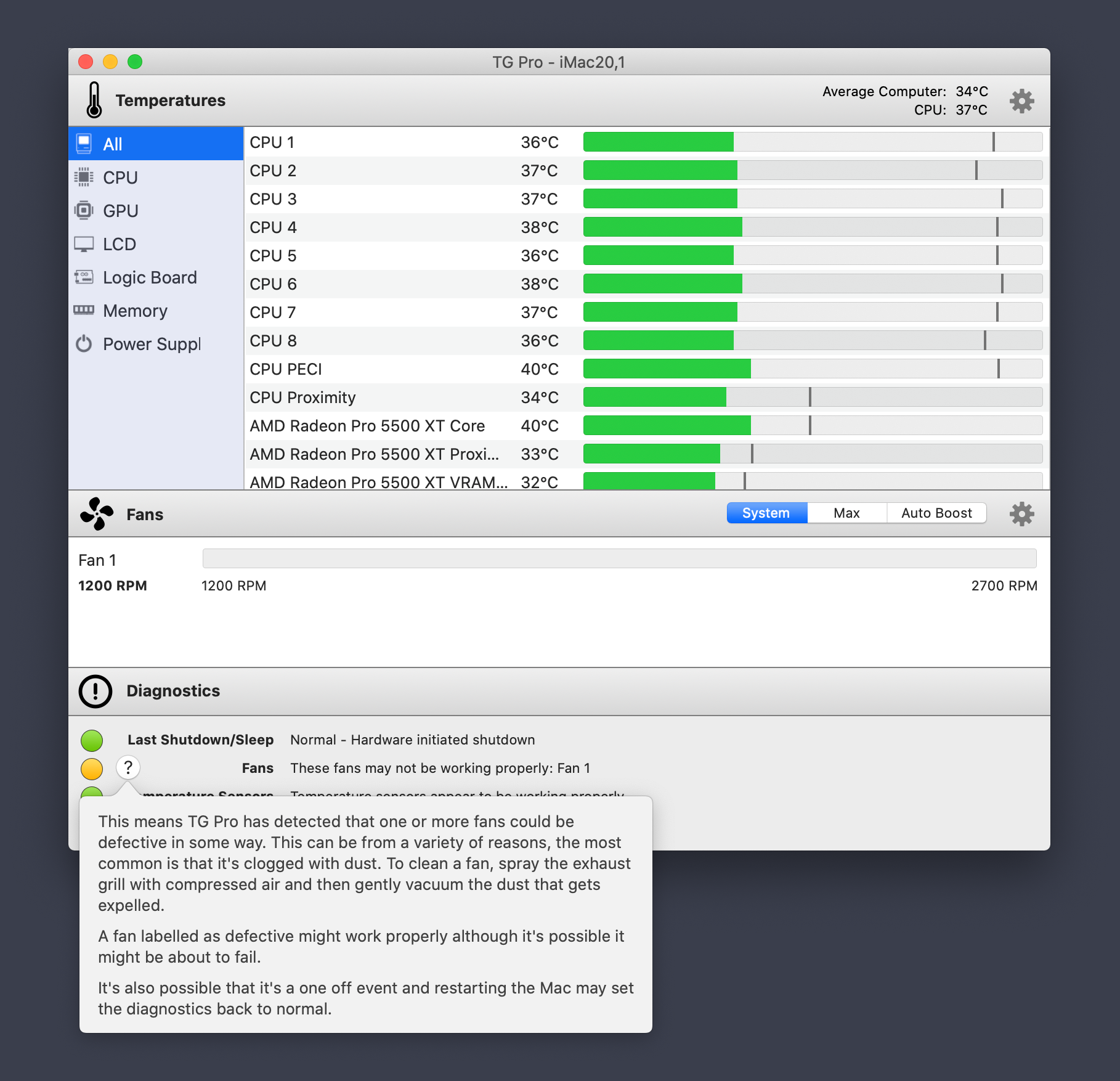

So this is interesting, I am now getting this notice in the TG Pro app.
Apple Diagnostics still shows no issue.
