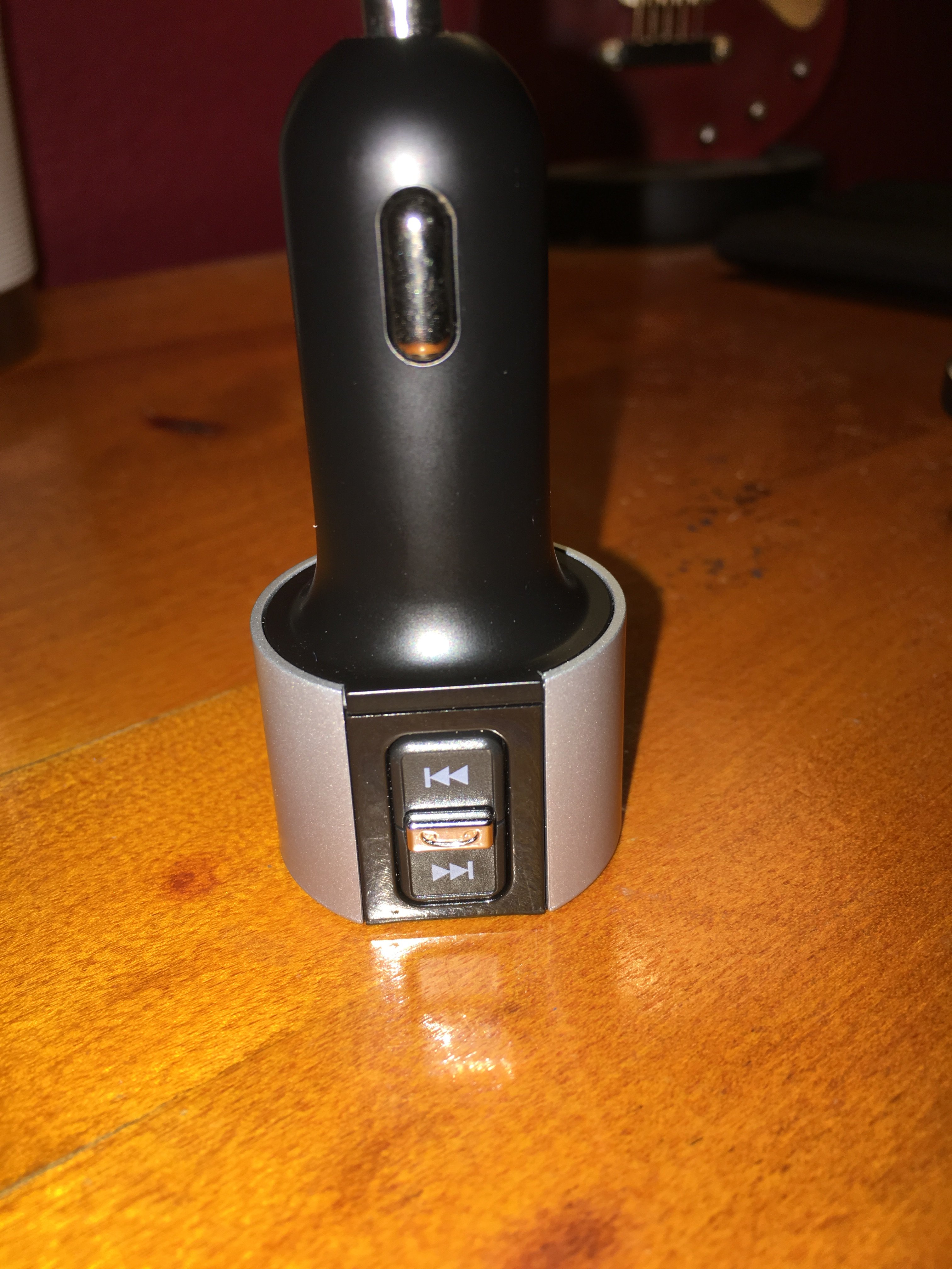

Hey guys, so i just bought a FM transmitter online for my car, and I cannot figure out how to connect it to a FM station. Any clue? I included a pic below, thanks!

Generally,
1) You need to pair the FM transmitter with you audio device.
2) Set your radio to a FM frequency number that isn't being use by a radio station. Just static is good.
3) Set the FM transmitter to the same number.
4) Play music on your audio device and the sound should go through your radio speaker.

Looks like it only has 3 buttons, phone, back and forward. I would assume the back => Frequency lower and forward => Frequency higher.
There was one, but it really doesn’t help. Just a brief summary about the transmitter, and showing some buttons. None told me how to set my transmitter to the stations.
The forward and back buttons probably change the frequency up and down after you press some other button on the device to put it into a "frequency select" mode. That's how the last two I've had work.
I got a similar looking one, similar form, and you use the forward back button to change /set the FM output on the transmitter, then you tune the FM to the same frequency - but it has a numerical read out on the front (which we can not see if yours has in the photo). I think the middle button (call button on mine) acts as a toggle of there is an extra CH button, maybe that did it. I did not read any institution, it was fairly intuitive.
What I also had to do was find spot on the FM range and that took about 3 tries to get one with the least amount of background hiss or interference from some other more powerful transmitters (radio stations).
