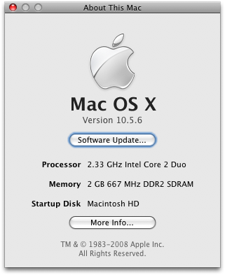

I am trying to capture this footage in Hd. The capture window keeps freezing when it is processing the footage. What can be wrong?

Yep, that's 400. Are you capturing though a tape deck or cable from your camera? If it's the tape deck I would try to get a FireWire 800 cable or if your camera has a 800 port. What is the HD resolution (1080x1920 or 720x1280) you are capturing in and what do you have in Easy Setup? It could be that the 400 isn't fast enough so it's freezing up and "dying"😱.

I am capturing straight from my camera. My easy setup is on HDV-Apple Intermediate Codec 1080i60. Im not sure what the HD resolution is but i believe its 1080x1920.
OK, those settings sound good. I think your problem is the slow cable. Does it display a dropping frames error message wen it stops or just what's in the screenshot?
Well right when i hit capture it will start lagging...and it would say how much % its lagging with the monitor. But i have not seen an error..it would just freeze and i would have to do a force quit. I dont see why it would be the cable because it was not like this before.
