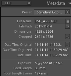

I don't know if you can do it under the histogram, but if you choose EXIF in the drop down menu in the metadata panel in the library module you'll get the focal length in 35mm equivalent lengths. Not what you're asking for, but at least you can get at that info somewhere!

In the Library module, look under the Metadata tab. It has a drop-down menu with different options, one of which is EXIF.

Hmm. I think you may be right about that. I just looked at what it said for my cameras, and the "Focal Length 35mm" bit isn't listed.
