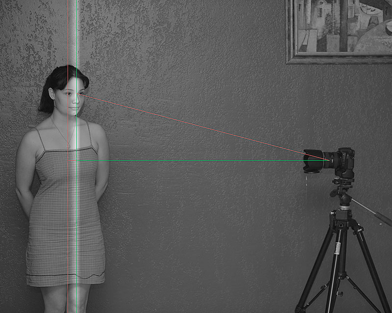

Anyway, I found this informative piece on the potential issues related tousing the center focus point and recomposing the shot...
http://visual-vacations.com/Photography/focus-recompose_sucks.htm
Here's the jist of it...
In this example, the correct distance setting is 6.456 feet, represented by the horizontal green line. If the camera is reoriented so that the center AF sensor focuses on the correct spot between the subject's eyes, focus distance will be set at 6.679 feet, represented by the diagonal red line. This will result in the focus distance being set 2.676 inches farther out than the correct distance, which means that when the camera is tilted back to achieve correct framing, the center of focus will be along the vertical red line instead of the vertical green line where it belongs. If the camera was tilted up by tilting the tripod head back, the error would be increased another few inches, since the camera would be moving away from the subject an additional few inches as it was tilting up. The setup pictured above would approximately double the focus error amount previously mentioned. Your mileage will vary, depending on the configuration of your tripod head.
Good stuff. From now on, I will definitely try to avoid this technique with shallow-depth of field shots.
the center point is always the most accurate (or has the potential to be) since it receives the most light. the outer points are usable, but the reliability suffers, especially with single-line points on the 5D, 20/30D, and consumer (Rebel) cameras. they are fine with stationary subjects but aren't generally used in fast-moving action. you also have to pay attention to the contrast lines and make sure the AF line is perpendicular to the contrast line.
generally, it's best to use the center AF point, but as you found out, at close distances that isn't the best option. so for things like portraiture or macro, you either use the nearest AF point or focus manually.
