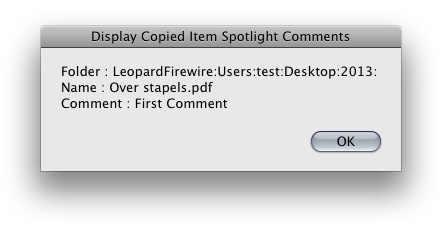

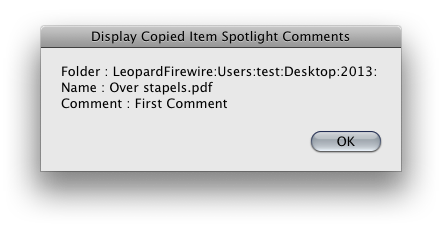

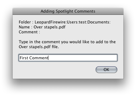

Can you try this script. Run it from Script Editor.
Code:
set these_items to choose file with prompt "Choose file you wish to comment : " with multiple selections allowed without invisibles
repeat with anItem in these_items
	tell application "Finder" to set {theComment, theContainer, theName} to {comment, container, name} of anItem
	if theComment is "" then
		set theNewComment to text returned of (display dialog "Folder : " & theContainer & return & "Name : " & theName & return & "Comment : " & theComment & return & return & "Type in the comment you would like to add to the " & theName & " file." with title "Adding Spotlight Comments" default answer "" buttons {"OK"} default button 1)
		tell application "Finder" to set anItem's comment to theNewComment
		set theDestination to (choose folder with prompt "Copy " & theName & " to : ")
		tell application "Finder" to set theCopiedItem to duplicate anItem to theDestination
		tell application "Finder" to set {theCopiedComment, theCopiedContainer, theCopiedName} to {comment, container, name} of theCopiedItem
		display dialog "Folder : " & theCopiedContainer & return & "Name : " & theCopiedName & return & "Comment : " & theCopiedComment with title "Display Copied Item Spotlight Comments" buttons {"OK"} default button 1
	else
		display dialog "Folder : " & theContainer & return & "Name : " & theName & return & "Comment : " & theComment with title "Display Current Spotlight Comments" buttons {"OK"} default button 1
	end if
end repeat
