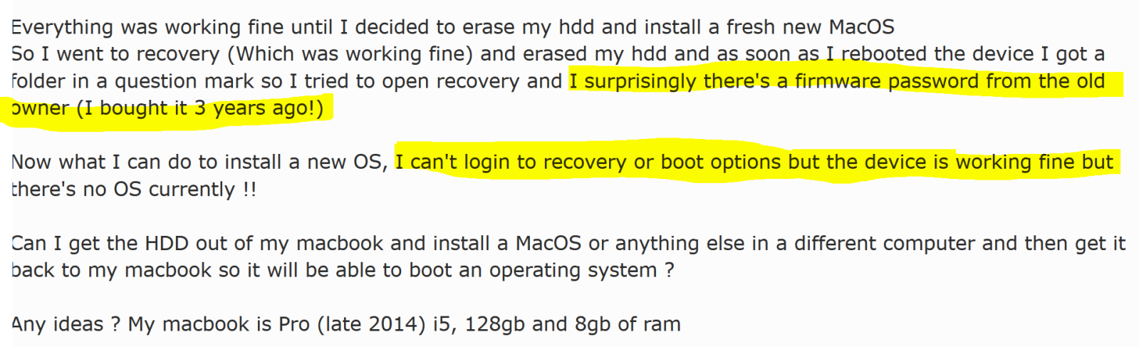

Hello Guys,
Everything was working fine until I decided to erase my hdd and install a fresh new MacOS
So I went to recovery (Which was working fine) and erased my hdd and as soon as I rebooted the device I got a folder in a question mark so I tried to open recovery and I surprisingly there's a firmware password from the old owner (I bought it 3 years ago!)
Now what I can do to install a new OS, I can't login to recovery or boot options but the device is working fine but there's no OS currently !!
Can I get the HDD out of my macbook and install a MacOS or anything else in a different computer and then get it back to my macbook so it will be able to boot an operating system ?
Any ideas ? My macbook is Pro (late 2014) i5, 128gb and 8gb of ram
