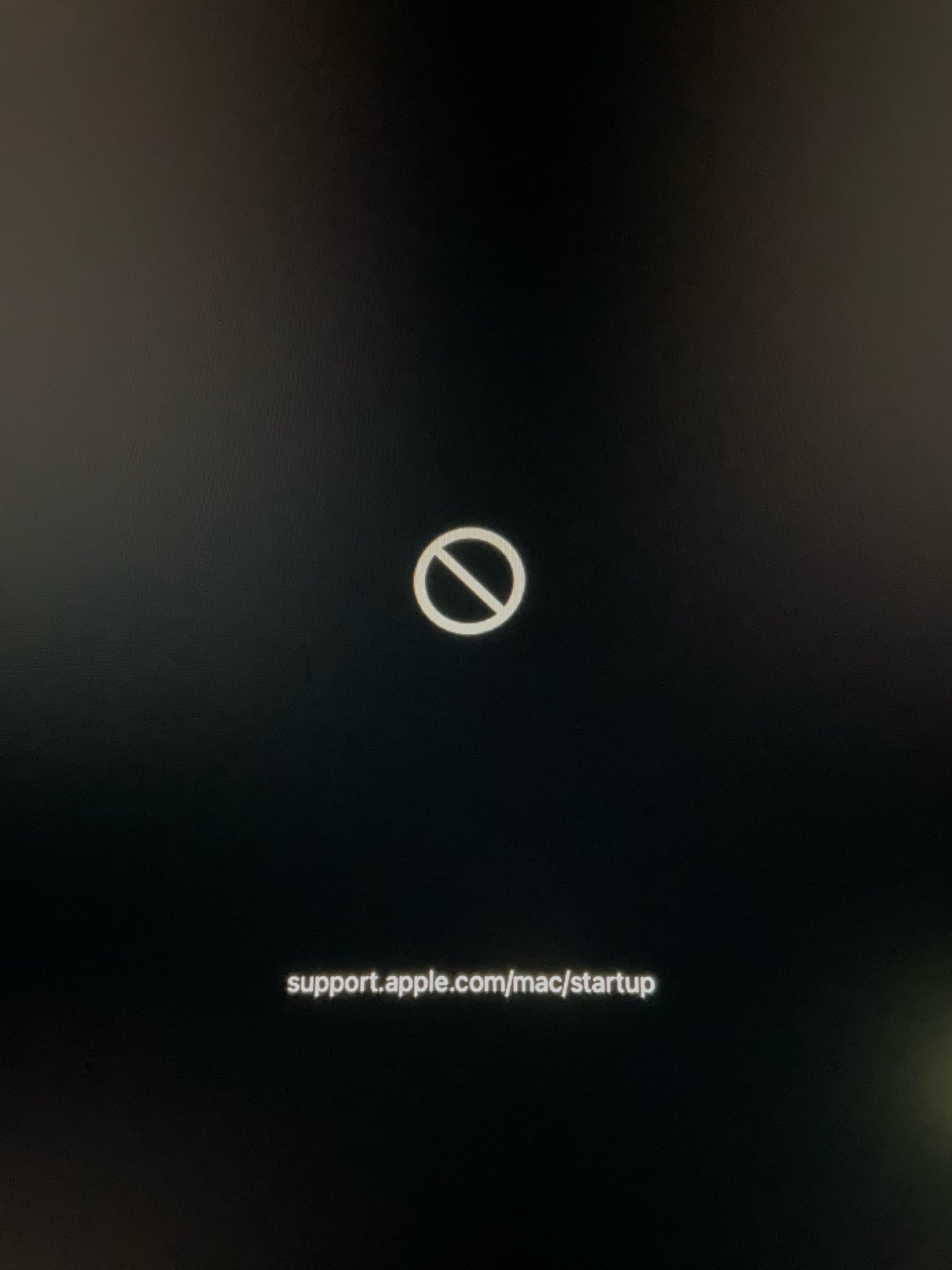

Sadly OS does not install to external Fusion.
Tried FROM both Ventura & Monterey, to install both Ventura and Monterey.
