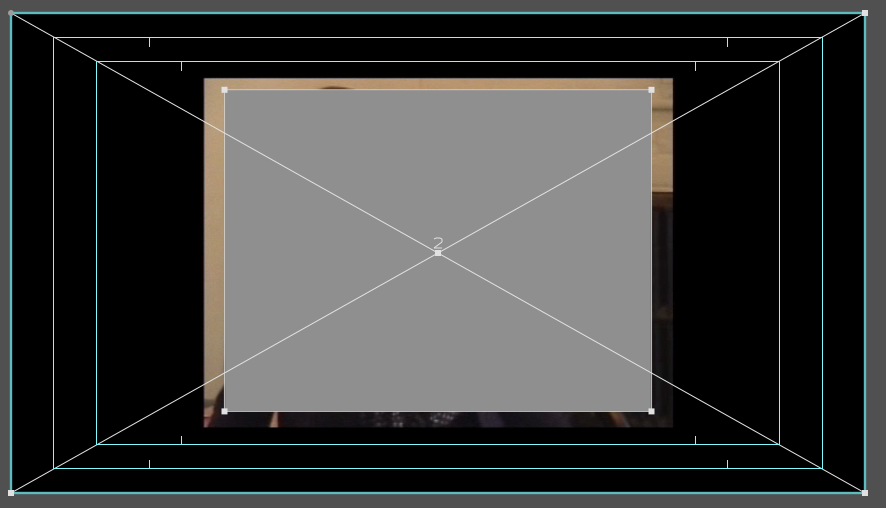

My client handed me SD 4x3 footage in a 16x9 format (see pic). It came off of a DVD - and when we reviewed the footage together on my TV, it had this issue.
The image on it is 4x3, therefore there are black bars on top, bottom, and on the sides of their footage. I mentioned it to the client. See attachment for how it looks. Note: I put a grey matte over most of the image on purpose for privacy reasons on this forum (that was intentional)
Now that I've cut the project, the client is upset that there are black bars around the image completely, and thinks they gave me footage that was full frame 4x3.
I tried putting the image in a 4x3 timeline, but as you can guess, it's even further letterboxed - so it's actually smaller.
I've asked for the source footage if available (so footage before she put it on DVD), but I'm not sure it is. .
Anything else I can do - I thought about increasing the size by 10% in Final Cut?
I can't think of anything else. PS: I captured the DVD footage with MPEG stremclip (DV NTSC setting, 100% quality).

Haven't got final cut handy but if you double click the clip and go to the distort menu using a combination of this and the scale option you should be able to get the footage to fit within a 4:3 timeline.
Alternatively scale up the footage in a 4:3 timeline and crop off the black bars.
If this works then copy the clip Apple+C and then using Option+V you can paste the attributes to all the other clips.
In the future I would recommend always getting the footage to fit nicely within the timeline before you start the edit!
Does the DVD play with a widescreen image, or is it always a box of video inside black? I've seen some footage display incorrectly when settings on the DVD player don't match up, so if there are any playback options you can check, it might shed some light.
That footage looks like definite 4x3, so I'd say you need to work in 4x3 timeline. They must have burned the DVD as widescreen by accident, with 4x3 footage.
Assuming there is no possibility of getting the original footage (that was used to create the DVD), your only option seems to be scaling it up to fit the intended screen, which seems to be 4x3. Unfortunately, quality is going to suffer, but without that original footage, you're stuck.
