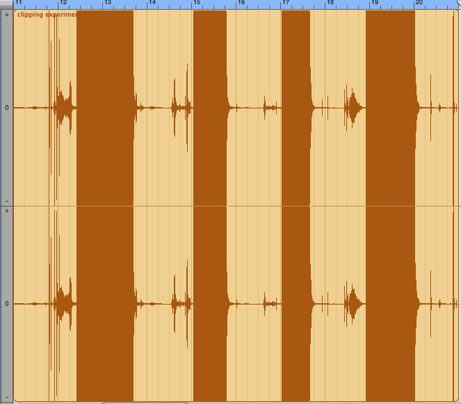

As far as monitoring levels in terms of actual deciblels, -36 - -18 averages as you say, I am not sure that I have anything that I can do that with. Check out the attachment of the Garageband meter below (a silly experiment I was doing involving clipping, FYI.) It only says "-" or "+" with telling you how much - or +. I can assume that the celing is of course "0db" but not sure where I would be other than that. Unless I know what decibel is represnted by absolutely no trace of sound. Then I could gage I guess said averages. A long as it is linear I suppose.

what you want to look at is (if it exists) the LED meter next to the fader. does GB have one?
what you're looking at in the attachment can show you when the waveform is clipping, but that's different from the channel or mixbus clipping. it gets confusing, i know, but here are the 2 things to watch out for:
1. for each track, you want to ensure the waveform doesn't clip. if it does, the digital->analog converter will produce a nasty sound.
2. when all those waveforms are added together so you can hear it as a song, you don't want to run out of headroom on the mixbus. i'm not terribly familiar w/ DAW math, but my experience is that when you try to mix together too many hot signals, the overall sound gets small.
