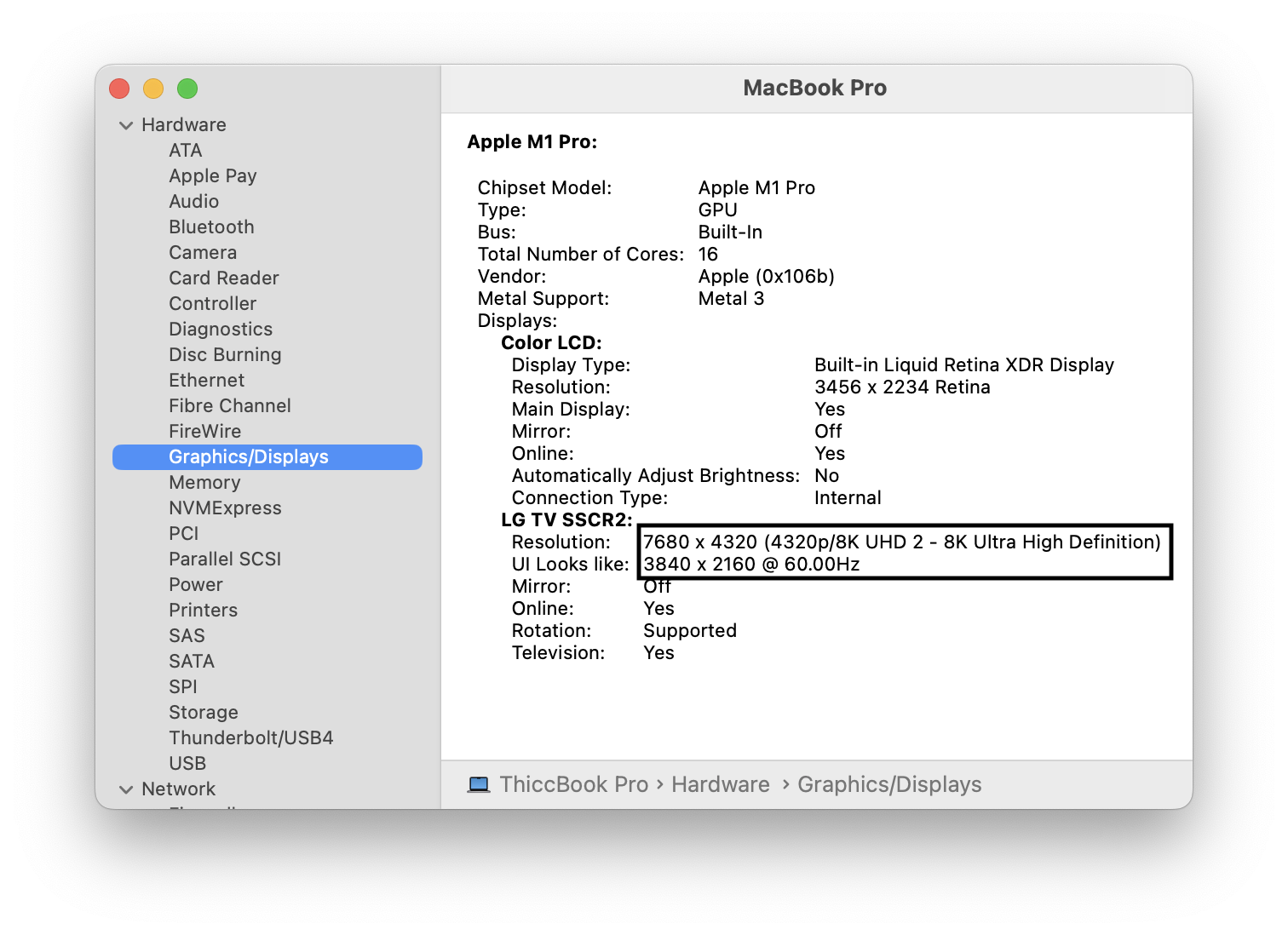

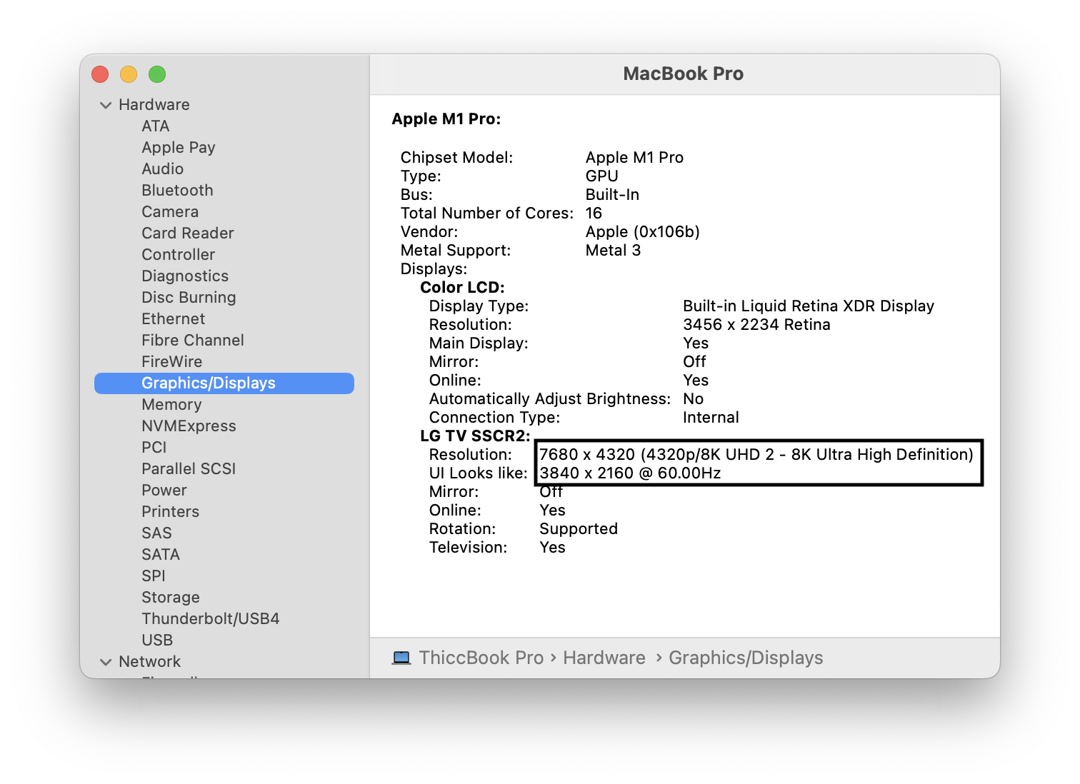

Here are the resolution details for my machines connected to a 42" LG C2:
MBP M1 Pro connected with flashed USB-C adapter:

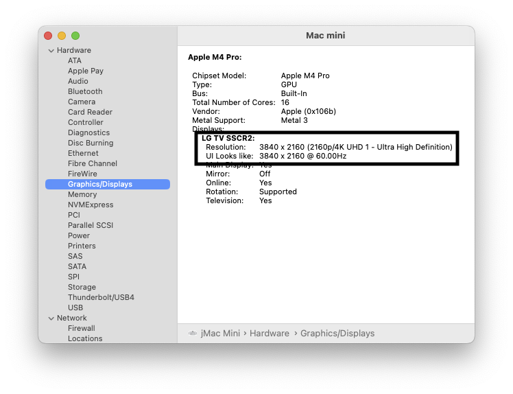

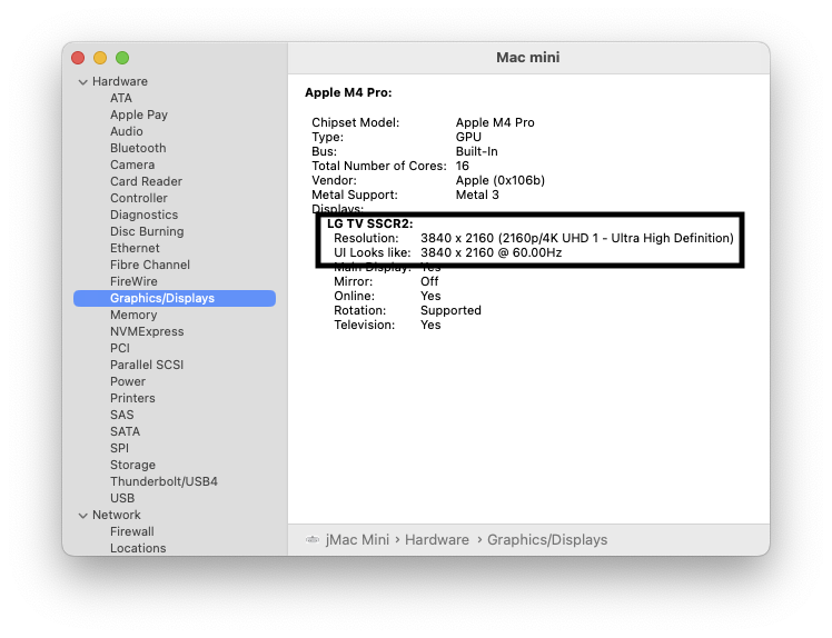

An here's the M4 Pro mini connected to built in HDMI 2.1:
Technical details below. Thanks @waydabber for the investigation and information. Please correct anything I got wrong.
8K@60Hz and 4K@120Hz and 144Hz worked fine using the built-in HDMI port. However HiDPI resolutions are strangely fluctutaing/limited based on the display configuration (running 15.1) indeed, (both using HDMI and USB-C). The reported GPU horizontal limit is 3840px HiDPI (which is an improvement for entry level Macs) but similar to how refresh rates are limited in the display mode list for some models, resolutions seem to be limited as well. This is not entirely new as the same is the case with my older M2 Max Studio over HDMI with some displays interestingly (where the normal mode list contains no options beyond 2560px HiDPI on a 4K HDMI display while the machine should not have a limitation like that). So there is an extra logic that seems to limit HiDPI scaled resolutions below what the system is clearly capable to do.
(note: HDR resolutions are also limited with high refresh rate in the same manner as on older systems).
The M4 can also output 4K@120Hz (can do it up to 240Hz actually) just fine, but HiDPI resolution still seems to be limited at 3072px horizontally (for all refresh rates) for 4K displays for some reason. Obviously this is not the case when I connect a 8K display over HDMI (like a Samsung 8K TV) - in this case the mini has no issues going up to 3840px HiDPI horizontally, since this is needed for a proper 8K output. Also, the horizontal GPU limit according to the ioreg framebuffer entries is 3840px horizontally which is an obvious increase from the previous 3072px for entry level macs, so the limit in display mode list is clearly artificial...
If I add a 8K@30Hz timing, the HiDPI resolutions all the way up to 3840px horizontally appear - however the scaled resolution base (native resolution) will also be 8K which a 4K obviously can't handle. Sadly if I override the native resolution to be 3840x2160 again, the higher-than-3072px modes simply disappear from the mode list (even though the 8K mode is still available in the low level connection mode list and can be triggered, so the Mac parsed it from the EDID all right).
So all in all this seems to be a software limitation. I see no way around it now.
