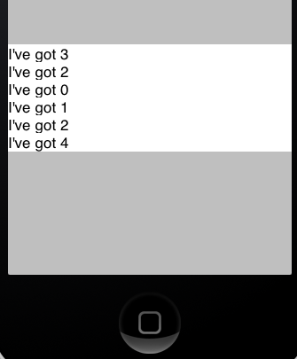

Hi guys,
I set the 'for' statement to loop for 10 times but i'm not getting 10 loops. Sometimes it returns 6, at times it returns 4,3,7 etc. Only rarely did i get 10 return during runtime.
Code:
int y_axis = 200;
    for (int q = 0; q < 10; q++) {
        int rand = arc4random()%10;
        if (rand == 0) {
            NSString  *msg = @"I've got 0";
            UILabel *label  = [[UILabel alloc] initWithFrame:CGRectMake(0, y_axis, 320, 21)];
            label.text = msg;
            [scrollView addSubview:label];
            [label release];
            [msg release];
            y_axis = y_axis + 20;
        if (rand == 1) {
            NSString  *msg = @"I've got 1";
            label.text = msg;
            [label release];
            [msg release];
        if (rand == 2) {
            NSString  *msg = @"I've got 2";
            label.text = msg;
            [label release];
            [msg release];
        if (rand == 3) {
            NSString  *msg = @"I've got 3";
            label.text = msg;
            [label release];
            [msg release];
        if (rand == 4) {
            NSString  *msg = @"I've got 4";
            label.text = msg;
            [label release];
            [msg release];
I've attached the screenshot of the output along.
Thanx in advance...

Something you could have easily avoided with much simpler code :
Code:
int y_axis = 200;
        NSString  *msg = [NSString stringWithFormat: @"I've got %d", rand];
        label.text = msg;
        [label release];
        // We shouldn't be doing this anyway : [msg release];
        y_axis += 20;
Or something you could have found out using the debugger (doesn't anyone use the debugger to step through code anymore ?).
Also, why are you releasing msg ? You haven't allocated anything, it's pointing to a string literal...

ok let's so simplify things shall we?
You can format a string like you would printf, in this case let's use %d to insert an integer (read up on this it happens ALOT), now we don't need a million if statements.
Second, only release an object that you explicitly retain/copy/new. For example
Code:
  MyObject *mObject = [[MyObject alloc] init];
  // do something...
  [myObject release];
Code:
  MyObject *mObject = [myOtherObject copy];
  // do something...
  [myObject release];
And I've never actually used new so I won't give an example...
On to the code at hand, try this...
Code:
int y_axis = 200;
    NSString  *msg = [NSString stringWithFormat:@"I've got %d",rand];
    label.text = msg;
    [label release];
    // as mentioned, not needed only release abc exits you init/new/copy
    //[msg release];
    //y_axis = y_axis + 20; try this instead
    y_axis += 20;
