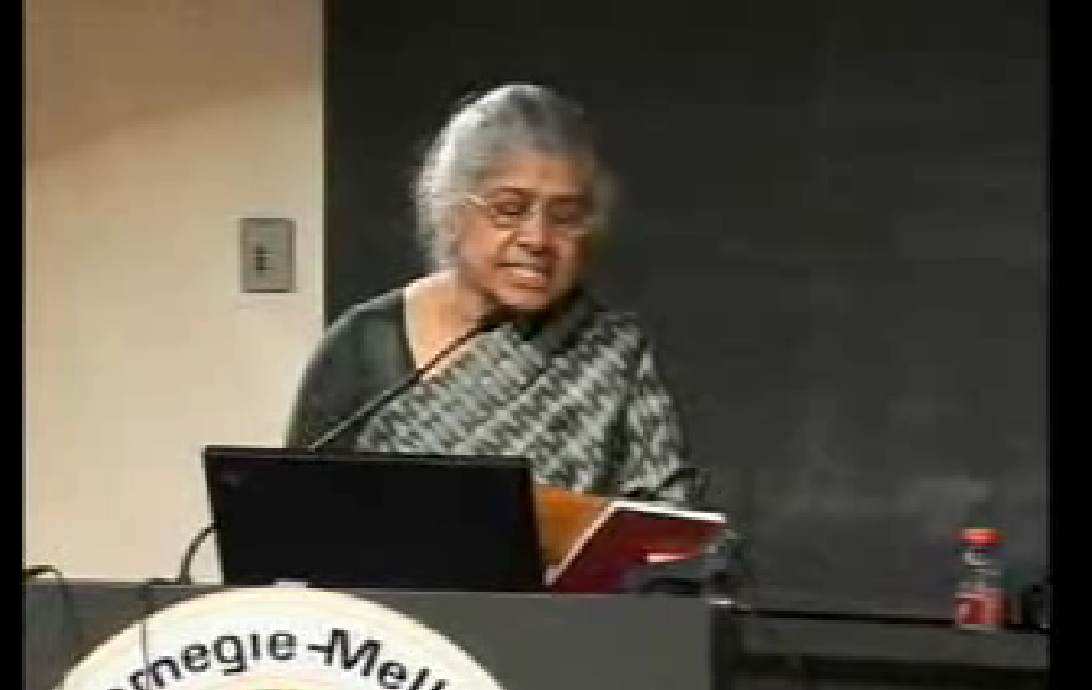

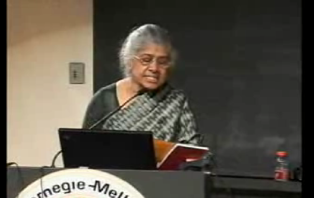

Here's a screen-shot I grabbed from the full screen playback, you can see the pixelization of the image. I think it's has more to do with the video stream's quality than with the graphics card.

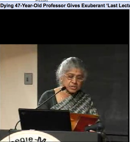

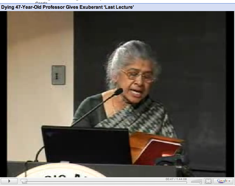

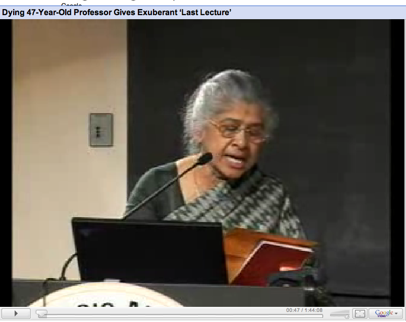

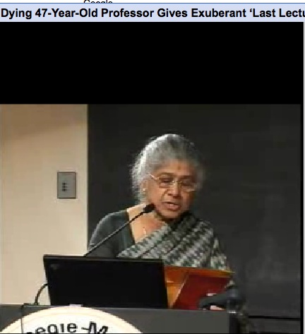

Plays fine on Penryn 2.4GHz Macbook Pro with NVIDIA 8600GT 256MB. Only issue is quality of video.
