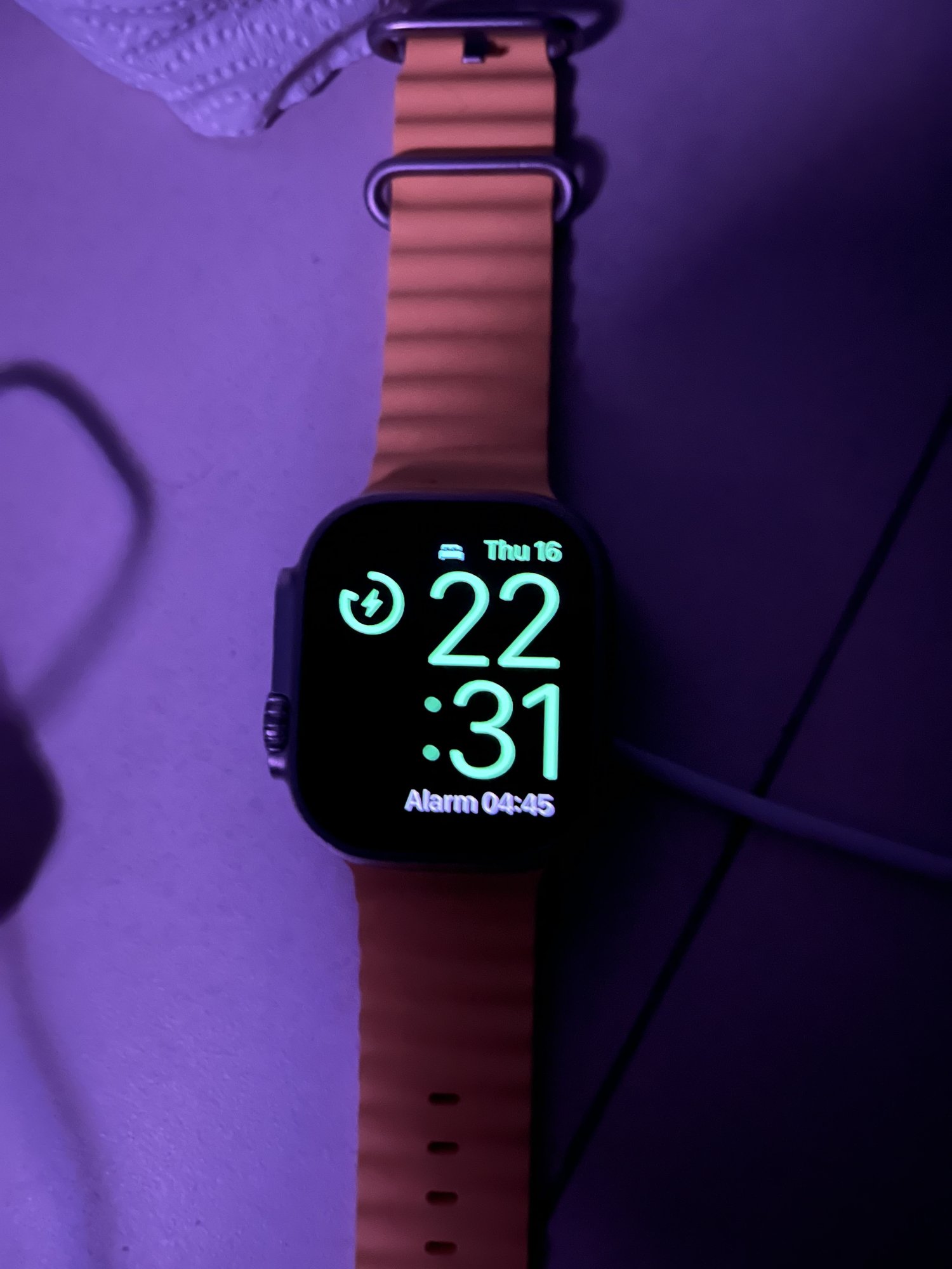

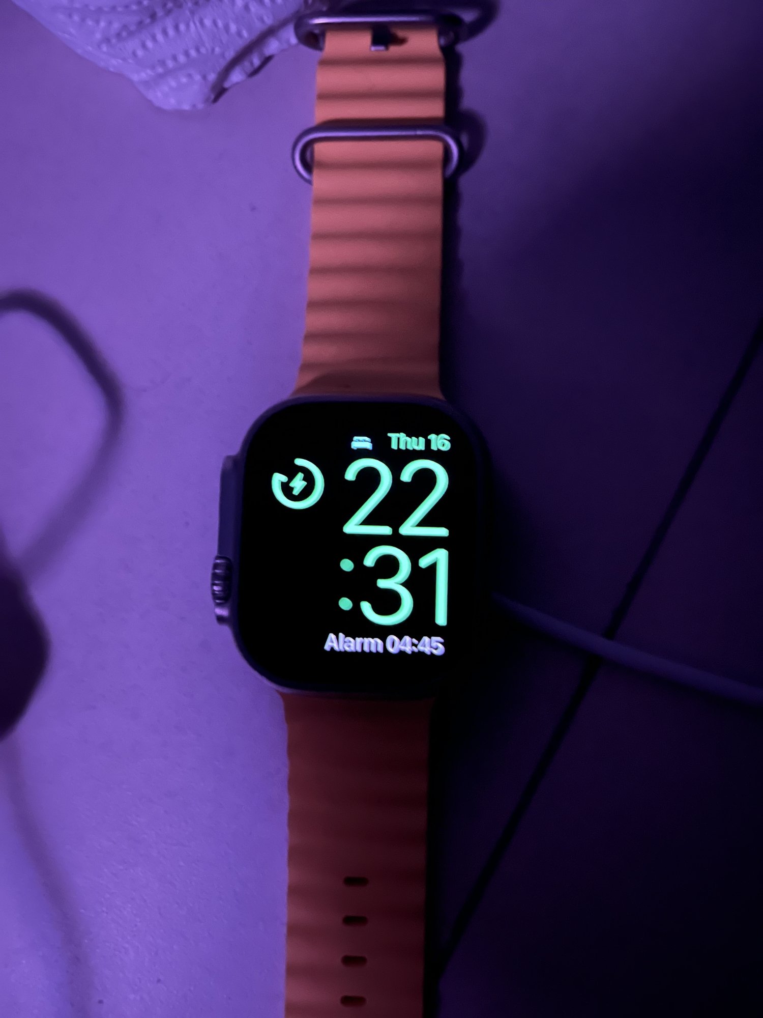

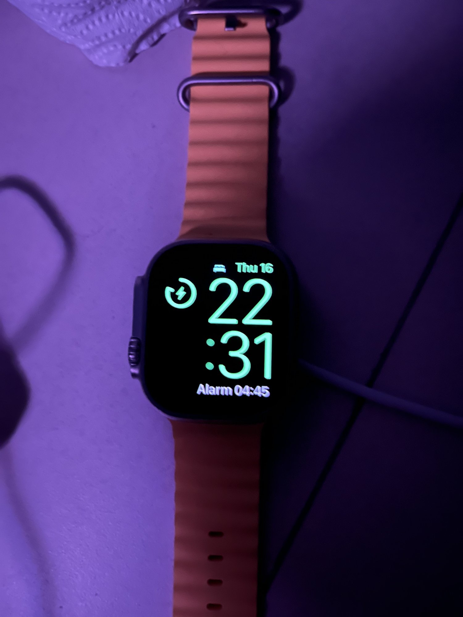

I have the same issue than the one described.
My Watch Ultra 1 offered me this “option” perhaps 5 times since I have it (Oct 2022).
Usually, and even if “Optimized battery” is on, it charges my Watch Ultra up to 100%.
Weird…

What I thought too… Until yesterday night… Same bedroom as usual…

I charge my Watch Ultra every evening at the same time. I’ve seen this feature 5 times I think since I got it (Oct 2022). The last occurrence was 2 days ago. Now, no more. Perhaps a feature which appears from time to time to calibrate the watch?
Fun fact. Since my first message, my Watch Ultra is charging only at 80%, as it was supposed to do...
I’m happy with this as I charge it every evening before sleeping...
