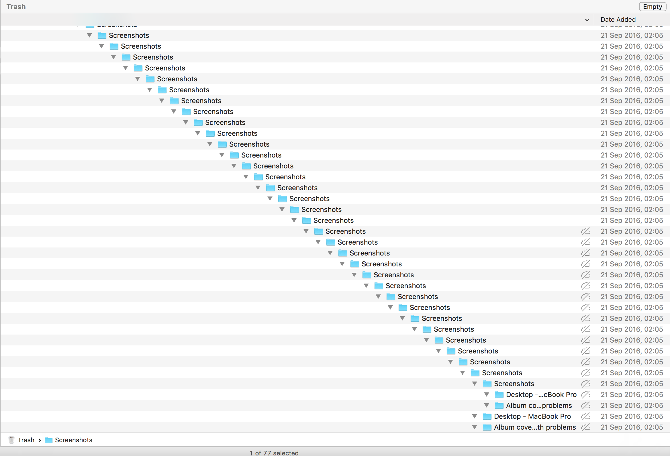

So I have tried all the suggestions here and just cannot get rid of a folder in my Trash. I have no idea why it has ended up with all these embedded folders, it must be some sort of glitch. When I try the terminal commands I get 'file name is too long'. Anybody got another idea?
See that little cloud to the right of some of the files at the bottom? I think that is from having iCloud Drive's Documents and Desktop sync on and I wonder if that is holding things up. Try going into iCloud settings and turning that off then empty trash.
You were right. Logging out of iCloud seemed to take care of it.
Cheers.
