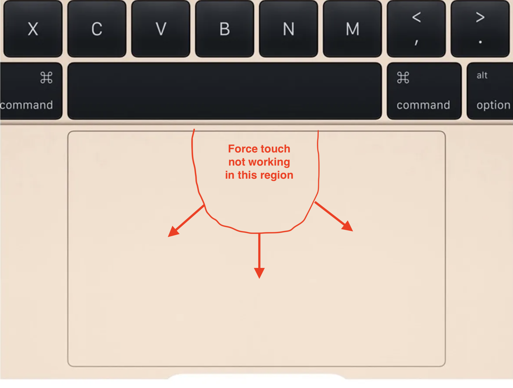

I've started to notice that the trackpad is intermittently misbehaving.
Immediately upon waking the machine (opening the lid) all trackpad features work as expected.
But, after a little while the force touch gesture begins to malfunction.
To be clear, by "force touch" I mean that second haptic click you feel after you push a little harder after the initial haptic click.
Initially, the force touch gesture malfunction is focused to the area near the top edge of the trackpad (nearest the space bar), between the B and N keys. See the attached annotated graphic. Over time, the area/region of malfunction begins to expand outwards (left, right, and down). But, there are still areas near the far left, far right, and far bottom, where force touch does still work. The condition seems to get worse with rising temperature (for example watch videos the machine will get noticeably warmer). As even more time passes, and temperature rises more, even the initial haptic click (let alone the force touch) no longer works in that region.
Has anyone else encountered this?
How did you fix it?
Was it a matter if physically disassembling, and cleaning?
Or just a matter of failed trackpad electronics, that needs to be replaced?

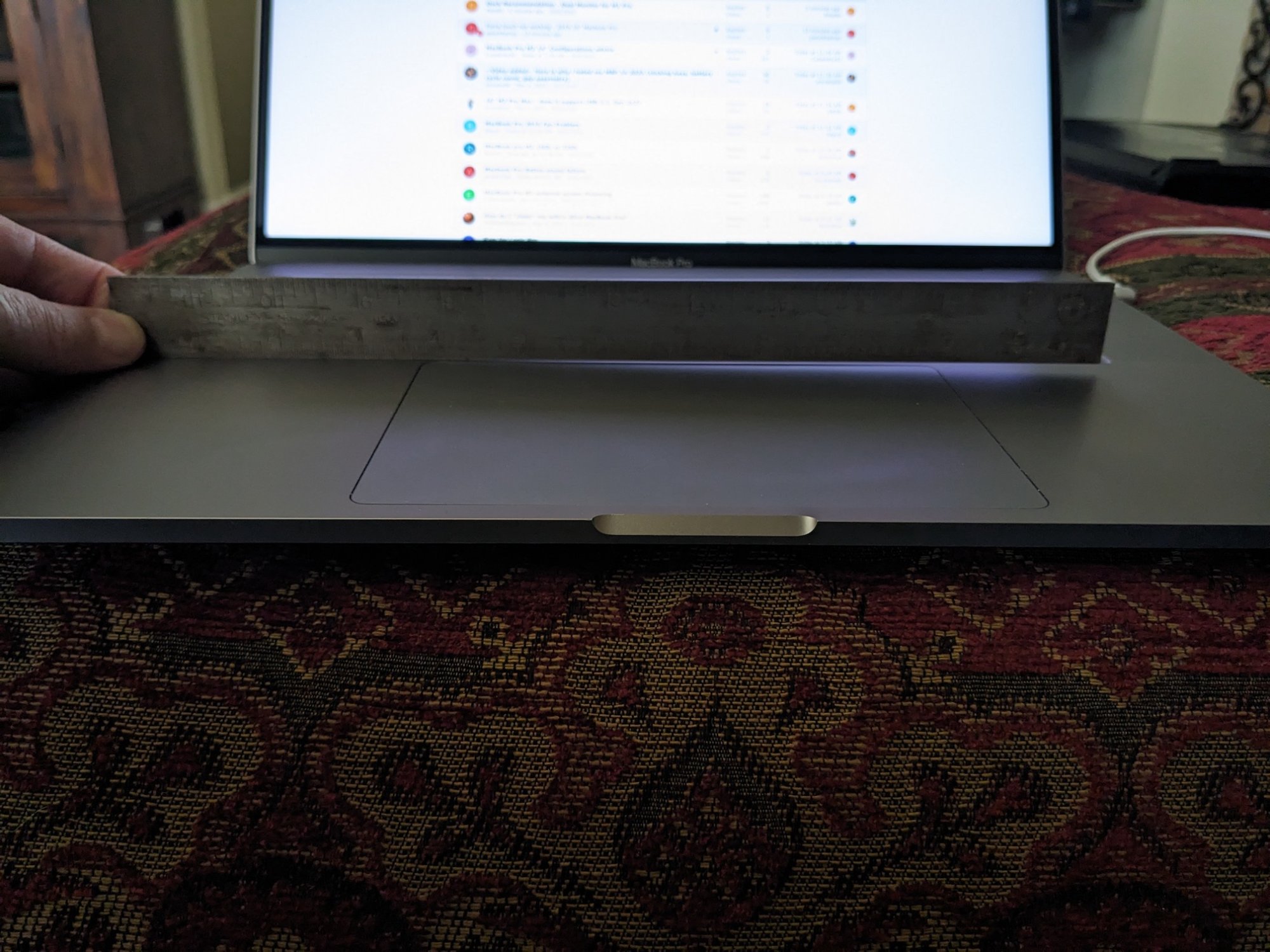

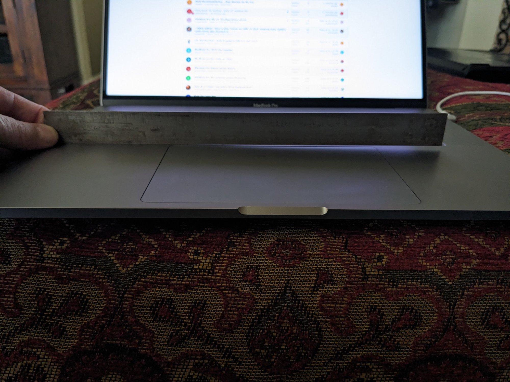

I think I figured out what's going on here... the battery is swelling. And as the system warms up the swelling becomes more pronounced.
I set a straight edge across the top case, just below the space bar... lookie there, the top case is bulging.
The swollen battery is interfering with the operation of the touchpad's strain gauges. So, they can't detect the force being applied when I push on it with my finger. Thus, the force touch gesture is not being recognized. Doink 😳
Crap... I guess I'll be putting a new battery in this machine.

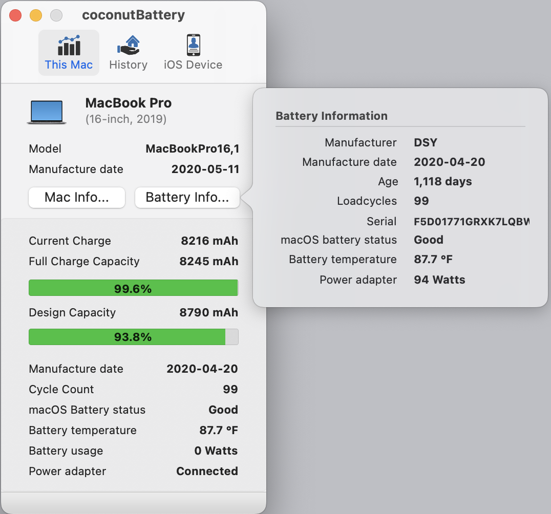

For historical reference, here is a screenie of the battery details, as reported by coconut.
As seen here. The battery is almost exactly three years old. And a cycle count of 99. Pretty light duty IMO.

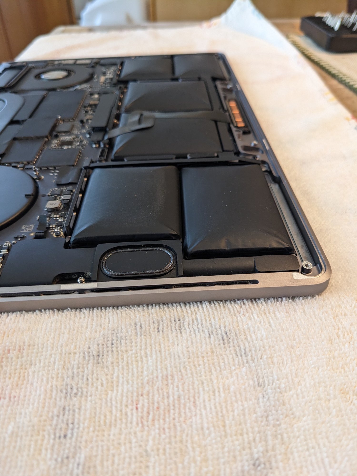

Finished replacing the battery with an iFixit replacement part.
The process is quite involved, but went smoothly.
The trackpad is working perfectly once again.
See the attached picture of the severely swollen battery packs, just before removal.

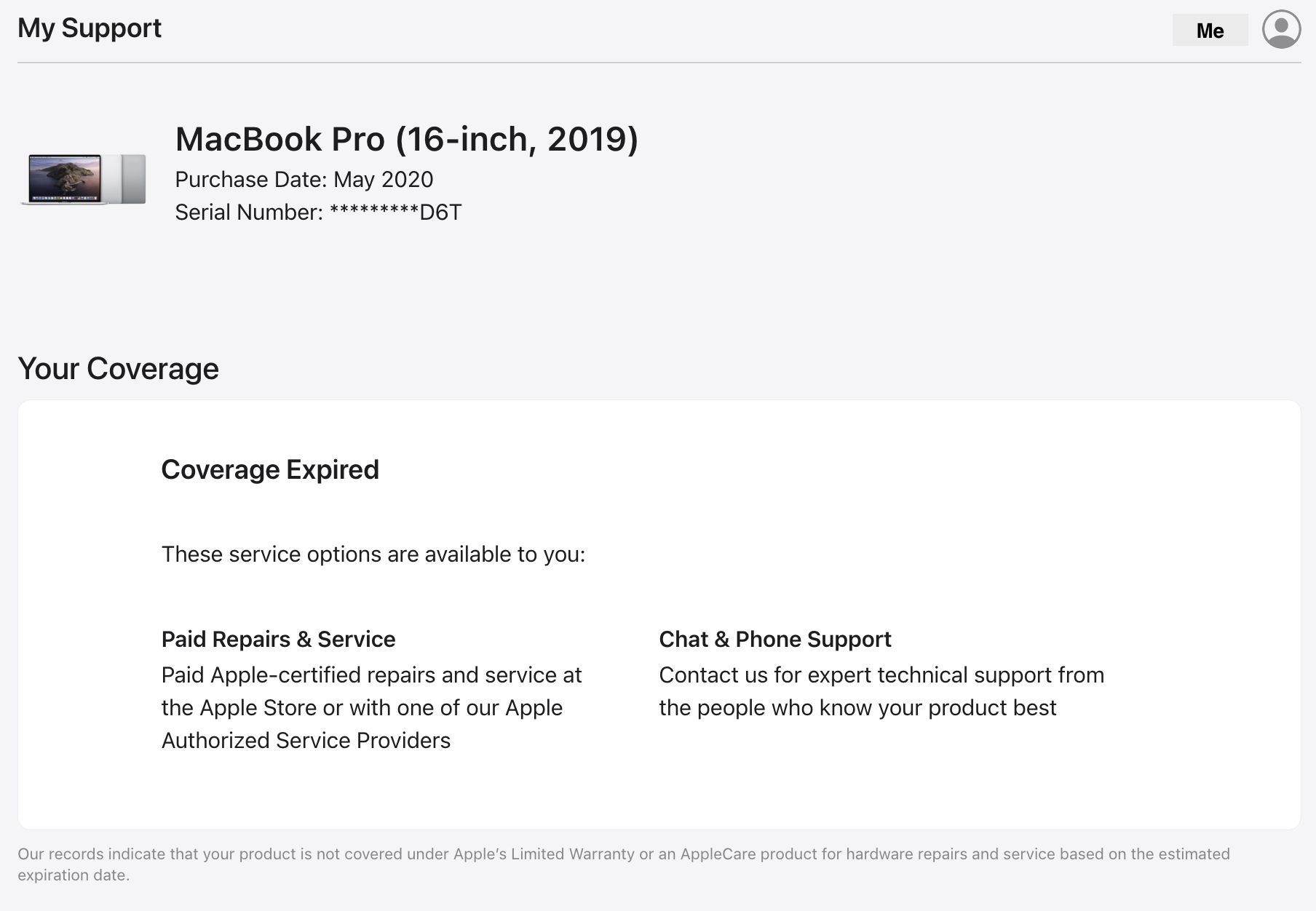

Unfortunately, coverage on this machine expired the first week of May
