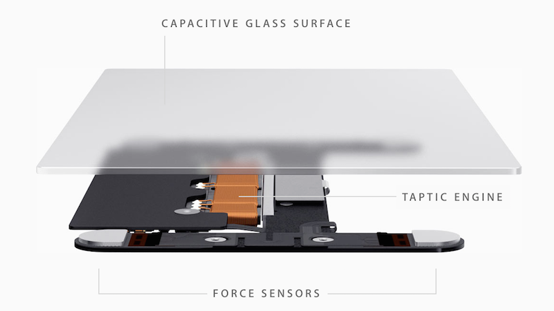

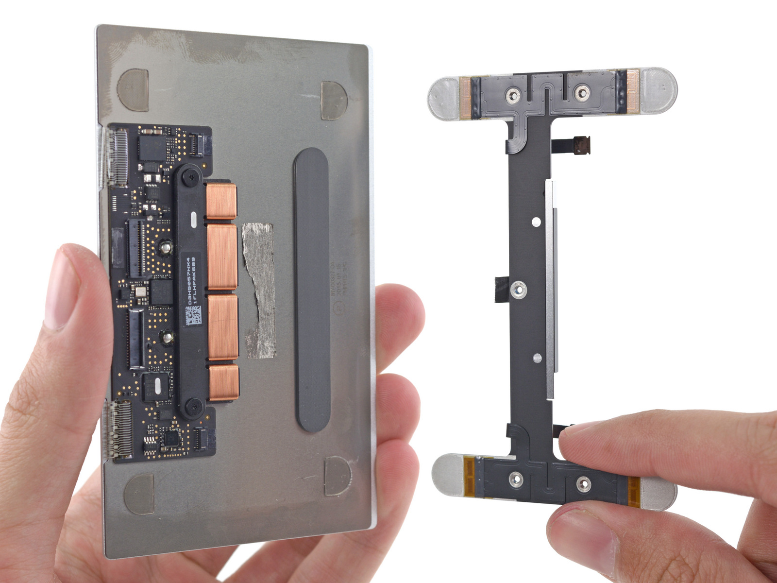

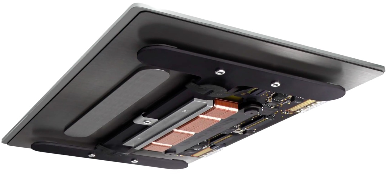

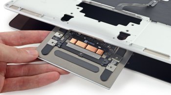

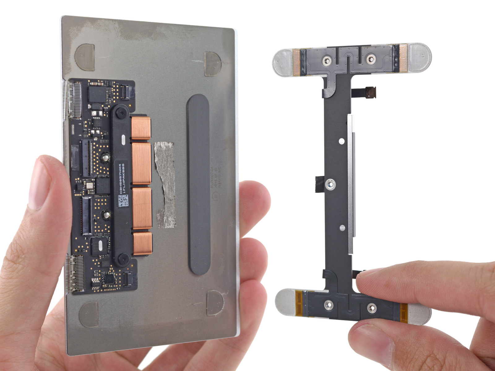

To anybody else before this turns into a defect concern or some random conspiracy.
This is an image of the structure (As well as some other reference images). The trackpad is supported in all 4 corners, with roughly 1mm height risers. Where the glass is not supported there is that 1mm gap between the glass and the shell. Therefore in the middle of the glass it will flex into a bow between these supports. The most prominent area for this is the width as this is the widest point, which will drop roughly 1mm before touching the base of the shell. You'll also notice it flex at the sides, and at the corners too.
If it flexes more than the roughly 1mm (Push hard, if you manage 10mm and break it...) this means there is somehow a lack of casing underneath the trackpad which is obviously an issue. Otherwise push on the centre at the top or bottom fairly hard and it should dip that 1mm before going any further, as it is touching the shell of the laptop.
Nobody should be in any way concerned about this. It is highly unlikely your computer would be manufactured with a huge hole in the casing. If this were the case the trackpad would likely crack/shatter quite quickly.
