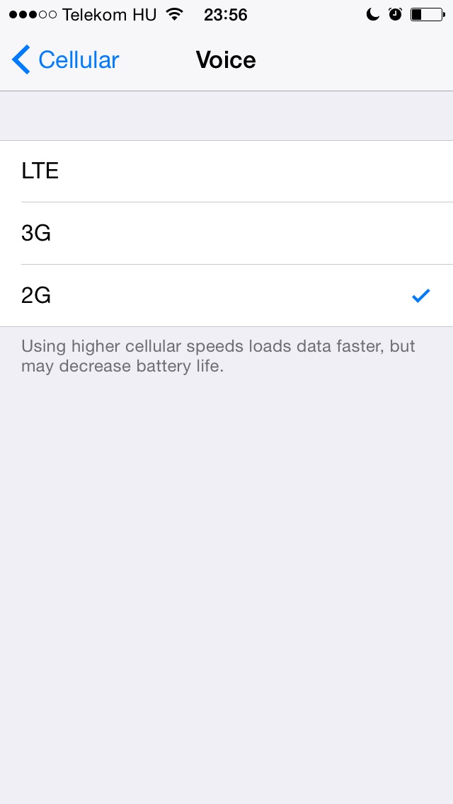

might be a carrier and country-specific thing, but iOS 8.3 betas have a switch for 2G/Edge under settings>cellular

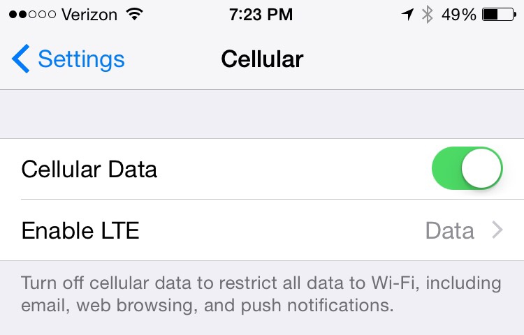

I think that the menu you are talking about is since iOS 8 (Cant remember with was with 8.1 or before), but im running 8.2 and my carrier menu looks like this
But Ill wait till it comes out (8.3) yo see if its added. Thanks!

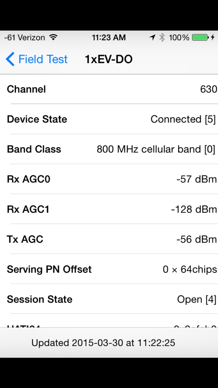

Interesting, I'm not a CDMA customer, but the tech nerd in me really wonders what is going on in this situation... I wonder if Verizon is still operating EVDO at 1900 MHz and 1x at 850 (they did for a long time, but I thought they moved to having EVDO in 850).
According to field test mode, EVDO is connecting at 850 MHz. Not sure if it's different by location.
Honestly, the relationship between signal strength and frequency is often very different from what logic suggests. For instance, I'm connected to Verizon's LTE network on band 13, which should be 700 MHz. In theory this should provide the best possible range and penetration. However, I can't even get a usable LTE signal at my house, whereas 1x/EVDO connecting at 850 MHz has a perfectly fine signal. Verizon supposedly has LTE across its entire coverage area at this point, so the signals should be broadcast from the same towers, so I don't know what's going on.
It's actually very consistent. If I'm driving somewhere where the signal is weak or nonexistent, first to go is LTE, followed by 3G/EVDO, and 1x always hangs on longer than anything.
