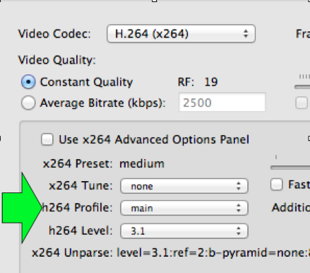

Unless it's a huge inconvenience, can someone explain the settings the arrow is pointing to in the photo(x264 Preset; x264 Tune; h264 Profile; h264 Level)?
With all due respect, this is waaaay beyond the scope of this thread imo. I guess I have no idea what you are objecting to with the atv 3 preset I wrote which provides a good balance imo. If you want to "roll your own" thats up to you. Otherwise frankly for that much info google is your friend and take your chances. Not trying to be mean, but you are asking an awful lot imo.
